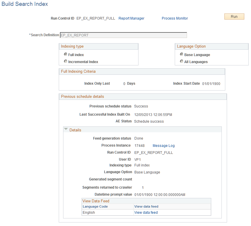

Use the Build Search Index page (PTSF_SCHEDULE_SI) to schedule and build search indexes for Expenses.
Navigation:
This example illustrates the fields and controls on the Build Search Index page.
Use this page to create and update the Search Framework search engine indexes and collections to enable Expenses searches. The system initializes the page with values based on the index name that you select. You must create run control IDs for each search definition to build a full index and another run control ID for each search definition to build incremental indexes. You should use the search definition name followed by _FULL or _INCR for each search definition.
After you initially build your search indexes using the _FULL run controls, you should keep them updated to reflect changes that are being made to expense reports using the _INCR run controls. You should set up the _INCR processes to run as frequently as needed, depending on how often changes are made to expense reports.

Run Control ID |
Displays the run control ID for either building or updating search indexes. You initially define the value for this field. |
Search Definition |
Select a search definition to build search indexes. EP_EX_REPORT is the search definition used when performing keyword searches. This value also causes the keyword search tab to appear. |

Full Indexing Criteria |
Displays the information entered on the Search Definition - Advanced page if you entered a start date. For more information, see the PeopleTools: PeopleSoft Search Technology documentation. |
For additional information about the Build Search Index page, see the PeopleTools: PeopleSoft Search Technology documentation.
