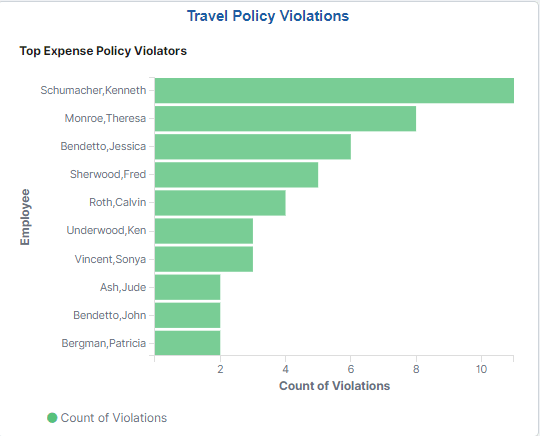

This example illustrates the Travel Policy Violations Tile.
Violation counts are based on Exception and Risk setup, such as those displayed on the Approve Expense Report - View Exception Comments and Risks Page.

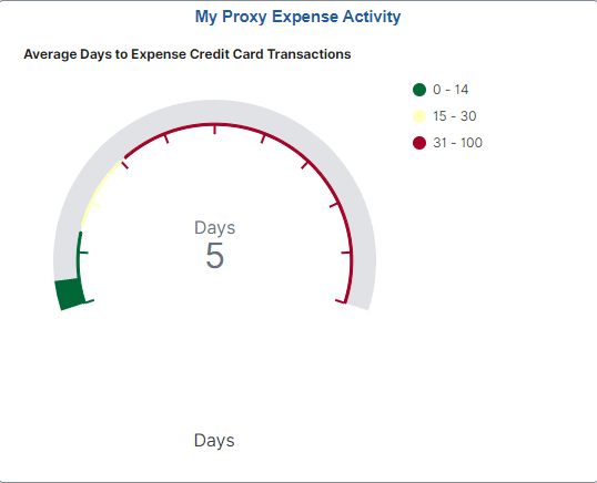

This example illustrates the My Proxy Expense Activity Tile.

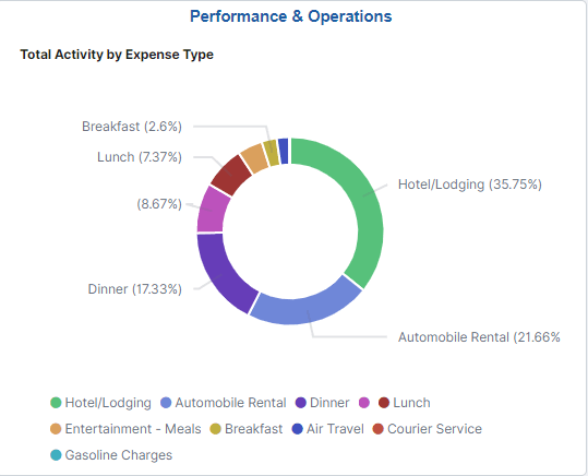

This example illustrates the Performance & Operations Tile.
