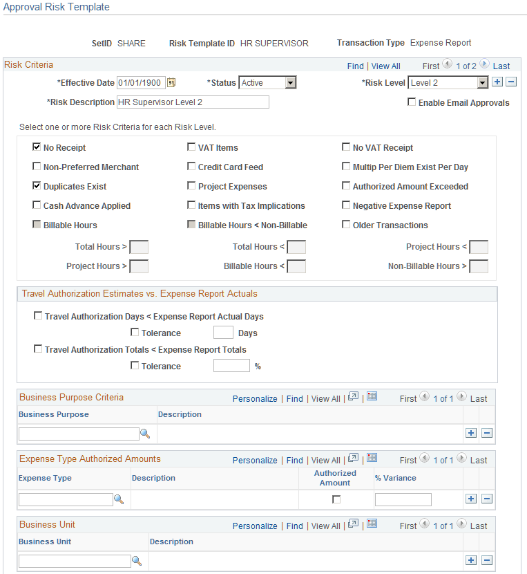

This example illustrates the fields and controls on the Approval Risk Template page (1 of 2). You can find definitions for the fields and controls later on this page.
This example illustrates the fields and controls on the Approval Risk Template page (2 of 2). You can find definitions for the fields and controls later on this page.
Use this page to define up to five levels of risk for the transaction type. Risk criteria represent exceptions to company policy that can be assigned to expense transactions. When risk criteria is defined and met for more than two levels, the highest level is shown to the approver. At least one risk criteria must be defined for each risk level. You can also enable e-mail approvals for expense transactions that contain risk.
The transaction type determines the fields that are available on the page.
Risk Criteria
Field or Control |
Description |
Risk Level |
Select the level of risk for the template. Options include Level 1 through Level 5, which indicate the severity of the risk. Level 1 indicates low risk and level 5 indicates high risk. |

Business Purpose Criteria
Field or Control |
Description |
Business Purpose |
Select the to indicate that expense reports with this business purpose are to be considered for risk. |
Expense Type Authorized Amounts
Expense Type Authorized Amounts details has an Authorized Amount check box that when selected, determines if the system checks for risk against an expense type that has a value over the amount defined in the expense location amount table. The expense location amount table is defined on the Expense Location Amount page. If the Authorized Amount check box is not selected, then the system indicates that the expense type has risk if the expense type appears in the report. There is also a % Variance option that allows a variance before the system indicates risk.
Field or Control |
Description |
Expense Type |
Select an active expense type to indicate the level of risk. |
Authorized Amount |
Select to indicate that the system checks for risk for the expense type if the value is over the amount defined in the expense location amount table. |
% Variance |
Enter a percent of variance that the system allows over the authorized amount. If the amount exceeds this variance, the system considers the report to have risk. |

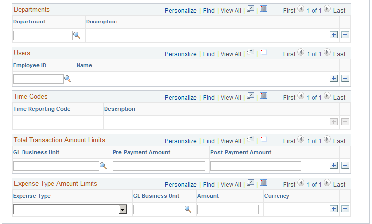

Expense Type Amount Limits
Field or Control |
Description |
Expense Type |
Select an expense type to indicate risk. |
GL Business Unit |
Select the general ledger business unit in which the expense type indicates risk. |
Amount |
Enter an amount that indicates the value of the expense type that indicates risk for the general ledger business unit. |
