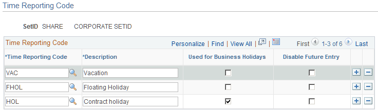

Use the Time Reporting Code page (EX_TRC_MAP_TBL) to enable and disable future entry time reporting.
Navigation:
This example illustrates the fields and controls on the Time Reporting Code (EX_TRC_MAP_TBL) page. You can find definitions for the fields and controls later on this page.
The Time Reporting Code (EX_TRC_EX and EX_TRC_MAP_TBL) pages enable you to prohibit reporting future personal time on time reports. Select the Disable Future Entry check box for a time reporting code to prohibit employees from entering personal hours on a time report if the date entered on the report is after the current date.
