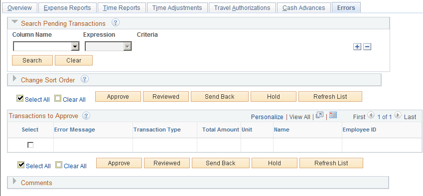

Use the Approve Transactions - Errors page (EX_ALLERROR_APPR) to view approval errors.
Navigation:
This example illustrates the fields and controls on the Approve Transactions - Errors page. You can find definitions for the fields and controls later on this page.
