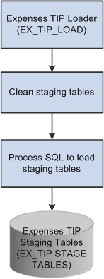

Using the Expenses Transaction in Progress (EX_TIP_LOAD) Application Engine Batch Process
The Expenses Transaction in Progress Loader application engine (EX_TIP_LOAD) enables users to run a batch process to load a large amount of transaction in progress data from PeopleSoft Expenses. Using this process decreases the amount of time it takes to load the transactions in progress from the feeder systems to the TIP staging tables and display them in the Project Costing Transaction in Progress page.
When the EX_TIP_LOAD application is run, it deletes the staging tables, inserts any new TIP exceptions, and populates the EX_TIP staging tables so that you can search for and display these PeopleSoft Expenses transactions in progress on the Transactions in Progress page in PeopleSoft Project Costing.
This diagram describes the Expenses TIP Loader process flow to the staging tables.

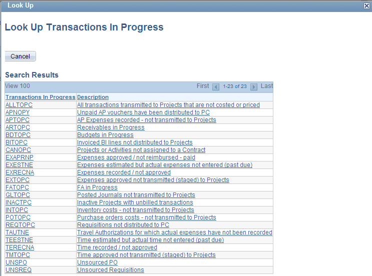

This example illustrates the fields and controls on the Look Up Transactions in Progress search page.
Choose a TIP link, click the Add button, and select the link again from the search results to go to the (Details) Page and specify your default search criteria.
Note: Although there are 23 TIP stages listed; only 6 belong to PeopleSoft Expenses. If you select a PeopleSoft Project Costing TIP stage, the Project Costing TIP inquiry page appears.

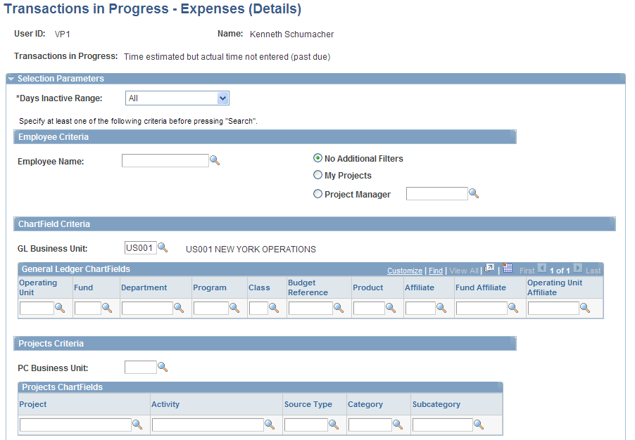

Use the Transactions in Progress - Expenses (Details) page (EX_TIP) to add transactions in progress, specify criteria, and click Search to display a list of expense and time report transactions in progress.
Navigation:
This example illustrates the fields and controls on the Transactions in Progress - Expenses (Details) page (1 of 2). You can find definitions for the fields and controls later on this page.
This example illustrates the fields and controls on the Transactions in Progress - Expenses (Details) page (2 of 2). You can find definitions for the fields and controls later on this page.
This page uses fields that are common to other pages discussed in this topic. Refer to the beginning of the topic to review descriptions of these common elements.
You must specify at least one of the following fields in order to process your search: GL Business Unit, Project Costing Business Unit, My Projects, Project Manager, or Employee Name.
Field or Control |
Description |
Days Inactive Range |
Displays the number of days since the last activity. Select 31 to 60, 61 to 90, <31, >90, or All. PeopleSoft Expenses calculates days inactive using the:

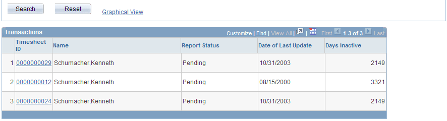

Enter the remaining search criteria to filter transactions in progress. Click the Search button for PeopleSoft Expenses to retrieve and display a list of transactions in progress. Note: PeopleSoft Expenses saves your selection criteria (by User ID and TIP stage) so you do not need to re-enter the criteria each time you access this page. |
Graphical View |
Click to see the Transactions in Progress - Expenses (Graphical) page. This link only appears if there is data in the Transactions grid. |
Report ID |
Click to drill down to the Expense Reports or Time Reports Detail page. Click the Return to TIP Inquiry Page link to return to the TIP Inquiry page. |

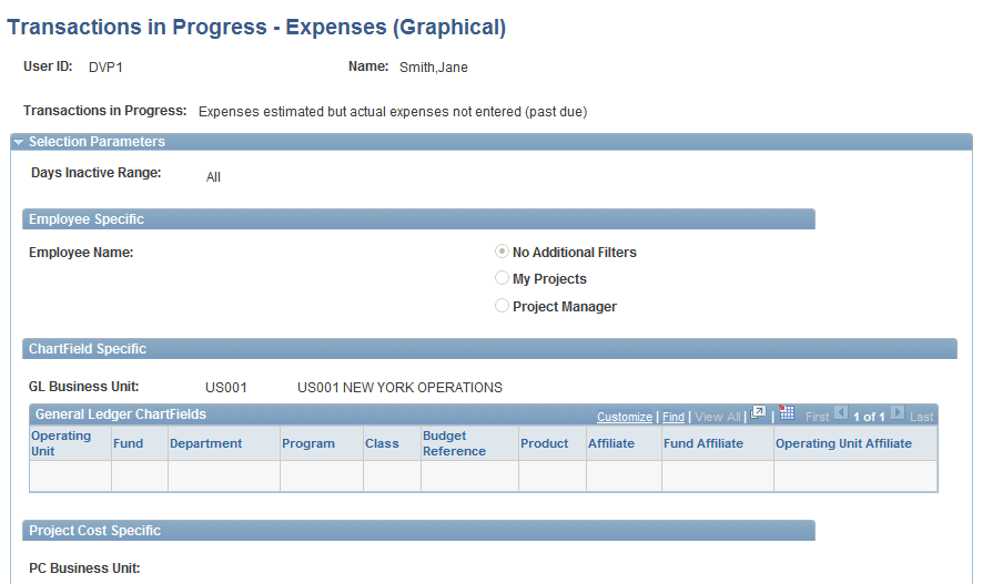

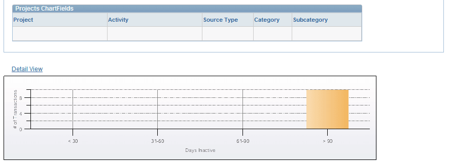

Use the Transactions in Progress - Expenses (Graphical) page (EX_TIP2) to display a graphical view of expense and time report transactions in progress.
Navigation:
This example illustrates the fields and controls on the Transactions in Progress - Expenses (Graphical) page (1 of 2). You can find definitions for the fields and controls later on this page.
This example illustrates the fields and controls on the Transactions in Progress - Expenses (Graphical) page (2 of 2). You can find definitions for the fields and controls later on this page.
Expand Selection Parameters to display the filtering options that were used to select the transactions in progress for the chart. Note that those parameters are now read-only.
Click the Detail View link to go back to the Transactions in Progress - Expenses (Details) page.

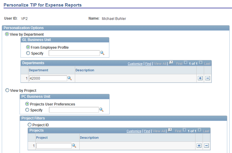

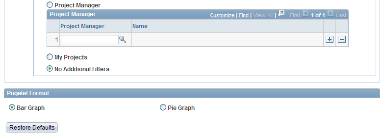

Use the Personalize TIP for Expense Reports page (EX_PE_TIP_PRS) to define default display information for TIP pagelets for expense reports.
Navigation:
Click the Customize icon on a TIP pagelet for expense reports.
To access the administrator pages, go to
This example illustrates the fields and controls on the Personalize TIP for Expense Reports page (1 of 2). You can find definitions for the fields and controls later on this page.
This example illustrates the fields and controls on the Personalize TIP for Expense Reports page (2 of 2). You can find definitions for the fields and controls later on this page.
This page automatically populates with defaults provided from the system administrator personalization page. The parameters specified on this page filter and define the default data that PeopleSoft Expenses displays on a TIP pagelet.
Field or Control |
Description |
Bar Graph |
Select to view search results as a bar graph. |
Field or Control |
Description |
Pie Graph |
Select to view search results as a pie graph. |
Note: The administrator sets the defaults for displaying TIP pagelets as a Bar Graph or a Pie Graph.
If a user personalizes a time report pagelet and changes the default selection for Bar Graph or Pie Graph, the two time report pagelets will be displayed the same way. That is, both time report pagelets can be displayed either as a bar graph or as a pie graph, not one of each.
Similarly, if a user personalizes an expense report pagelet and changes the default selection for Bar Graph or Pie Graph, the three expense report pagelets will be displayed the same way. That is, the three expense report pagelets can only be displayed either as a bar graph or as a pie graph, not one of each.

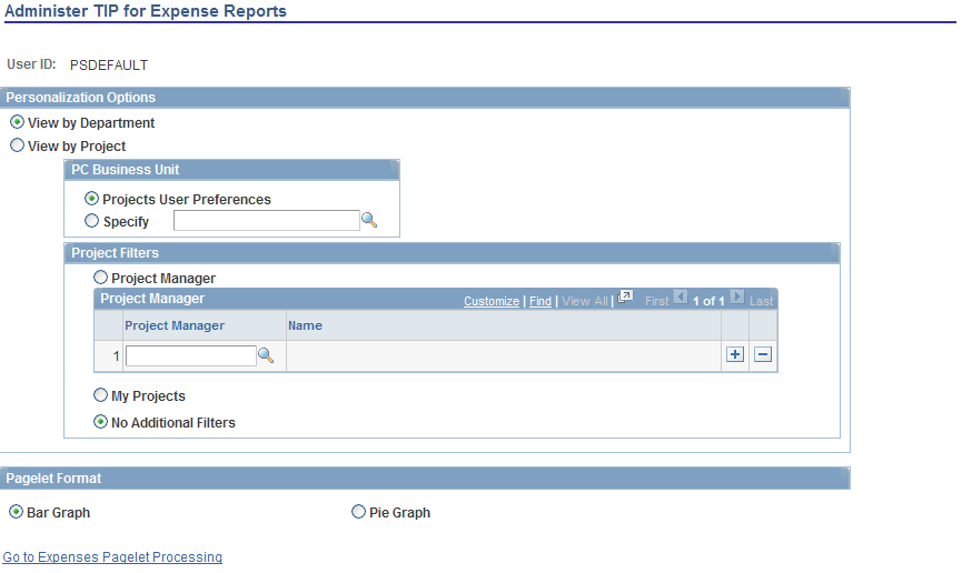

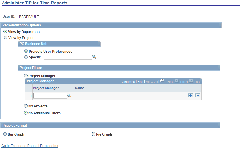

Use the Administer TIP for Expense Reports or the Administer TIP for Time Reports page to obtain data for PeopleSoft Expenses and Time pagelets .
To obtain data for PeopleSoft Expenses pagelets, an administrator must define filter criteria and then run the Expenses Pagelet Processing process. This process converts expense data to various currencies so that the Total Expense Costs Operational Threshold Alert (OTA) and Transactions in Progress pagelets can provide data in a currency that is meaningful to each user and render data more rapidly. This process is scheduled by navigating to Travel and Expenses, Real-Time Analysis, Update Expenses Pagelet Info.
The administration and processing functionality is the same for Expense Report pagelets and for Time Report pagelets.
This example illustrates the fields and controls on the Administer TIP for Expense Reports page. You can find definitions for the fields and controls later on this page.
This example illustrates the fields and controls on the Administer TIP for Time Reports page. You can find definitions for the fields and controls later on this page.
Note: In the Administer TIP for Time Reports page, users will only see the View by Project and No Additional Filters options.
