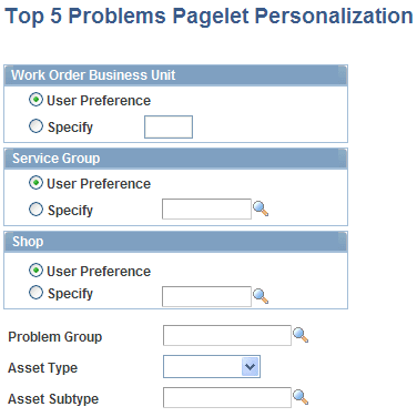

Use the Top 5 Problems Pagelet Personalization page (WM_TOP_PROB_PRS) to define default display information for the Top 5 Problem Codes pagelet.
Navigation:
Click the Customize Top 5 Problem Codes icon on the Top 5 Problem Codes pagelet.
This example illustrates the fields and controls on the Top 5 Problems Pagelet Personalization page. You can find definitions for the fields and controls later on this page.
Use the fields to filter which group of problem codes to analyze and which assets the pagelet will examine when counting the frequency of problem occurrences. You can use the default business unit that is set up in User Preferences for this user or select a different PeopleSoft Maintenance Management business unit. You can select a service group, shop, problem group, asset type and asset subtype.
