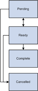

The following diagram illustrates the process flow associated with amendment processing statuses.
Manage amendment statuses according to the following process flow rules:
Amendments in Pending processing status can be set to Ready or Cancelled status.
Amendments in Ready processing status can manually be set back to Pending status or Cancelled status.
Once processed, the system updates the status to Complete.
You can manually set an amendment to Cancelled status from Pending or Ready status.
However, after the amendment has been canceled, you cannot reset the amendment to any other processing status.
