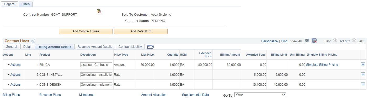

Access the Lines page: Billing Amount Details tab (click the Billing Amount Details tab on the Contract - Lines page).
This example illustrates the fields and controls on the Contract Lines page: Billing Amount Details tab. You can find definitions for the fields and controls later on this page.
View the pricing information for a contract line. The system updates these fields to reflect any changes that you make to the price detail for contract lines on the Billing Allocation page.
Field or Control |
Description |
List Price |
Displays the list price defined on the Product Price page for amount-based products. The list price appears in the contract currency. |
Quantity |
Displays the quantity for the product that you added to the contract line. For amount-based products, the system uses the quantity as a multiplier to determine the total fixed price amount for the contract line. This field is display-only. If you want to change the quantity before the contract is activated, do so on the Billing Allocation page. After contract activation, you can change the quantity through an amendment on the Amendment Billing Allocation page. |
UOM (unit of measure) |
Displays the unit of measure defined on the Product Price page for amount-based products. |
Extended Price |
Displays the list price multiplied by quantity for amount-based contract lines. |
Billing Amount |
Displays the billing amount for amount-based contract lines, allocated for this contract line, on the Billing Allocation page, and then multiplied by the quantity. This field is updated when changes are made on the Billing Allocation page. |
Awarded Total |
Displays the calculated total of the awarded costs and awarded fee amounts for the contract line. |
Unit Billing |
Displays the unit billing price for the contract line. This value is calculated as Net Billing divided by Quantity for amount based lines, Billing Limit divided by Quantity for rate based lines, and Recurring Billing divided by Quantity for recurring contract lines. |
Simulate Billing Pricing |
Click to open the Pricing Simulator page where relevant contract and product details used to determine the current product price for billing are displayed. Prices are based on product pricing configuration maintained in Order Management and the Enterprise Pricer and contract specific attributes that may be used as criteria for determining price. Contract line start date is used as the effective date for calculating prices. If contract line Start Date is not available then contract Sign Date is used. For more information on the Pricing Simulator see Understanding the Pricing Simulator. Note: The Enterprise Pricer Transaction Code used to identify prices for billing is ‘CA’ (Contracts). See Price Transaction Code Page |

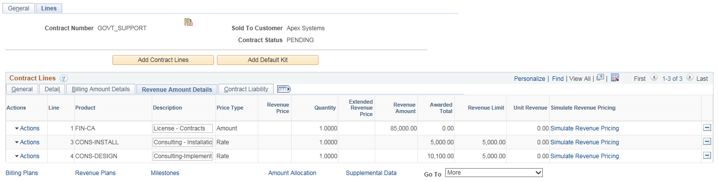

Access the Lines page: Revenue Amount Details tab (click the Revenue Amount Details tab on the Contract - Lines page).
This example illustrates the fields and controls on the Contract Lines page: Revenue Amount Details tab. You can find definitions for the fields and controls later on this page.
View the pricing information for a contract line. The system updates these fields to reflect any changes that you make to the price detail for contract lines on the Revenue Allocation page.
Field or Control |
Description |
Revenue Price |
Displays the product’s revenue price as calculated in Order Management and the Enterprise Pricer. Note that the Enterprise Pricer uses prices identified to transaction code RP for revenue pricing whereas prices identified to transaction code CA (contracts) are used for billing pricing. This applies to contracts identified as having separated billing and revenue. If the contract does not separate billing and revenue then the revenue price will be same as the list price. Revenue Price is not applicable for percent based lines and recurring contract lines. See Price Transaction Code Page |
Quantity |
Displays the quantity for the product that you added to the contract line. |
Extended Revenue Price |
Displays the revenue price multiplied by quantity for amount-based contract lines. |
Revenue Amount |
Displays the revenue amount entered on the Revenue Allocation page. Applies to amount and percent based contract lines only. |
Awarded Total |
Revenue Limit |
Displays the revenue limit entered on the Revenue Allocation page. Only contract lines with a price type of Rate have limits. On initial adding of the contract line, the revenue price is used as the default revenue limit multiplied by the quantity. It is then updated based on changes made on the Revenue Allocation page. If the system generated suggested amount is greater than the revenue limit, then an error message is displayed and the revenue limit has to be manually overridden. |
Unit Revenue |
Displays the unit revenue price for the contract line. This value is calculated as Net Revenue divided by Quantity for amount and percent based lines, Revenue Limit divided by Quantity for rate based lines, and Recurring Revenue divided by Quantity for recurring contract lines. |
Simulate Revenue Pricing |
Click to open the Pricing Simulator page where relevant contract and product details used to determine the current product price for revenue are displayed. Prices are based on product pricing configuration maintained in Order Management and the Enterprise Pricer and contract specific attributes that may be used as criteria for determining price. For more information on the Pricing Simulator see Understanding the Pricing Simulator. |
Note: The Revenue Amount Details will be same as the Billing Amount Details if both the Separate Fixed Billing and Revenue check box and the Separate As Incurred Billing and Revenue check box are not selected while creating a contract.

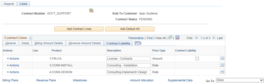

Access the Lines page: Contract Liability tab (click the Contract Liability tab on the Contract - Lines page).
This example illustrates the fields and controls on the Contract Lines page: Contract Liability tab. You can find definitions for the fields and controls later on this page.
Generating accounting entries for contract liability enables you to post revenue that you expect to realize in a future accounting period for amount-based contact lines to the general ledger. If the contract is in Pending status, you can enable contract liability by selecting this check box. If the contract is in Active status, you cannot change this setting unless you are in amendment mode.
Field or Control |
Description |
Contract Liability |
Select to enable contract liability processing at the contract line level for amount-based contract lines. The contract liability option can also be set up on the Product Group Options page, so that it appears on this page when the product associated with that product group is added to the contract. Note: If you choose to set up the contract liability option at the Contracts Product Group Options level, you will not be able to override the contract liability setting at the contract line level unless you have also selected the Contract Liability Override option at the PeopleSoft Contracts business unit level. |
Contract Liability Status |
Displays the status of the contract liability processing for this contract line. This field only appears when the Contract Liability check box is selected. |
Contract Liability Acctg Date |
Select the contract liability accounting date for the amount-based contract line. The Contract Liability process does not process any contract line until you specify the contract liability accounting date. In addition, if contract liability is enabled, any related amount-based revenue processes do not process until the contract liability process is run. This field only appears when the Contract Liability check box is selected. |
