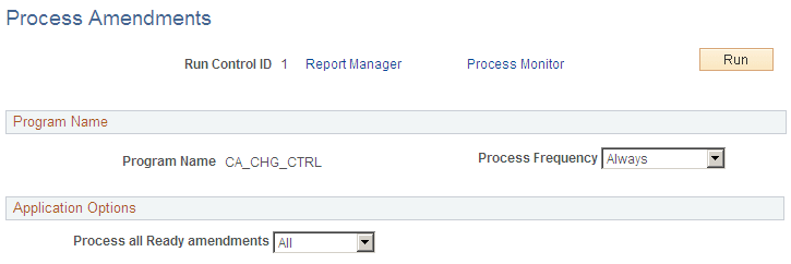

Use the Process Amendments page (RUN_CA_CHG) to process amendments with a status of Ready using batch processing.
Navigation:
This example illustrates the fields and controls on the Processing Amendments page. You can find definitions for the fields and controls later on this page.
Field or Control |
Description |
Process all Ready amendments |
Select the range of amendments for which this process will run. Values are:
