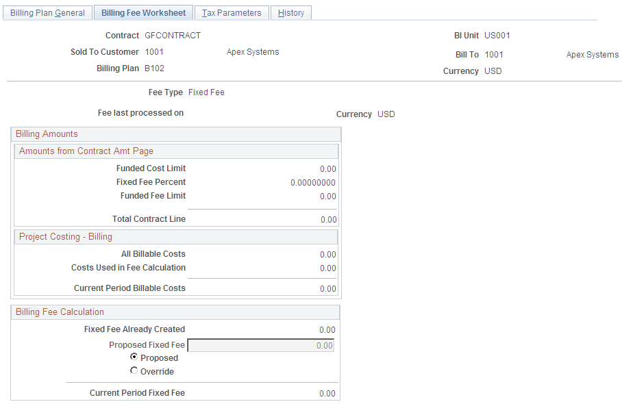

Use the Billing Plan - Billing Fee Worksheet page (CA_BP_FEE_WS) to evaluate, manage, and generate billing fee amounts for cost-plus contract lines.
Navigation:
Click the Billing Plans link. Click the link for the billing plan ID, Billing Fee Worksheet.
This example illustrates the fields and controls on the Billing Plan – Billing Fee Worksheet page (1 of 2) (fixed fee type). You can find definitions for the fields and controls later on this page.
This example illustrates the fields and controls on the Billing Plan – Billing Fee Worksheet page (2 of 2) (fixed fee type). You can find definitions for the fields and controls later on this page.
When you define a billing plan for a cost-plus contract line associated with a fee type of Fixed, the system automatically creates a billing plan with a billing fee worksheet containing fields that are specific to fixed fee processing.
Billing Amounts - Amounts from Contract Amt Page
Field or Control |
Description |
Fixed Fee Percent |
Displays the fixed fee percentage defined on the Contract Amounts page for the contract line. The fixed fee percent is multiplied by the total funded costs to determine the total funded fee amount. |
Billing Fee Calculation
Field or Control |
Description |
Fixed Fee Already Created |
Displays the total to date for all billable fixed fee rows already created for the contract line. For this value, the system retrieves the fixed fee billing rows that are assigned the analysis type specified in the Billing Target Fee Attributes group box on the Fee Definition page for this fee type. The fee definition is defined on the Contracts Business Unit component (BUS_UNIT_TBL_CA). |
Proposed Fixed Fee |
Displays the calculated total of all billable cost rows to date for the contract line for which fees have not been created, multiplied by the fixed fee percentage. You can override this value if needed. |
Current Period Fixed Fee |
Displays the billing fixed fee total for the current period after the fee limits process has run. |

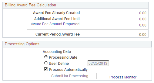

Access the Billing Plan – Billing Fee Worksheet for award fees.
This example illustrates the fields and controls on the Billing Plan – Billing Fee Worksheet page (1 of 2) (award fee type). You can find definitions for the fields and controls later on this page.
When you define a billing plan for a cost-plus contract line associated with a fee type of Award, the system automatically creates a billing plan with a billing fee worksheet containing fields that are specific to award fee processing.
Field or Control |
Description |
Base Fee Percent |
Displays the base fee percentage defined on the Contract Amounts page for the contract line. The billing base fee percent is multiplied by the total funded costs to determine the total funded fee amount. |
Billing Base Fee Calculation
Field or Control |
Description |
Base Fee Already Created |
Displays the total to date for all billable base fee rows already created for the contract line. For this value, the system retrieves the award fee billing rows that are assigned the analysis type specified in the Billing Target Fee Attributes group box on the Fee Definition page for this fee type. The fee definition is defined on the Contracts Business Unit component (BUS_UNIT_TBL_CA). |
Proposed Base Fee |
Displays the calculated total of all billable cost rows to date for the contract line for which fees have not been created, multiplied by the base fee percentage. You can override this value if needed. |
Current Period Base Fee |
Displays the billing base fee total for the current period after the fee limits process has run. |
Billing Award Fee Calculation
Field or Control |
Description |
Award Fee Already Created |
Displays the total to date for all billable award fee rows already created for the contract line. For this value, the system retrieves the award fee billing rows that are assigned the analysis type specified in the Billing Target Fee Attributes group box on the Fee Definition page for this fee type. The fee definition is defined on the Contracts Business Unit component (BUS_UNIT_TBL_CA). |
Additional Award Fee Limit |
Displays the additional award fee limit percentage entered on the Contract Amounts page for the contract line. |
Award Fee Amount Proposed |
Displays the calculated total of all billable cost rows to date for the contract line for which fees have not been created, multiplied by the award fee percentage. You can override this value if needed. |
Current Period Award Fee |
Displays the billing award fee total for the current period after the fee limits process has run. |

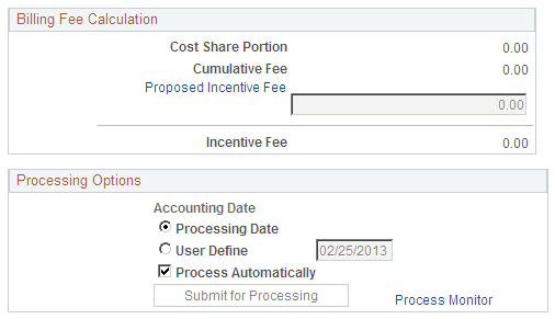

Access the Billing Plan - Billing Fee Worksheet for incentive fees.
This example illustrates the fields and controls on the Billing Plan – Billing Fee Worksheet page (1 of 2) (incentive fee type). You can find definitions for the fields and controls later on this page.
This example illustrates the fields and controls on the Billing Plan – Billing Fee Worksheet page (2 of 2) (incentive fee type). You can find definitions for the fields and controls later on this page.
When you define a billing plan for a cost-plus contract line associated with a fee type of Incentive, the system automatically creates a billing plan with a billing fee worksheet containing fields that are specific to incentive fee processing.
Field or Control |
Description |
Cost Share Overrun |
Displays the cost share overrun percentage entered on the Contract Amounts page for the contract line. Then system uses the cost share overrun percentage to adjust the target fee percentage that can be billed. |
Cost Share Underrun |
Displays the cost share underrun percentage entered on the Contract Amounts page for the contract line. The system uses the cost share underrun percentage to adjust the target fee percentage that can be billed. |
Target Fee Percent |
Displays the target fee percentage entered on the Contract Amounts page for the contract line. The system uses the target fee percentage to calculate the target fee amount. |
Target Fee Amount |
Displays the calculated total of the funded cost limit multiplied by the target fee percentage. |
Minimum Fee Percent |
Displays the minimum fee percentage entered on the Contract Amounts page for the contract line. This percentage represents the minimum fee percentage that can be billed for the contract line. |
Minimum Fee Amount |
Displays the calculated total of the funded cost limit multiplied by the minimum fee percentage. |
Maximum Fee Percent |
Displays the maximum fee percentage entered on the Contract Amounts page for the contract line. This percentage represents the maximum fee percentage that can be billed for the contract line. |
Maximum Fee Amount |
Displays the calculated total of the funded cost limit multiplied by the maximum fee percentage. |
Total Maximum Cont Line Value (total maximum contract line value) |
Displays the calculated total of the funded cost limit plus the maximum fee amount. |
Project Costing - Billing
Field or Control |
Description |
Difference |
Displays the calculated total of the funded cost limit minus all available billable costs to date for the contract line. |
Field or Control |
Description |
Cost Share Portion |
Displays the calculated total of the difference amount between the funded cost limit and all available billing cost rows for the contract line multiplied by the cost share percentage to be used. The cost share percentage used is either the underrun or overrun cost share percentage depending on whether the total inception to date billable costs are less than or greater than the funded cost limit amount respectively. |
Cumulative Fee |
Displays the calculated total of the cost share portion amount plus the target fee amount. |
Proposed Incentive Fee |
Displays the proposed incentive fee for the contract line. If the actual billable costs to date are less then or equal to the funded cost limit, the system uses the lessor of the cumulative fee amount or the maximum fee amount for the proposed incentive fee. If the actual billable costs to date are greater then the funded costs limit, then the system uses the greater of the cumulative fee amount or the minimum fee amount for the proposed incentive fee. This amount can be overwritten if needed, but must be within the minimum and maximum fee ranges defined for the contract line. |
Incentive Fee |
Displays the billing incentive fee total for the current period after the fee limits process has run. |

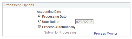

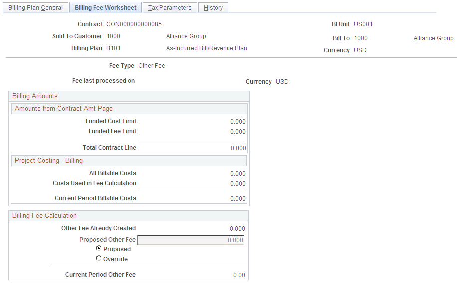

Access the Billing Plan – Billing Fee Worksheet for other fees.
This example illustrates the fields and controls on the Billing Plan - Billing Fee Worksheet page (1 of 2) (other fee type). You can find definitions for the fields and controls later on this page.
This example illustrates the fields and controls on the Billing Plan - Billing Fee Worksheet page (2 of 2) (other fee type). You can find definitions for the fields and controls later on this page.
When you define a billing plan for a cost-plus contract line associated with a fee type of Other, the system automatically creates a billing plan with a billing fee worksheet containing fields that are specific to other fee processing.
Field or Control |
Description |
Other Fee Already Created |
Displays the total to date for all billable other fee rows already created for the contract line. For this value, the system retrieves the other fee billing rows that are assigned the analysis type specified in the Billing Target Fee Attributes group box on the Fee Definition page for this fee type. The fee definition is defined on the Contracts Business Unit component (BUS_UNIT_TBL_CA). |
Proposed Other Fee |
Displays the other fee amount entered on the Contract Amounts page for the contract line. This amount can be overwritten if needed. |
Current Period Other Fee |
Displays the billing other fee total for the current period after the fee limits process has run. |

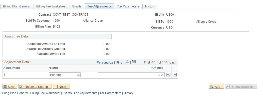

Use the Billing Plan – Fee Adjustments page (CA_BP_FEE_ADJ) to enter fee adjustment amounts when fee amounts, percentages, or limits have changed over the life of the contract.
Navigation:
Click the Award Fee Amount Proposed or Proposed Incentive Fee link on the Billing Fee Worksheet page. Click the Adjustment Fee link on the Events page.
This example illustrates the fields and controls on the Billing Plan – Fee Adjustments page (award fee type). You can find definitions for the fields and controls later on this page.
The Fee Adjustments page enables you to adjust fee amounts that have been processed. You can enter either a negative or positive amount, up to the fee amount that has been billed to date. Billing fees that have not yet been processed are adjusted using the billing fee worksheet, Proposed Amount field. Adjustments to award fees are not controlled by amendment processing.
Award Fee Details
Field or Control |
Description |
Displays the additional award fee limit amount defined on the Contract Amounts page for the contract line assigned to this billing plan. |
Displays the total for the additional award fee billing rows created to date for the contract line assigned to this billing plan. This data is retrieved for the Project Costing Project Transaction table. |
Available Award Fee |
Displays the calculated total of the additional award fee limit less the award fee amount already created. |
Adjustment Detail
Field or Control |
Description |
Adjustment |
Displays the sequence number automatically assigned to the adjustment row. |
Event Status |
Select the status of the event. The event status controls the timing of when the event can be processed. Select from the following statuses:
Amount |
Enter a positive or negative fee adjustment amount. The amount that you enter cannot be greater or less than the fee amount that has been billed to date and cannot exceed the fee limit amount. |

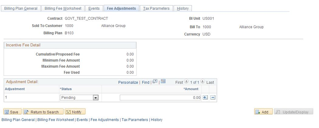

Access the Billing Plan – Fee Adjustments page for incentive fees.
This example illustrates the fields and controls on the Billing Plan – Fee Adjustments page (incentive fee type). You can find definitions for the fields and controls later on this page.
The Fee Adjustments page enables you to adjust fee amounts that have been processed. You can enter either a negative or positive amount, up to the fee amount that has been billed to date. Billing fees that have not yet been processed are adjusted using the billing fee worksheet, Proposed Amount field. Adjustments to incentive fees are not controlled by amendment processing.
Incentive Fee Detail
Field or Control |
Description |
Cumulative/ Proposed Fee |
Displays the cumulative or proposed fee amount from the incentive fee worksheet. |
Displays the calculated minimum fee amount from the incentive fee worksheet. |
Displays the calculated maximum fee amount from the incentive fee worksheet. |
Fee Used |
Displays the minimum, maximum or cumulative fee amount used by the system for incentive fee billing. |
Adjustment Detail
Field or Control |
Description |
Adjustment |
Displays the sequence number automatically assigned the adjustment row. |
Event Status |
Amount |
Enter a positive or negative fee adjustment amount. The amount that you enter cannot be greater or less than the fee amount that has been billed to date and cannot exceed the fee minimum and maximum amounts. |
