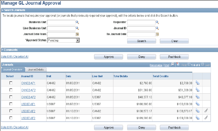

Use the Manage GL Journal Approval page (JOURNAL_APPROVAL_M) to approve, deny, or pushback multiple journals at once.
Navigation:
This example illustrates the fields and controls on the Manage GL Journal Approval page. You can find definitions for the fields and controls later on this page.
Supply the desired criteria and click the Search button. This action returns only those journals for which the current user is one of the approvers and that have not yet been posted or unposted. Click the Clear button to clear the search criteria.

Expand the Comments group box to add a common comment for the selected journals. Enter a common comment for the selected journals at once and click the Add Comments button when finished entering. If you select only one journal, the comment applies only to that journal when you click the Add Comments button. If you enter comments before clicking any of the three action buttons, the comments will be saved to those journals’ approval process.
Journal Overview
Field or Control |
Description |
Select All / Deselect All |
Select all or deselect all journals by clicking the Select All / Deselect All link. Click once to select all and click again to deselect all (toggle link). |
Select |
Click to select one or several journals for which to apply the actions of Approve, Deny, Pushback, or Add Comments. |
Journal ID |
Click this link to access the individual GL Journal Approval page. |
Unit |
Displays the anchor business unit of the journal entry. |
Line Unit |
Displays the line business unit of the journal entry. This unit can be different from the anchor business unit for interunit journals. An entry does not appear for a line unit for which an approver does not have access. |
Click the View Approval Flow icon, which opens up a modal page (GL_APPR_MONITOR). |
Attachment |
Select to view attachments (if present) for the journal. This opens a modal window displaying the JRNL_APPR2_ATT_SEC page. The page is display-only. To add additional attachments, you must access the individual GL Journal Approval page. |
See Article ID 1329609.1 on My Oracle Support website for more details.

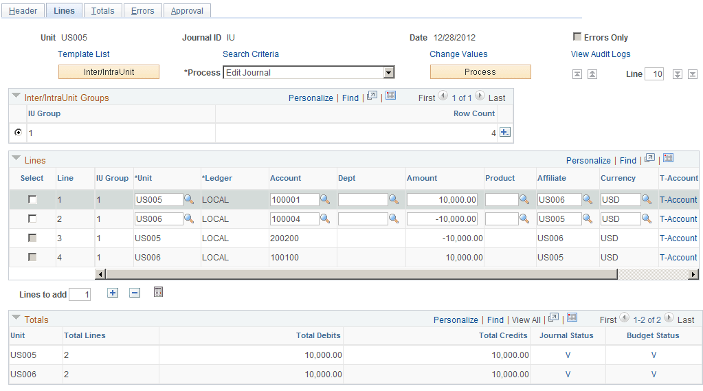

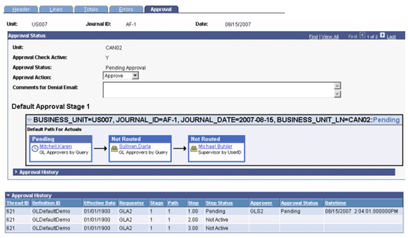

The following examples show an interunit journal as it progresses thorough the approval process involving two business units, US007 and CAN02, with the approvals required by each business unit. The examples assume prior workflow setup, which will require the journal to be submitted for approvals. Such journals, which have not yet been approved, cannot be posted.
Access the Journal Entry - Lines page (General Ledger, Journals, Journal Entry, Create/Update Journal Entries, Lines).
This example illustrates the fields and controls on the Journal Entry - Lines page (interunit example).
The preceding example shows the journal involving business units US007 and CAN02, which are subject to different approval rules.

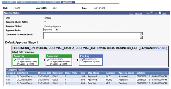

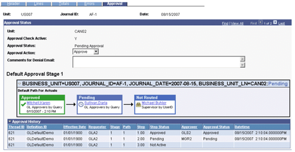

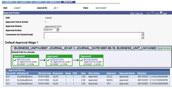

The following examples show the sequence of approvals for the interunit journal and the two business units. Access the Journal Entry - Approval page (General Ledger, Journals, Journal Entry, Create/Update Journal Entries, Approval)
This example illustrates the fields and controls on the Approval status and history for business unit CAN02 pending any approvals. You can find definitions for the fields and controls later on this page.
This example illustrates the fields and controls on the Approval status and history for business unit CAN02 after initial approval GLS2. You can find definitions for the fields and controls later on this page.
This example illustrates the fields and controls on the Approval status and history for business unit CAN02 after second approval by MGR2. You can find definitions for the fields and controls later on this page.
This example illustrates the fields and controls on the Approval status and history for business unit CAN02 after final approval VP2. You can find definitions for the fields and controls later on this page.

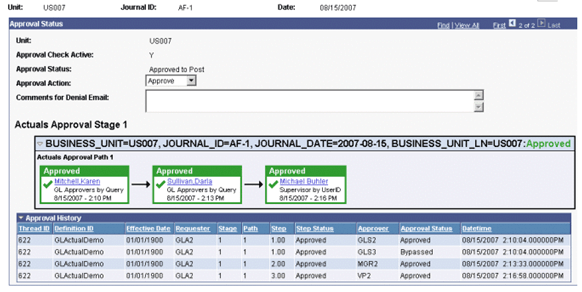

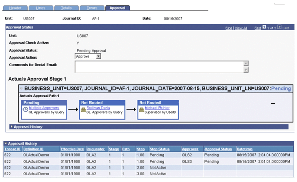

Business unit US007 had a similar approval history, but it bypasses an optional alternate additional approver (GLS3) in the business units US007 approval path. Because both GLS2 and GLS3 are granted the ability to approve the journal, however, the approval rule is set to require only one approver for this step (so that whoever approves the journal first stamped while other approvers bypassed).
This example illustrates the fields and controls on the Approval status and history for business unit US007 pending approvals. You can find definitions for the fields and controls later on this page.
This example illustrates the fields and controls on the Approval status and history for business unit US007 showing the bypass for GLS3 and final approval by VP2. You can find definitions for the fields and controls later on this page.
Approval Status
The Approval Check Active field indicates, by displaying the value Y, that an approval workflow process is required for the business unit in the journal. If no approval workflow is required for the business unit in the journal, the value displayed is N and no steps or history are displayed.
If approval check is active and displaying Y, the current approval status for the journal is shown by these values:
Field or Control |
Description |
Denied |
Journal approval is denied. |
Pending Approval |
Journal is waiting for approval. |
Approved to Post |
Journal is approved. When part of an interunit journal (a business unit) reaches the Approved to Post status, all the worklist items related to that part are marked worked. |
None |
Not applicable. |
In the Approval Action list box, the current approver selects the appropriate action for this journal:
Field or Control |
Description |
Approve |
Journal is approved for posting. If you have the authority to approve the journal, the system saves it as usual. If you don't have the authority, nothing happens to the journal. |
Deny |
Journal is not approved for posting. If you change the action to deny, the system sends an email (when email notification is set up) to the previous user with a list of the journal identifiers. |
Pushback |
Journal is sent back to the previous step. The system sends an email (when email notification is set up) to the previous user with a list of the journal identifiers. |
Approval History
The Approval History grid lists the step and path, with the status and applicable date-time stamp and user ID for the various activities in the approval process. Approval history is retained even for those journals that are resubmitted for approval after any modification.
