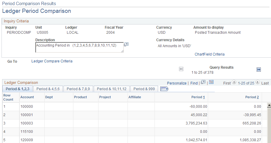

Use the Ledger Period Comparison - Period Comparison Results page ( INQ_LED_CMP_DTL) to display a comparison of the selected ledger's detail based on the ChartFields and number of periods selected on the Ledger Period Comparison page.
Navigation:
Click Search on the Ledger Period Comparison page after selecting desired criteria.
This example illustrates the fields and controls on the Ledger Period Comparison - Period Comparison Results page. You can find definitions for the fields and controls later on this page.
Field or Control |
Description |
Period Bal Fwd (period balance forward) |
If you selected the Include Balance Forward option, this column appears on the first tab and displays the opening balance for the period in the Ledger Comparison grid. |
Period Close |
If you selected the Include Closing Adjustments option, this column for period 999 appears on the last tab. It displays the adjustment for year end closing in the Ledger Comparison grid. |
ChartField Criteria |
Click to display the list of ChartFields. Deselect or select a ChartField check box and when you click the Refresh button, the Ledger Period Comparison - Period Comparison Results page redisplays ChartFields based on your selections. |
Ledger Compare Criteria |
Click to display the Ledger Criteria as well as ChartField Criteria. You can modify your selections and click Search to display results based on the newly-selected criteria. |
