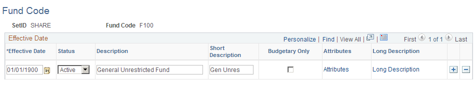

FUND_DEFINITION |
Access the Fund Code ChartField that you want to associate with selected FUND_CODE ChartField attributes. |

CF_ATTRIB_VALUES |
Select ChartField attributes and attribute values to associate with the selected Fund Code, Account value, Budget Reference, or other ChartField value. |

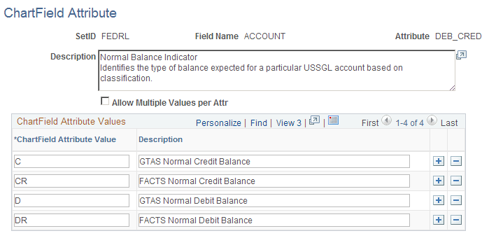

Use the ChartField Attribute page (CF_ATTRIBUTES) to add or modify the ChartField attributes and attribute values as required by the U.S. Treasury.
Navigation:
This example illustrates the fields and controls on the ChartField Attribute page.
Field or Control |
Description |
Field Name |
Select the ChartField to which the attribute should be assigned. |
Attribute |
Enter a meaningful name for the attribute. |
Description |
Enter a description of the attribute. You can also add a detailed description of the purpose of this attribute. |
Allow Multiple Values per Attr (allow multiple values per attribute) |
Select if multiple values for the attribute are allowed for a unique ChartField value. (This is deselected for most of the attributes). |
ChartField Attribute Value |
Enter the domain values for the attribute as defined by Treasury. |
Description |
Enter a description of the domain values. |

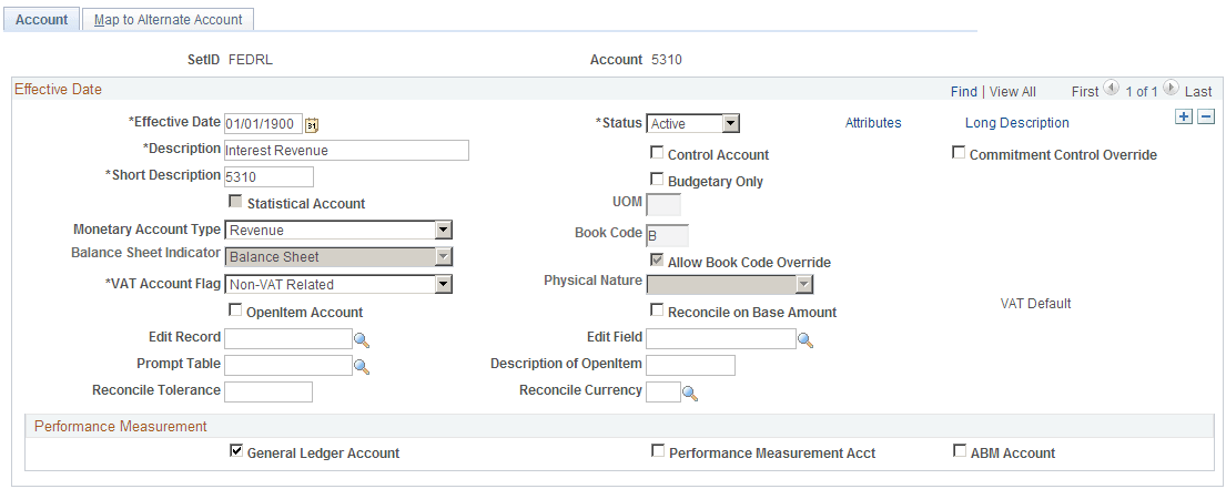

Use the Account page (GL_ACCOUNT) to set up or modify accounts to use as required by the U. S. Treasury. You can access a complete listing of the accounts required for GTAS reporting along with their required attributes as defined by Treasury on the Treasury’s website.
PeopleSoft provides a translation account tree to enable agencies to record transactions using their agency GL accounts and report to GTAS using 6-digit GTAS USSGL accounts. Attributes are required for the accounts that are included in this tree for translation.
See Using Trees to Control Rollup of GTAS ChartField Data and Creating the GTAS Account Rollup Tree.
Navigation:
This example illustrates the fields and controls on the Account page. You can find definitions for the fields and controls later on this page.
Field or Control |
Description |
Attributes |
Click this link to associate the ChartField attributes that you set up for GTAS with the appropriate Account value (or Fund Code ChartField value on the Fund Code page or Budget Reference ChartField value on the Budget Reference page) that is required for GTAS reporting. |
See Adding and Mapping Accounts and Alternate Accounts.

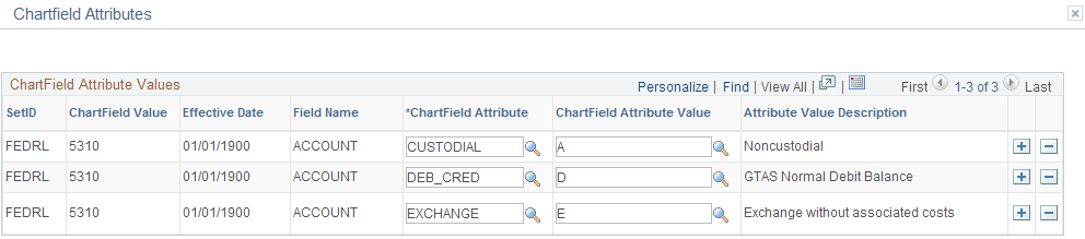

Use the ChartField Attributes page (CF_ATTRIB_VALUES) to select ChartField attributes and attribute values to associate with the selected Fund Code, Account value, Budget Reference, or other ChartField value.
Navigation:
From the Account page (or other ChartField entry page), click the Attributes link.
This example illustrates the fields and controls on the ChartField Attributes page.
After clicking the Attributes link from the Account page, you are directed to the ChartField Attributes page for this ChartField value (Account 5310 in this example). You can click the Attributes link from any ChartField value page (Fund Code, for example) and associate Attributes and Attribute values to the ChartField value.
Field or Control |
Description |
ChartField Attribute |
Select the appropriate ChartField attribute(s) for this ChartField Value. |
Select the ChartField attribute domain value to be associated with the ChartField. This value is the default and can be overridden by values on the GTAS Attribute Exceptions page. |
Note: If the attribute has values on the GTAS Attribute Exceptions page, the value specified on the ChartField Assignment page is a default and will be overridden for ChartField combinations that are specified on the Attribute Exceptions page.
Use the Fund Code page (FUND_DEFINITION) to define values for all types of funds. Associate the Funds Codes with selected ChartField attributes.
Navigation:
This example illustrates the fields and controls on the Fund Code page.
Add the necessary Fund Codes. Click the Attributes link to associate attributes and values with the Fund Code.
You can also use the FUND_CF component interface to load data into the tables for the Fund Code component
See Fund Code Page
