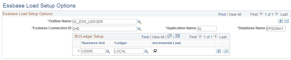

PeopleSoft delivers the Essbase Load Setup Options component to register the GL Essbase setup that stores the relationships between PeopleTools Cube Builder and General Ledger when loading data. Only one measure is supported by PeopleTools Cube Builder; therefore, cube outlines may be defined for the base amount measure and another cube outline for foreign amounts, if needed.
Use the Essbase Load Setup Options page (GL_ESSBASE_SETUP) to register the GL Essbase setup that stores the relationships between PeopleTools Cube Builder and General Ledger when loading data. Specify the Outline Name, Essbase Connection ID, and other parameters of the Essbase cube for subsequent or incremental loading of cube data.
Navigation:
This example illustrates the fields and controls on the Essbase Load Setup Options page.
Field or Control |
Description |
Outline Name |
Select the Essbase Cube Outline ID that you want to use for the data load. The outline defines the basic structure of the cube, including dimensions and data queries. |
Essbase Connection ID |
Select the Connection ID that you have established. |
Application Name |
Essbase application name where cube resides. |
Database Name |
Essbase database name to be used where cube resides. |
BU Ledger Setup
Field or Control |
Description |
Incremental Load |
Select this check box to load data incrementally. Deselect the check box for period load. Note: For the incremental load, queries must be based upon the GL_ESS_QRY_VW view to ensure that the ledger rows are selected correctly. |
The query that is used when loading ledger data for the Fiscal Year and Accounting Period (when the Incremental Load check box is deselected) can be used to load initial ledger data as well as reloading data for the specified period.
Since requirements vary in every organization, you can use the provided sample query as a basis to build your own requirements.
