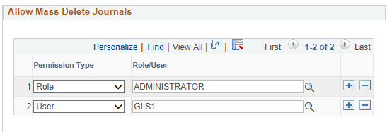

Use the Allow Mass Delete Journals page (WC_JRNL_DEL_ACCESS) to set up security to delete journals in mass by Role and Permission Type.
Navigation:
This example illustrates the fields and controls on the Allow Mass Delete Journals page.
If a User ID, or a User Role associated with a User ID, has been given access on the Allow Mass Delete Journals page, then when they access the Mass Delete Journals page, they see all journals created by all users and can delete those journals .
If a User ID, or a User Role associated with a User ID, has not been given access on the Allow Mass Delete Journals page, then when the access the Mass Delete Journals page, they only see the journals that they created and can only delete their those journals.
In the page shot above, User GLS1 and Role Administrator have been given access.
If user GLS1 logs into the system and accesses the Mass Delete Journals page, then the system displays journals created by all users, such as GLS1, VP1, and so on.
User GLS1 can delete all of these journals using the Mass Delete Journals page.
If user GLS2 logs into the system and accesses the Mass Delete Journals page, then the system displays only journals created by user GLS2.
User GLS2 can only delete journals they created on the Mass Delete Journals page.
If user VP1 logs into the system (VP1 is assigned to the Administrator role) and accesses Mass Delete Journals page, then the system displays journals created by all users, such as GLS1, GLS2, and so on.
User VP1 can delete all of these journals on the Mass Delete Journals page.

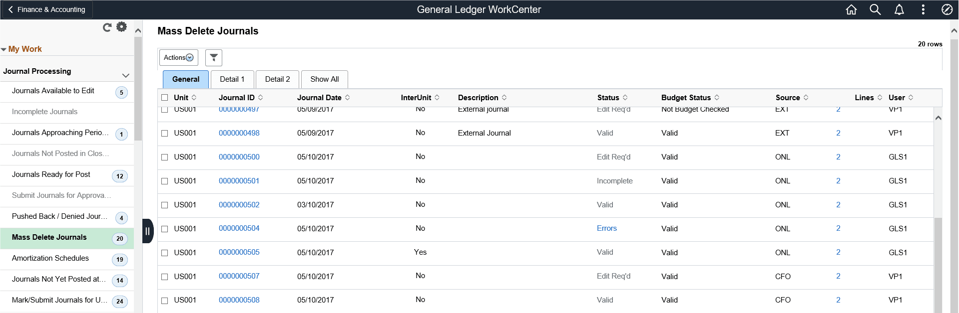

Use the Mass Delete Journals page (Fluid) (GL_WC_JRNLD_FL) to delete anchor journals in mass using the Fluid GL WorkCenter.
Navigation:
This example illustrates the fields and controls on the General Ledger WorkCenter - Mass Delete Journals Page (Fluid). You can find definitions for the fields and controls later on this page.
Field or Control |
Description |
Journal ID |
Select to open the Journal Entry - Lines window (JOURNAL_ENTRY_IE). |
Lines | Select to open Lines window (GLWC_JRNLD_LN_SCF) that displays more detail for each line. |
Actions | Select one of the following Actions:

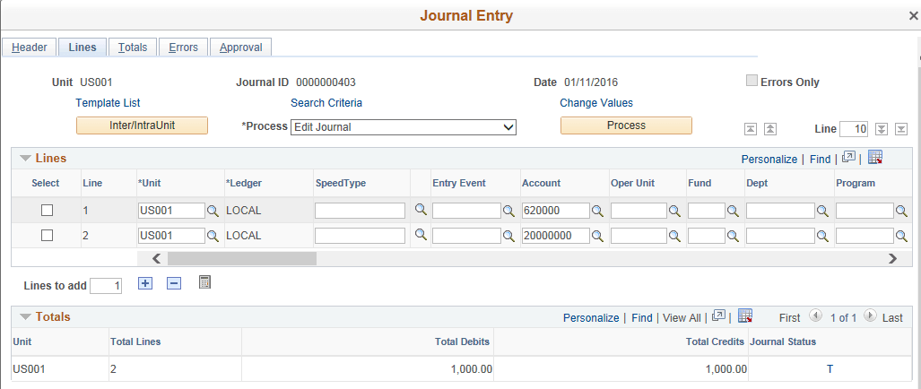

Mass Delete Journals - Journal Entry Page (Fluid)
Use the Mass Delete Journals - Journal Entry page (Fluid) to view line information in the Classic user interface.
This example illustrates the fields and controls on the Mass Delete Journals - Journal Entry page (Fluid).

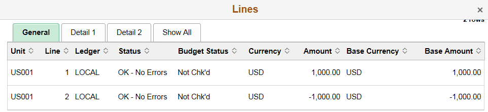

Mass Delete Journals - Lines Page (Fluid)
Use the Mass Delete Journals - Lines page (Fluid) to view line information in the Fluid user interface.
This example illustrates the fields and controls on the Mass Delete Journals - Lines Page (Fluid).

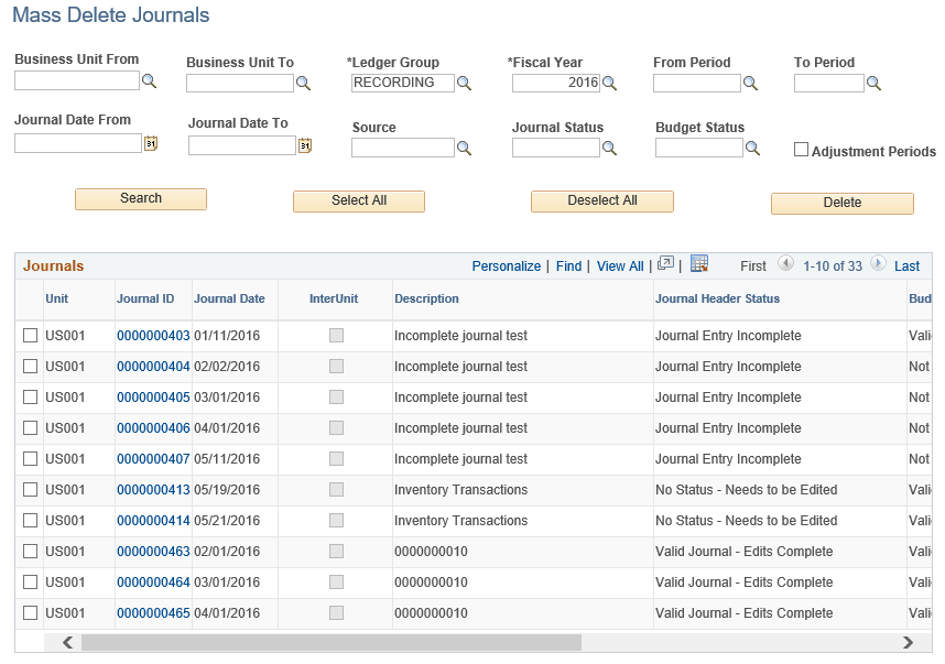

This example illustrates the fields and controls on the Mass Delete Journals and Lines page (Classic).
Use the Mass Delete Journals page (GL_MASS_JRNL_DEL) to delete anchor journals in mass from traditional navigation. When accessing the page using the navigator, filter fields are displayed.
Navigation:
This example illustrates the fields and controls on the Mass Delete Journals Page (Navigator).
