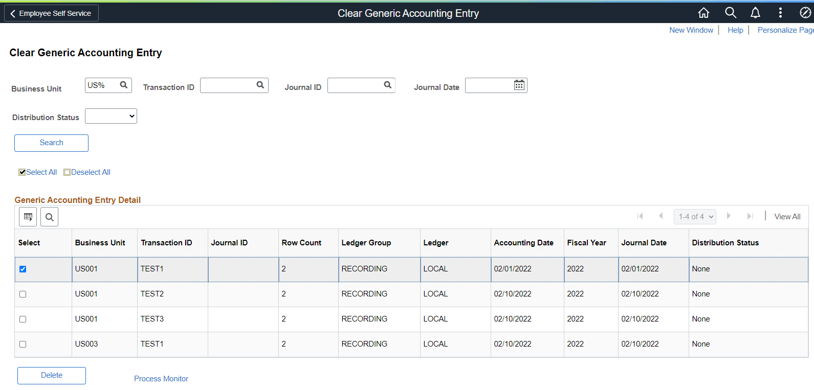

Use the Clear Generic Accounting Entry page (JGEN_ACT_ENTRY_DEL) to remove journal data loaded from third parties.

This example illustrates the fields and controls on the Clear Generic Accounting Entry page.
Use the search fields at the top of the page to search for accounting entries in the generic accounting entry table (JGEN_ACCT_ENTRY). You can use "%" to perform a partial search in the Business Unit, Transaction ID, and Journal ID fields. The Distribution Status values is limited to Distributed and None.
After performing a search, review the transaction IDs and select the rows you wish to remove from the generic accounting entry table. Select Delete to initiate the GL_ACCT_DEL application engine process and use the Process Monitor link to verify the process is successful.
