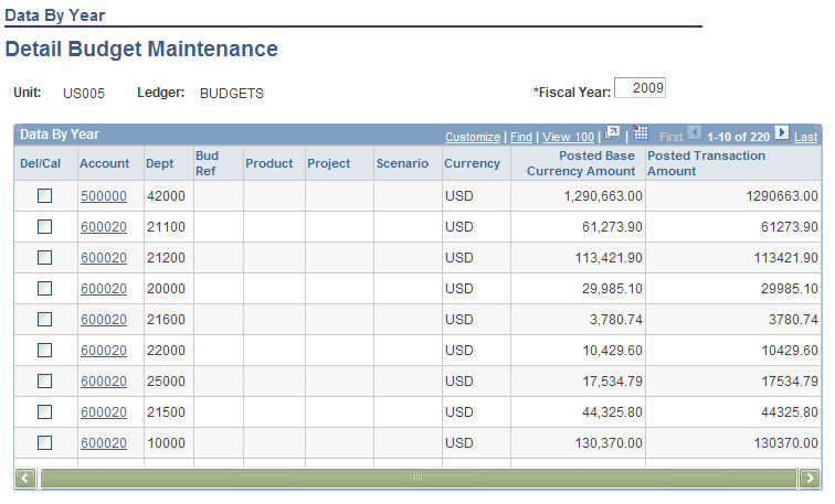

Use the Data by Year page (BE_ENTRY3A) to delete rows for the selected budget data and entered fiscal year and drill down to the Data by Period page for this specific account.
Navigation:
Click the Query link on the Detail Budget Maintenance page.
This example illustrates the fields and controls on the Data By Year page. You can find definitions for the fields and controls later on this page.
To use the Data by Year page:
Select the Del/Cal (delete/calculate) check box next to the ChartField rows that you want to either recalculate (by clicking the Calculate link) or delete (by clicking the Delete Selected link).
To view the Data by Period page and adjust information for an account on a period-by-period basis, click the account value link in the Account field for a specific row.
To return to the Detail Budget Maintenance page, click the ChartFields link.

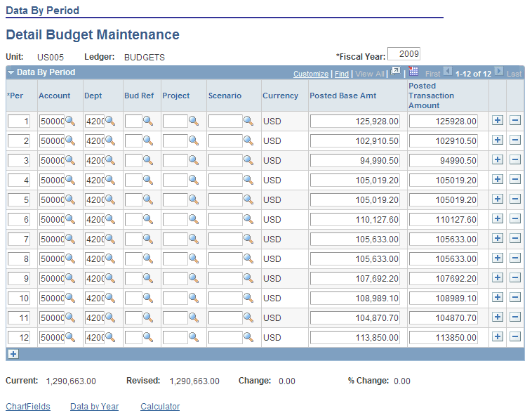

Use the Data by Period page (BE_ENTRY4) to delete or add rows and maintain budget detail information by period.
Navigation:
Click the Account link on the Data by Year page.
This example illustrates the fields and controls on the Data By Period page. You can find definitions for the fields and controls later on this page.
To use the Data by Period page:
Modify values, add or delete selected rows of data, or perform calculations on specified periods.
Click the Calculator link to access the Budget Calculation page, where you can modify budget calculations for accounts by period.

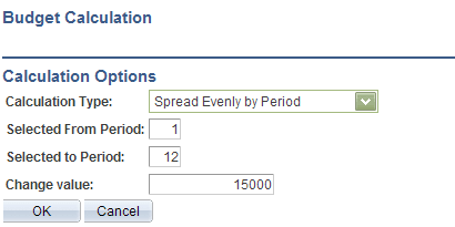

Click the Calculator link on either the Data by Year page or the Data by Period page to access the Budget Calculation page (search).
This example illustrates the fields and controls on the Budget Calculation page. You can find definitions for the fields and controls later on this page.
Field or Control |
Description |
Calculation Type |
Select one of the following options to determine how the system spreads the amount across the specified periods:
Selected From Period and Selected to Period |
Select the period range for which to apply the change. Note: These fields appear only when you click the Calculate link on Data by Period page. |
Change Value |
Enter the change value amount based on the selected budget period (either a year or a period). For example, suppose that you enter 12,000.00 USD to spread evenly over 12 periods, replacing the original budget of 60,000.00 USD, and you select OK on the Budget Calculation page. On the Date by Period page, no value appears in the Current field, and 12,000.00 USD appears in the Revised amount field. The Change field indicates the reduction in the period amounts from 5,000.00 USD to 1,000.00 USD, and the % Change field displays a negative 80.00 as the overall percentage reduction. |
