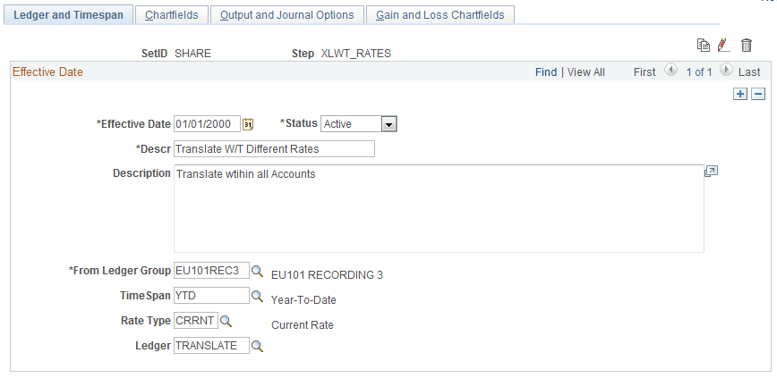

Use the Translation Within Ledger - Ledger and TimeSpan page (MBXLAT_STEP_LED_TM) to define a ledger and TimeSpan for the Translate Within Ledger process.
Navigation:
This example illustrates the fields and controls on the Translation Within Ledger - Ledger and TimeSpan page.
Although the Translation Within Ledger - Ledger and TimeSpan page is a different object than the Revaluation - Ledger and TimeSpan page, the fields are common to both pages.
Field or Control |
Description |
From Ledger Group and Ledger |
Specify the from ledger group and specific ledger in which you want to perform the Translate Within Ledger process. You must specify a translation ledger for this process. If you do not specify a ledger, the Translate Within Ledger process is run by the system against all the translation ledgers in the ledger group. |
TimeSpan |
General Ledger generates journal entries for which the amounts represent the period of time indicated by the TimeSpan for the step definition being processed. The TimeSpan typically used is BAL (balance sheet accounts). With this TimeSpan, the system totals the account balances in periods 0 through n for balance sheet accounts. |
Rate Type |
Enter the applicable rate type for the process. |

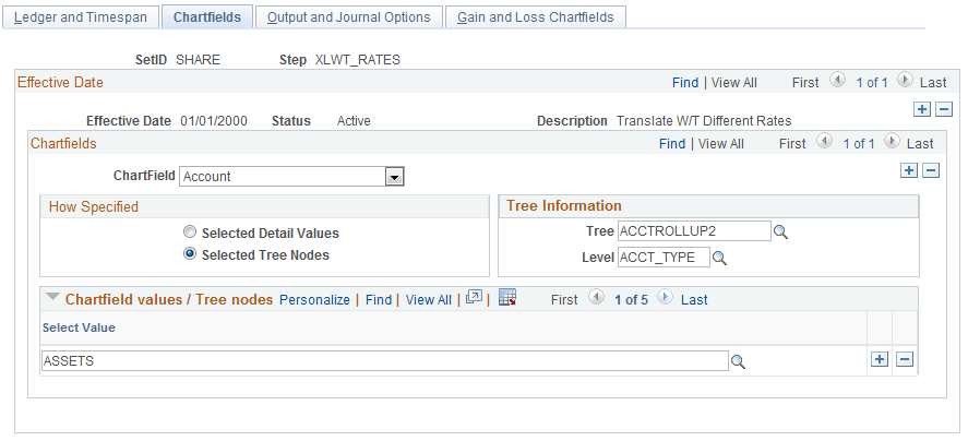

Use the Translation Within Ledger - Chartfields page (MBXLAT_STEP_CF) to identify the accounts that you want to include in your step.
Navigation:
This example illustrates the fields and controls on the Translation Within Ledger - Chartfields page.
Although this ChartField page has a different object name than the Revaluation - Source Chartfields page, the fields are common to both pages. See the Specifying Source ChartFields for Revaluation topic.
Field or Control |
Description |
Chartfields |
Select the accounts to be processed in the Chartfields group box. For example, you can list your balance sheet accounts individually as detail values or, more typically, you can define tree nodes. Using trees establishes rollups for the account values so that you can select particular types of accounts according to the structure of your business unit. |

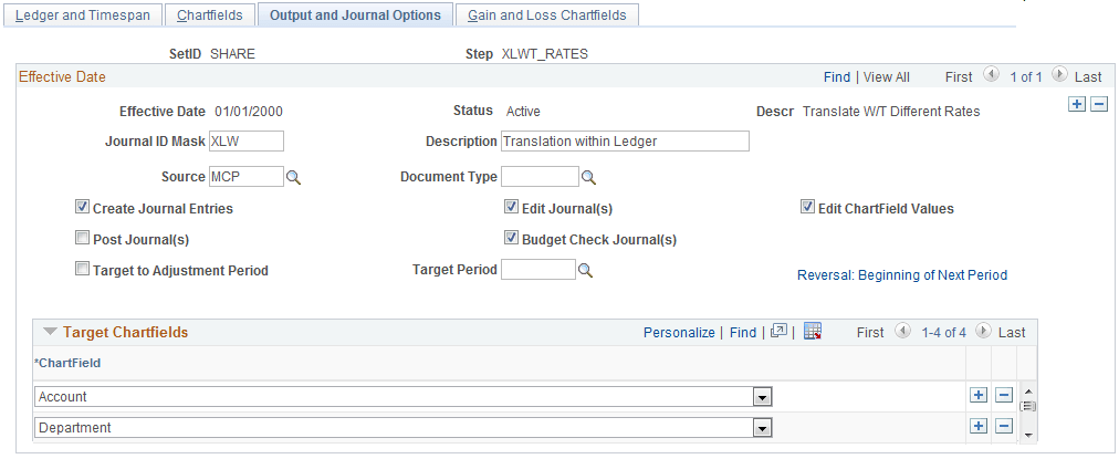

Use the Translation Within Ledger - Output and Journal Options page (CURR_STEP_OUT_JR) to determine whether General Ledger automatically posts translated amounts to the ledger or generates journal entries for subsequent posting.
Navigation:
This example illustrates the fields and controls on the Translation Within Ledger - Output and Journal Options page.
Refer to the Specifying Output and Journal Options for Revaluation topic for information about specifying output options, journal information, and revaluation reversal options for the Translation Within Ledger process.

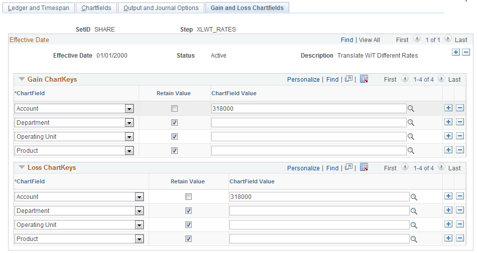

Use the Translation Within Ledger - Gain and Loss Chartfields page (CURR_STEP_GN_LS) to specify the specific accounts where you record translation gain or loss.
Navigation:
This example illustrates the fields and controls on the Translation Within Ledger - Gain and Loss Chartfields page.
Refer to the Specifying Gain and Loss Chartfields for Revaluation topic when specifying Translate Within Ledger gain and loss accounts.
