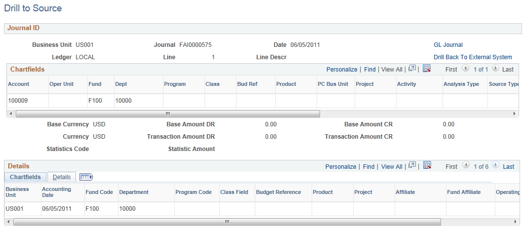

Use the Drill to Source page (FAI_GL_DRILL) to drill back to the to external system journal lines from GL journal line directly.
Navigation:
This example illustrates the fields and controls on the Drill to Source page.
Note: While drilling back from a PeopleSoft journal line to the Fusion Accounting Hub detailed lines, you may retrieve multiple, but around the first 50 Fusion Accounting Hub lines for each PeopleSoft line.
To enable this drillback capability, see Specifying the Drilldown URL.

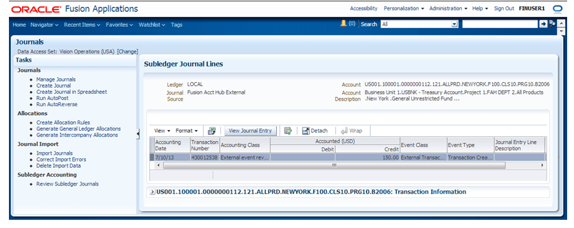

Use the Subledger Journal Lines page to view accounting transactions in the Fusion Accounting Hub application.
Navigation:
Select the Drill to Source icon from the Accounting Line Results group box of the External Accounting Integration Workbench.
This example illustrates the fields and controls on the Drill Back page. You can find definitions for the fields and controls later on this page.
You can view a summarized journal line in PeopleSoft, and drill directly to the Fusion Accounting Hub journal line Inquiry page to see all the original lines with any additional detail captured there.

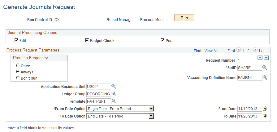

Use the Generate Journals Request page to apply the Accounting Entry Definition and Journal Generator Template to Fusion Accounting Hub entries and create PeopleSoft General Ledger journals.
Navigation:
Generate Journals
This example illustrates the fields and controls on the Generate Journals Request Page. You can find definitions for the fields and controls later on this page.
Note: Although you can configure the request to run at regular intervals, you may find it beneficial to review the transferred Fusion Accounting Entries prior to generating the PeopleSoft General Ledger journals.
Field or Control |
Description |
Journal Processing Options |
This can be left blank for generating journals from transferred Fusion Accounting Hub information. Optionally, you can select Edit and Post options. |
Process Frequency |
Select one of the following values when processing the request:
Once - executes the request the next time the batch process runs. After the batch process runs, the process frequency automatically reverts to “Don’t Run.” |
SetID |
Enter the SetID for which the delivered Accounting Definition Name, FAIJRNL, is defined. If the SetID value is not SHARE in this case, you will be unable to select the correct Accounting Definition Name since that is the SetID for the delivered value. |
Accounting Definition Name |
For the Fusion Accounting Hub integration, select “FAIJRNL” (the delivered accounting entry definition). |
Application Business Unit |
Select an application business unit that the system will use to derive the prompt values for selection. Journal Generator uses the system source from the Accounting Entry Template to derive the prompt table for the application business unit defined for the request. |
Ledger Group |
Select the ledger group that includes the ledgers that you would like to process. You can leave this field blank to process all ledger groups. |
Template |
Journal Generator creates journal entries for the specified journal generator template. The SetID of the prompt values is derived from the SetID entered earlier on the page. For the Fusion Accounting Hub integration, select the delivered Journal Generator Template, FAH_PSFT. |
From Date Option |
Select a value to further define which accounting entries that the Journal Generator extracts with this request. Journal Generator compares these dates to the accounting dates associated with each accounting entry. Select from the following values:
Process Date: Date specified on the business unit journal process date option. It can be a specified date defined on the business unit, or it can be the current date. |
From Date |
Enter a begin date in this field if you selected the Specify Date option. |
To Date Option |
Select a value to further define which accounting entries Journal Generator extracts with this request. Journal Generator compares these dates to the accounting dates associated with each accounting entry. Select from the following values:
To Date |
Enter an end-of-range date in this field if you selected the Specify Date option. |
