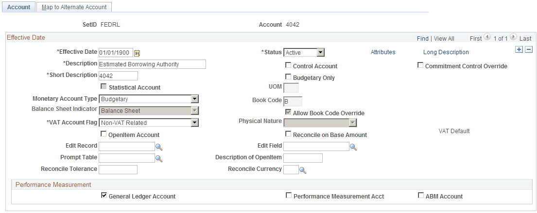

GL_ACCOUNT |
Access the Account ChartField to associate with ACCOUNT ChartField attributes. |

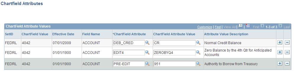

CF_ATTRIB_VALUES |
Select the ChartField attributes to associate with the selected ChartField value. |

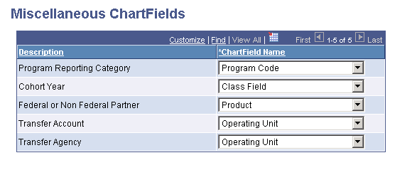

F2_ELEMENT_CF1 |
Select ChartFields to use for recording Program Reporting Category, Cohort Year, Transfer Agency, Transfer Account, and Transaction Partner information. |

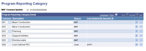

F2_PROG_RPT_CAT |
Maintain PRC codes by MAF Treasury Symbol. Identify the origin of the PRCs as either resulting from user-defined values or values downloaded from a MAF file. |

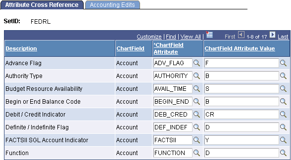

F2_ATTR_XREF |
Enables each agency to decide on the names of the fund and account attributes to be used in FACTS II processing. Each agency can either create its own names or use the names that are presented in this documentation. |

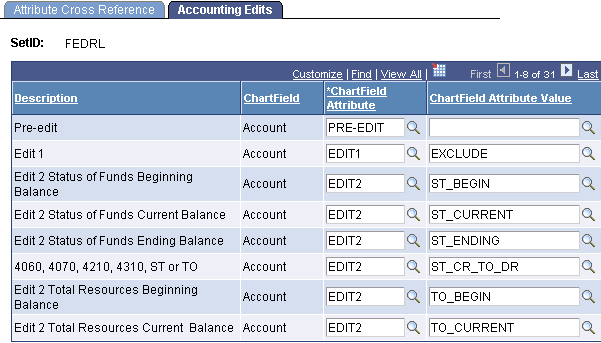

F2_ATTR_XREF_EDIT |
Specify the ChartField Attributes and Attribute values that are applicable to the accounting edits. |

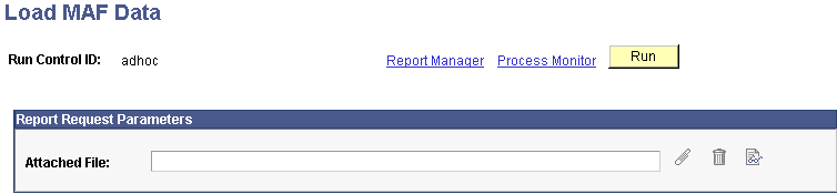

F2_RUN_MAF |
Load the MAF data from a file that is sent by the U.S. Treasury to the government agency to review in PeopleSoft General Ledger. |

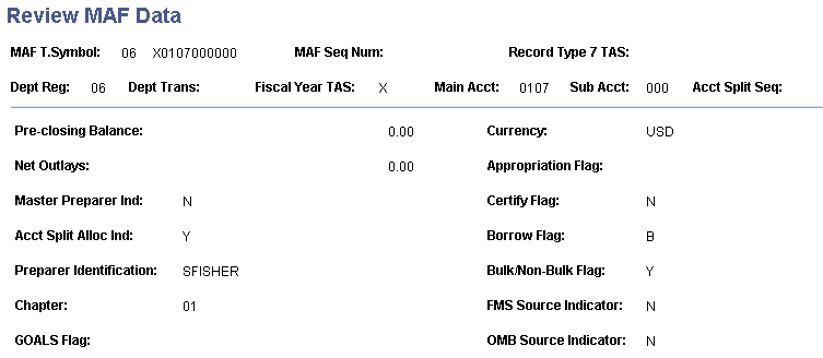

F2_MAF_INQUIRY |
Review the MAF data that is sent by the U.S. Treasury based on a selected MAF Treasury Symbol. Add, review, and MAF data. |

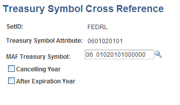

F2_TSYM_XREF |
Select the Treasury Symbol attribute that corresponds to the Treasury Symbol that is included in the MAF. |

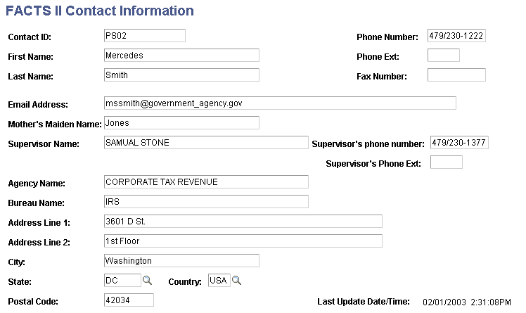

Use the FACTS II Contact Information page (F2_CONTACT_INFO) to contains contact information about the person or persons who are responsible for preparing and certifying FACTS II data for each of the appropriations and sending it to the U. S. Treasury in the Preparer file. Only preparers may change an appropriation symbol's SGL accounts or other related information.
Navigation:
General Ledger, Federal Reports, FACTS II Definition, FACTS II Contact Information, FACTS II Contact Information
This example illustrates the fields and controls on the FACTS II Contact Information page . You can find definitions for the fields and controls later on this page.
Field or Control |
Description |
Contact ID |
Enter a U.S. Treasury ID number to add or modify information about your agency's FACTS II contact personnel. |
First Name and Last Name |
Enter the first and last names of the FACTS II preparer. |
Phone Number, Phone Ext, Fax Number, and Email Address |
Enter the telephone number, phone extension, fax number, and email address of the preparer. |
Mother's Maiden Name |
For security purposes, enter the maiden name of the preparer's mother. |
Supervisor Name, Supervisor's phone number, and Supervisor's Phone Ext. |
Enter the name, phone number, and phone extension of the preparer's supervisor. |
Agency Name |
Enter the name of the agency that is responsible for submitting FACTS II data. |
Bureau Name |
If the FACTS II data represents a bureau or division of the agency, enter that name. |
Address Line 1, Address Line 2, City, State, Country, and Postal Code |
Enter the agency's street address (the second line is for information such as building or suite number), city, state, country, and postal code. |
Last Update Date/Time |
Each time you save this record, this field is updated. |

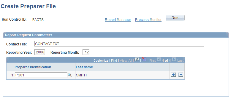

Use the Create Preparer File page (F2_RUN_CONTACT) to runs the Application Engine GL_F2 CONTACT, which creates the Contact Information Record and Contact Information Record Trailer (Input) record in the indicated input file and creates an output flat file to send to the U. S. Treasury.
Navigation:
This example illustrates the fields and controls on the FACTS II - Create Preparer File page. You can find definitions for the fields and controls later on this page.
Field or Control |
Description |
Contact File |
Enter a contact file name with a .TXT extension. Do not enter the entire path. |
Reporting Year and Reporting Month |
Enter the year and month for this FACT II submission. |
Preparer Identification |
Select the preparer's identification number. You can select more than one. |
Run |
Click to access the Process Scheduler Request page to run the Create FACTS Preparer File process (GL_F2CONTACT). |

Use the ChartField Values - Account page (GL_ACCOUNT), for example, to access the Account ChartField to associate with ACCOUNT ChartField attributes.
Use a ChartField such as Account, Fund Code, or Budget Reference that requires attributes.
Navigation:
This example illustrates the fields and controls on the ChartField Values - Account page. You can find definitions for the fields and controls later on this page.
Field or Control |
Description |
Attributes |
Click this link to associate the ChartField attributes that you set up for FACTS II with the appropriate Account value (or Fund Code ChartField value on the Fund Code page or Budget Reference ChartField value on the Budget Reference page) that is required for FACTS II reporting. |
Use the ChartField Attributes page (CF_ATTRIB_VALUES) to select the ChartField attributes to associate with the selected ChartField value.
Navigation:
Click the Attributes link on an Account or Fund Code page.
This example illustrates the fields and controls on the ChartField Attributes page. You can find definitions for the fields and controls later on this page.
After selecting the Attributes link, a row that contains values for SetID, ChartField Value, Effective Date, and Field Name appears.
Field or Control |
Description |
ChartField Attribute |
Select the appropriate ChartField attribute for this ChartField Value. |
ChartField Attribute Value |
Select the ChartField attribute value for this ChartField attribute. You can add as many rows as needed of ChartField attributes and ChartField attribute values for the selected ChartField value (in this example, Account 4042). |
Use the Miscellaneous ChartFields page (F2_ELEMENT_CF1) to select ChartFields to use for recording Program Reporting Category, Cohort Year, Transfer Agency, Transfer Account, and Transaction Partner information.
Navigation:
This example illustrates the fields and controls on the Miscellaneous ChartFields page. You can find definitions for the fields and controls later on this page.
Note: You can change the delivered ChartField specifications to any configurable ChartField. For example, the FACTS II Data Element FED_NONFED is associated with Transaction Partner. You can change this to any other configurable ChartField. However, you must use different ChartFields for each of the FACTS II Data Elements. The exceptions to this rule are the ChartFields for Transfer Account and Transfer Agency. They can use the same configurable ChartField or two different ChartFields. In this example, Trading Partner is associated with both of these FACTS II Data Elements. Your decision to use either a single ChartField for Transfer Agency and Transfer Account or separate ChartFields has an effect on how you will enter data into your ledger. Some of these ChartField names are the result of a ChartField configuration.
Field or Control |
Description |
Description |
The PeopleSoft application predefines theProgram Reporting Category Cohort year, Federal or Non Federal Partner, Transfer Account, and Transfer Agency data elements and descriptions. |
ChartField Name |
Select a configurable ChartField for each FACTS II Data Element. Because Transfer Agency and Transfer Account are related, you can assign the same configurable ChartField to them, if you want, or set them up with separate configurable ChartFields. All other FACTS II data elements must be associated with different configurable ChartFields. |
Use the Program Reporting Category page (F2_PROG_RPT_CAT) to maintain PRC codes by MAF Treasury Symbol.
Navigation:
This example illustrates the fields and controls on the Program Reporting Category page. You can find definitions for the fields and controls later on this page.
Enter a MAF Treasury Symbol and view its existing PRC codes and the descriptions that you downloaded from a MAF or that you manually entered using this page.

Category |
Valid PRC values are 001 to 999. |
Field or Control |
Description |
Description |
The description can vary for a Category depending on the MAF Treasury Symbol. |
Field or Control |
Description |
Source |
Identifies the origin of a FACTS II Program Reporting Category as user-defined values or as values downloaded from a MAF file. |
Last Updated By Operator ID |
Identifies the operator ID that last manually entered or modified a PRC code value or description. |
Use the Attribute Cross Reference page (F2_ATTR_XREF) to enables each agency to decide on the names of the fund and account attributes to be used in FACTS II processing.
Navigation:
Note: Existing customers who are implementing this enhancement should reopen the Attribute Cross Reference and Accounting Edits pages and enter the ChartField Attribute names for the new data elements that are introduced by this enhancement.
This example illustrates the fields and controls on the FACTS II - Attribute Cross Reference page. You can find definitions for the fields and controls later on this page.
Field or Control |
Description |
Description |
These are the predefined attributes that the FACTS II processes requirements of the U.S. Treasury. |
ChartField |
The PeopleSoft application predefines the Field Name for ACCOUNT, FUND_CODE. and BUDGET_REF. |
ChartField Attribute and ChartField Attribute Value |
Select the ChartField attributes and attribute values that you defined as cross-references to each data element. Note: The values selected are only examples. |
Use the Accounting Edits page (F2_ATTR_XREF_EDIT) to specify the ChartField Attributes and Attribute values that are applicable to the accounting edits.
Navigation:
Click the Accounting Edits tab on the Attributes Cross Reference page.
This example illustrates the fields and controls on the Accounting Edits page. You can find definitions for the fields and controls later on this page.
Field or Control |
Description |
Select the attributes and attribute values that you defined to cross-reference each of the predefined data elements that is listed on this page. |
Note: Refer to Review FACT II Data, Detail Attributes to review attributes for each ChartField value for a selected business unit and period.
Use the Load MAF Data (load master account file data) page (F2_RUN_MAF) to load the MAF data from a file that is sent by the U. S. Treasury to the government agency to review in PeopleSoft General Ledger.
Navigation:
This example illustrates the fields and controls on the Load MAF Data page. You can find definitions for the fields and controls later on this page.
Field or Control |
Description |
Click the Add Attachment button and type the path and file name, or click the Browse button to navigate to the MAF location. Click the Upload button to store the file as an attachment. The file name appears in the Attached File field. At the beginning of each fiscal year, the U.S. Treasury sends a MAF containing the U.S. Treasury account fund symbols (TAFS) for a specific agency along with the preparer and certifier IDs for each symbol. With this data, the U.S. Treasury sends a spreadsheet containing the attributes for each SGL account. You can use this spreadsheet to validate that your data is set up correctly. |
Run |
Click to upload the file using the PS/GL MAF Load (F2_MAF_LOAD) process. This process loads the date from the file to the appropriate database table. |
Note: The Add, Delete, and View Attachment buttons work the same way as they do for FACTS I.
Use the Review MAF Data page (F2_MAF_INQUIRY) to review the MAF data that is sent by the U. S. Treasury based on a selected MAF Treasury Symbol. Add, review, and MAF data.
Navigation:
This example illustrates the fields and controls on the Review MAF Data page. You can find definitions for the fields and controls later on this page.
Field or Control |
Description |
MAF T.Symbol (master accounting file treasury symbol) |
Stores the Treasury Symbol in the format that is defined by the U.S. Treasury for FACTS II processing. This Treasury Symbol is different from the Treasury Symbol format that is required by most other U.S. Treasury reporting. |
MAF Seq Num (master accounting file sequence number) |
The U.S. Treasury supplies this number. If the U.S. Treasury sends the agency a new MAF file, this number is increased incrementally. |
Record Type 7 TAS (record type 7 treasury appropriation fund symbol) |
The application displays a three-digit numeric code that is attached to the end of the Treasury Appropriation Fund Symbol. This code identifies the type of fund resources, such as Fund Held Outside of the Treasury, Authority to Borrow from the Treasury, and Unrealized Discounts. |
Dept Reg (department regular) |
Displays a regular (versus a transfer) department number that is associated with this MAF Treasury Symbol. |
Dept Trans (department transfer) |
Displays a transfer (versus a regular) department number that is associated with this MAF Treasury Symbol. |
Fiscal Year TAS (fiscal year treasury appropriation fund symbol) |
Displays the funding period of the appropriation that applies to this MAF Treasury Symbol. |
Main Acct (main account) |
Displays the main account that is used for this MAF Treasury Symbol. |
Sub Acct (sub account) |
Displays a sub account that is used for this MAF Treasury Symbol. |
Acct Split Seq (account split sequence) |
Displays the account split that is provided by the Office of Management and Budget interface file. Any number that is greater than 000 is an account split. |
Pre-closing Balance |
Displays the remaining appropriation balance for this department prior to the close of the fiscal year. |
Net Outlays |
Displays the net collections and disbursements that are reported to date to the U.S. Treasury by this department for the current fiscal year. |
Master Preparer Ind (master preparer indicator) |
Identifies whether a master preparer is required. This value is only necessary if an account split applies to this account. |
Acct Split Alloc Ind (account split allocation indicator) |
Indicates whether the master preparer divided the account balance among the members of an account split. |
Displays the FACTS II preparer's name for this department. |
Chapter |
Displays the chapter number that is used in the U.S. Treasury's Annual Report. |
GOALS Flag (Government Online Accounting Link System flag) |
Indicates that the FACTS II file can be imported to the Government Online Accounting Link System (GOALS). |
Appropriation Flag |
Indicates that an appropriation is associated with this MAF Treasury Symbol. |
Certify Flag |
Indicates whether this MAF Treasury Symbol is required by the Budget Reports Branch of the Financial Management Service. |
Borrow Flag |
Indicates whether a borrowing source is required for this MAF Treasury Symbol. |
Bulk/Non-Bulk Flag |
Y indicates that you want to send the FACTS II information in a bulk transfer file. N indicates that you want to send the FACTS II information in a non-bulk transfer file. |
FMS Source Indicator (Financial Management Services source indicator) |
The FMS interface indicator. |
OMB Source Indicator (Office of Management and Budget source indicator) |
The OMB interface indicator. |
Use the Treasury Symbol Cross Reference page (F2_TSYM_XREF) to select the Treasury Symbol attribute that corresponds to the Treasury Symbol that is included in the MAF.
Navigation:
This example illustrates the fields and controls on the Treasury Symbol Cross Reference page. You can find definitions for the fields and controls later on this page.
Field or Control |
Description |
SetID |
Select the SetID that applies to the FACTS II reporting data. |
Treasury Symbol Attribute |
Select the attribute that corresponds to the MAF Treasury Symbol. |
MAF Treasury Symbol (master accounting file treasury symbol) |
Select the MAF Treasury Symbol, which is imported from the U.S. Treasury MAF file. |
Cancelling Year |
Select this option if the Treasury Symbol is beyond the cancelling year. FACTS II determines the cancelling year by adding six years to the last year of availability. You must select this option to enable Edit 10 to process. |
After Expiration Year |
Select this option if this Treasury Symbol expired. If a Treasury Symbol expires, zero-balanced rows cannot be reported to the FACTS II Import file. To identify the accounts that are associated with an expired Treasury Symbol, you must select the Ignore on Expiration (IGN_ON_EXP) attribute and select Y for the attribute value on the Attribute Xref page. |
