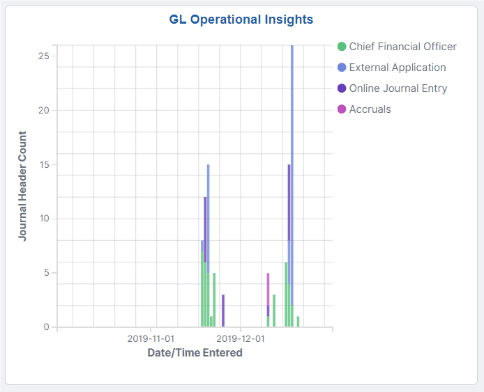

GL Operational Insights, see GL Operational Insights Dashboard.

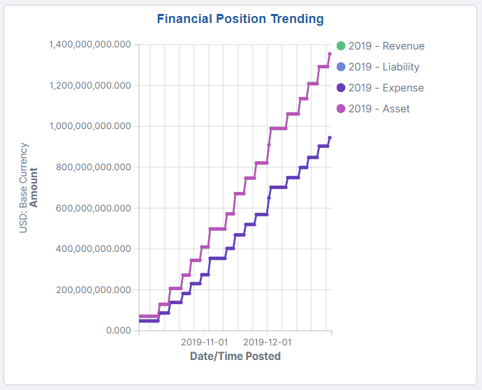

Financial Position Trending, see Financial Position Trending Dashboard.

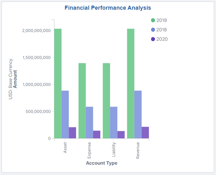

Financial Performance Analysis, see Financial Performance Analysis Dashboard.

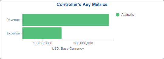

Controller Key Metrics, see Controller's Key Metrics Dashboard.

This example illustrates the GL Operational Insights Tile.
This example illustrates the Financial Position Trending Tile.
This example illustrates the Financial Performance Analysis Tile.

This example illustrates the Controller's Key Metrics Tile.

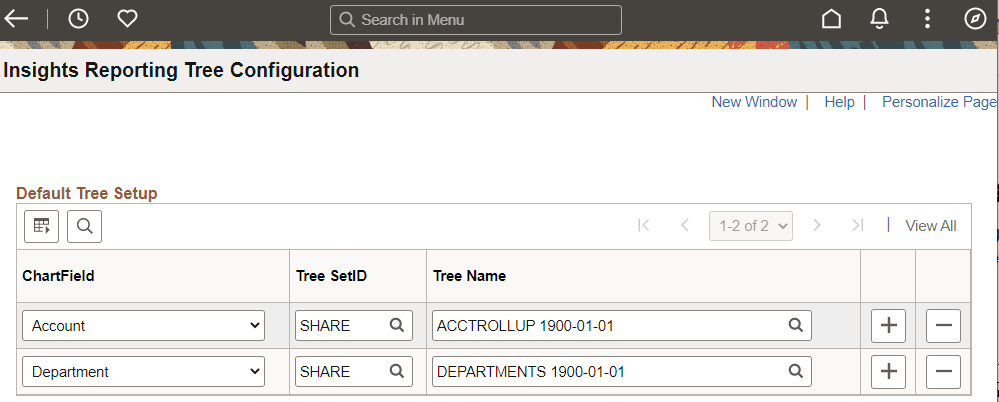

Use the Insights Reporting Tree Configuration page (GL_KIB_DFLT_TREE) to determine the reporting account and department trees to be used when indexing Insights dashboards for General Ledger.
Navigation:
This example illustrates the fields and controls on the Insights Reporting Tree Configuration page.
Field or Control |
Description |
ChartField |
Select a ChartField to assign to the respective reporting tree. Insights dashboards for General Ledger are designed to support only account and department ChartFields |
Tree SetID |
Select the SetID for the tree. Multiple reporting trees can be configured for a ChartField and Tree SetID combination |
Tree Name |
Select a flattened tree name and effective dated row that is used to index the reporting tree for General Ledger Insights dashboards. Note: Before selecting the tree name, you must run the Tree Flattener Process for the reporting tree using the Tree Flattener Request Page. |

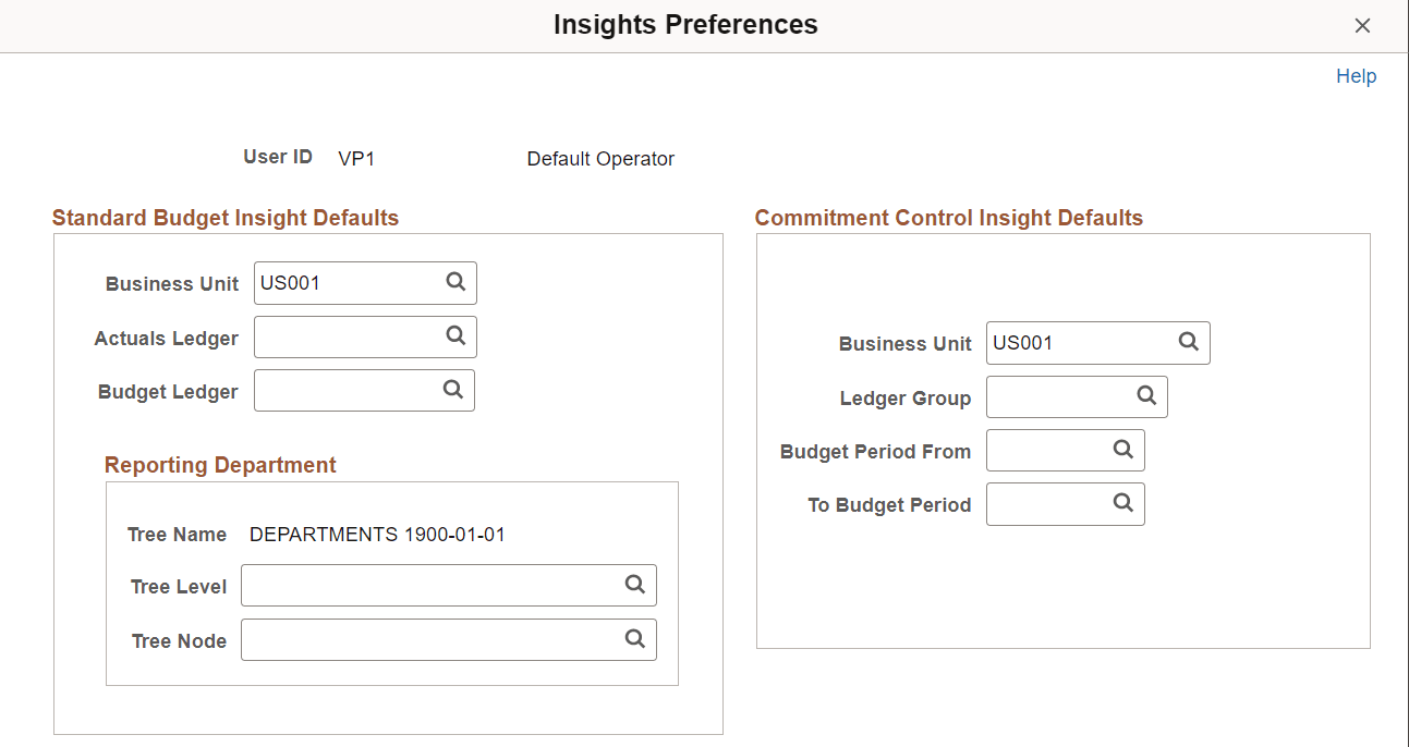

Use the Insights Preferences page (GL_K_USER_DEFAILTS) to configure user defaults that are used when accessing dashboards for General Ledger and Commitment Control.
Navigation:
. Select the Insights Preferences link.
This example illustrates the fields and controls on the Insights Preferences page.
Enter a default for the available fields.
