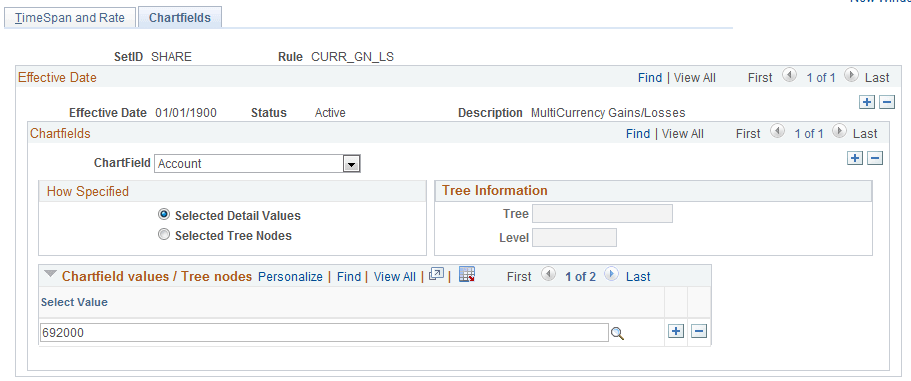

Use the Chartfields page (TRANS_RULE_CF) to specify the ChartFields for the translation rule.
Navigation:
This example illustrates the fields and controls on the Translation Rule - Chartfields page.
Field or Control |
Description |
ChartField |
Select the ChartField to be translated using the TimeSpan and rate type specified. For example, assets and liabilities are typically translated as balances (BAL) at the current exchange rate (CRRNT), while retained earnings are translated at a historical exchange rate (HSTRE). |
How Specified |
Select the Selected Detail Values option to list asset accounts individually or, more likely, select the Selected Tree Nodes option to activate the Tree Information fields, where you can specify a tree from which to select nodes. |
Tree Information |
Enter each tree node in the Tree field. The Level field is optional. If the tree has levels, you can limit prompting to selected levels. Using trees establishes rollups for the account values so that you can select particular types of accounts according to the structure of your business unit. It is best to use trees whenever possible, which reduces future maintenance when your ChartField values change. |
