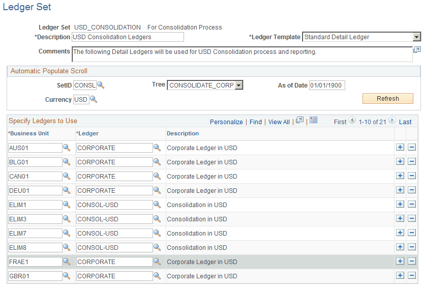

Use the Ledger Set page (LEDGER_SET) to select the combination of business units and ledgers that you want to consolidate for a specific consolidation configuration.
Navigation:
This example illustrates the fields and controls on the Consolidation - Ledger Set page. You can find definitions for the fields and controls later on this page.
Automatic Populate Scroll
The Automatic Populate Scroll section enables you to select the parameters that will populate the scroll with the ledgers that you can use. After you choose parameters, click the Refresh button to populate the page.
Note: When you click the Refresh button, the system provides you with only the best guess of ledger names. Review the ledger names populated by the system, and select the ledger that you want to use in the consolidation.

Specify Ledgers to Use
When you click Refresh, the system populates the scroll area with the following:
Field or Control |
Description |
Business Unit |
Populates the valid values in the selected tree for the specified ledger template. |
Ledger |
Displays a ledger associated with each business unit that has the specified currency as its base currency. You can associate a different ledger with the business unit by selecting a new one in the drop-down list box. |
You can also enter business units and their associated ledgers individually by adding a row. The new business unit does not have to be part of the earlier specified tree.
Note: All business units involved in the consolidation process must have a row defined on the Ledger Set page so that the system knows which ledger to use for each business unit during the consolidation process.
