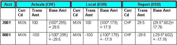

Beginning Ledger
This table shows the results of revaluation in a multibook environment. Assume that the following balances exist in the ledger. Account 2001 is a balance sheet account; 8001 is a profit and loss account. The base amount calculations are shown to exhibit the derivation of the base currency balance:
Example of Assumed Beginning Ledger Balances

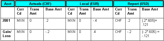

Month End Revaluation Journal (Only Revalue Balance Sheet Accounts)
This journal results from running revaluation on the entire ledger group. The revaluation process skips the report ledger because it is specified as a translation ledger. The actuals and local ledgers are revalued. Running journal edit on this ledger carries the adjustments to the base currency of the actuals ledger down to the report ledger.
Example of Month-End Revaluation

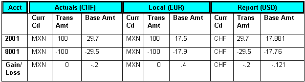

Ending Ledger
The following table contains the ending ledger amounts after the revaluation:
Example of Ending Ledger Amounts
