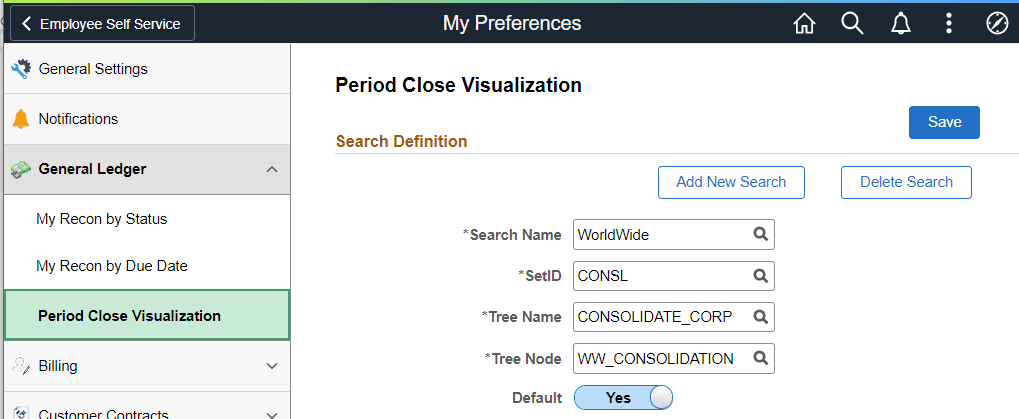

Use the My Preferences - Period Close Visualization page (GL_BUVISUL_SRCH_FL) to determine the tree that is displayed when performing a search on the Period Close Visualization page.
Navigation:
This example illustrates the fields and controls on the My Preferences - Period Close Visualization page.
Note: The Tree and Tree Nodes are used for Period Close Visualization.
Field or Control |
Description |
Delete Search |
Select to access the Delete Saved Searches page where you can delete previously defined searches. Note that the default search cannot be deleted unless you designate another search as the default first. |
Search Name |
Enter a name or value that is meaningful to you. This value is used when accessing the Period Close Visualization search page. |
Tree Name and Tree Note |
Select the business unit tree and the tree node that you want to view in the Period Close Visualization page. (For example see Period Close Visualization Page (Level 1 - Compact View). You can create multiple tree and tree node search combinations but only one can be defined as the default. |

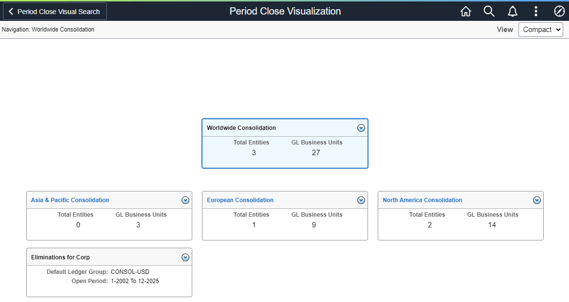

Use the Period Close Visualization page (GL_BU_CHART_FL) to view and take action on General Ledger entities (node) and general ledger business units (leaf) based on the tree name and tree node selected on the My Preferences - Period Close Visualization page.
Navigation:
Select the Finance & Accounting search menu, Period Close Visualization tile, enter the Search Name (defined on the My Preferences - Period Close Visualization page), select the View Visualization button.
This example illustrates the fields and controls on the Period Close Visualization page at level 1, using the Compact View option.
This tile and page requires you to have full access to the Open Period Update (OPEN_PERIOD_UPDATE) component.
Based on the tree and tree node selected, the system displays the tree in a hierarchical manner. The highlighted card (or box) is the focus (or parent) card and the cards below are the child card(s). The child cards are tree nodes or a GL business unit. Each card displays the number of child nodes. A zero indicates there is no child for that card.
The example above displays the Compact view:
If the card is a tree node (all cards displayed above), then the total entities and GL business units under that tree node are displayed.
If the card is a GL business unit (no cards displayed above), it displays the Default Ledger Group and current open period of that GL business unit.

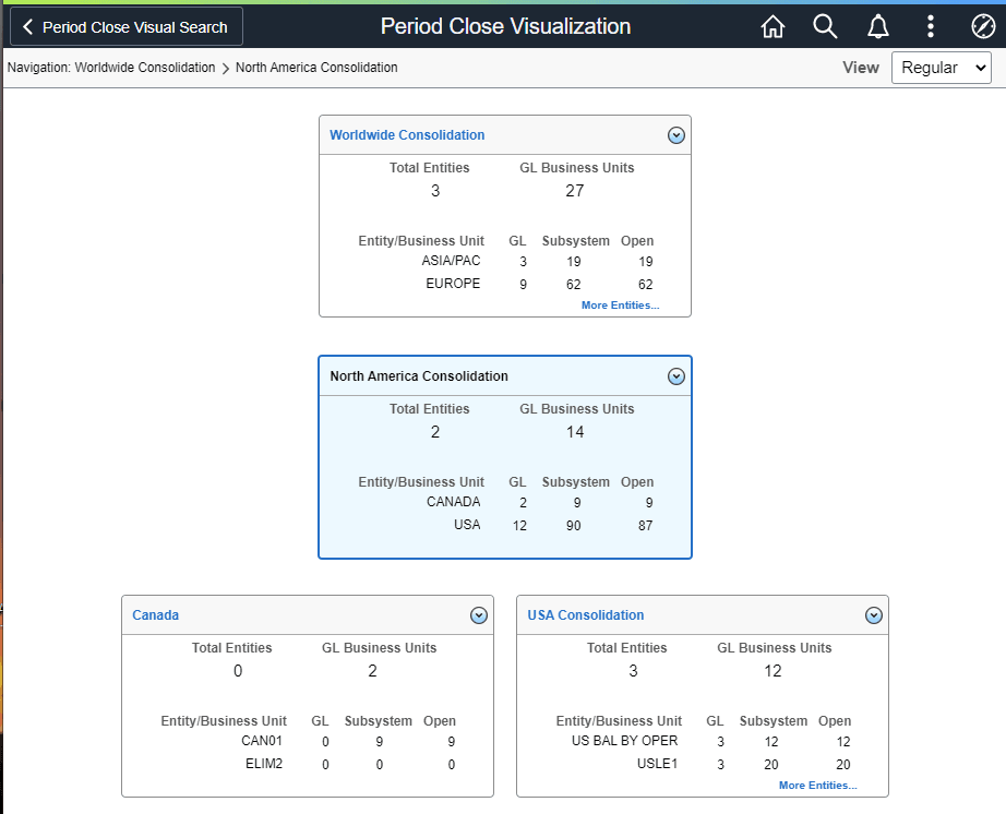

Use the Period Close Visualization page (GL_BU_CHART_FL) to view and take action on General Ledger entities and business units.
Navigation:
Select the Finance & Accounting search menu, Period Close Visualization tile, enter the Search Name (defined on the My Preferences - Period Close Visualization page), select the View Visualization button. Drill down one level and select the Regular view.
This example illustrates the fields and controls on the Period Close Visualization Page (Level 2 - Regular View).
The example above displays the Regular view:
If the card is a tree node (all cards displayed above), along with Total Entities and GL Business Units, it display the count of GL business units, Subsystem business units, and a count of Sub-ledgers business units for which the open period is currently open for each child node.
If the card is a GL Business Unit (no cards displayed above), along with Default Ledger Group and current open period, and:
The count in the GL column is zero (0).
This indicates that there are no more child GL business units or this is the detail level on the tree
The number of open and closed business units for each subsystem is displayed.
If the open period from date of the sub-ledger business unit is after the open period from date of the corresponding GL business unit, then the period is closed for the sub-ledger business unit. Otherwise, the period is open for the sub-ledger business unit.
Note: As you drill into more levels, the system displays the breadcrumbs in the upper left of the page. These are the parent nodes you selected.

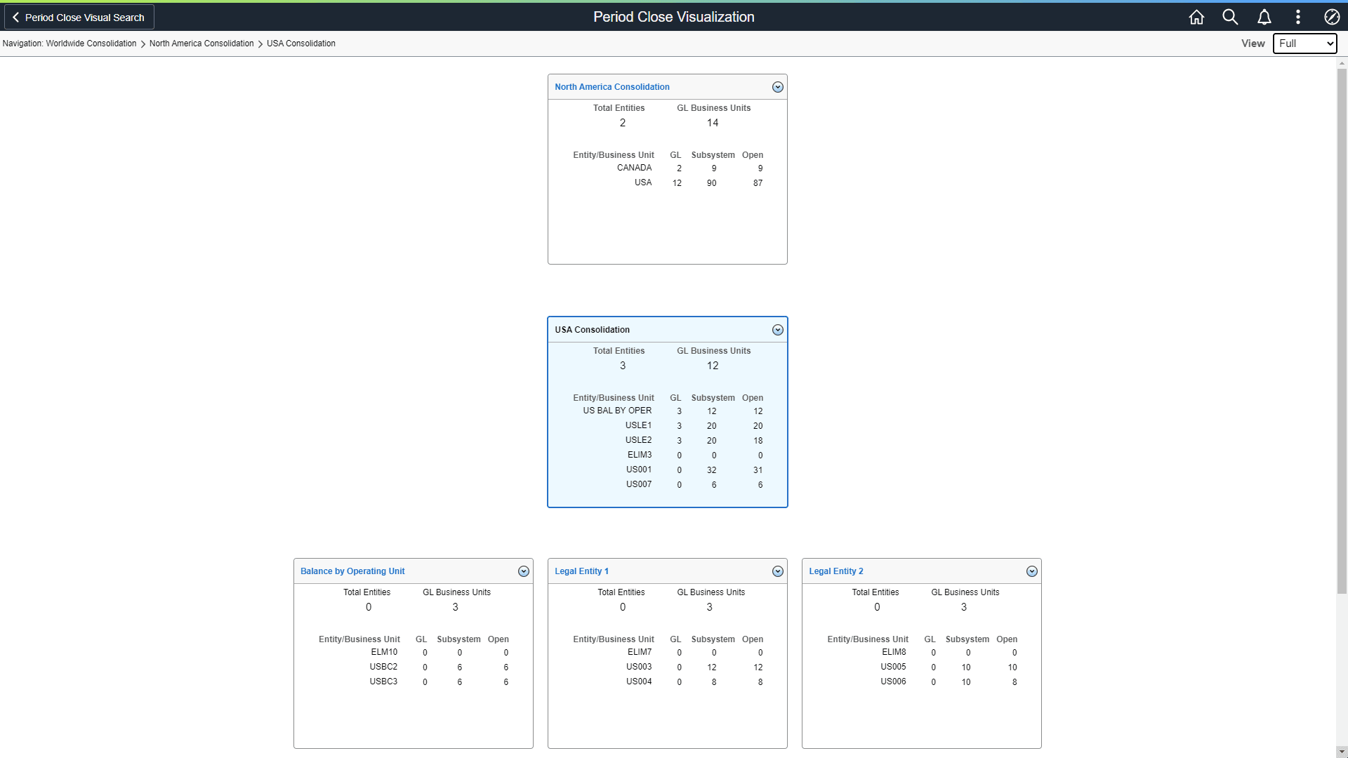

Use the Period Close Visualization page (GL_BU_CHART_FL) to view and take action on General Ledger entities, business units, and subsystems.
Navigation:
Select the Finance & Accounting search menu, Period Close Visualization tile, enter the Search Name (defined on the My Preferences - Period Close Visualization page), select the View Visualization button. Drill down two levels and select the Full view.
This example illustrates the fields and controls on the Period Close Visualization Page (Level 3 - Full View) (1 of 2)
This example illustrates the fields and controls on the Period Close Visualization Page (Level 3 - Full View) (2 of 2)
The example above displays the Full view:
If the card is a tree node (Legal Entity 1 card), along with Total Entities and GL Business Units, it displays the count of GL business units and Subsystem business units for each child card or node.
If the card is a GL business unit (US001 New York Operations card), along with Default Ledger Group and current open period, it displays the number of open and closed business units for each subsystem.
If the GL column displays a zero (0), then the Entity/Business Unit column is an entity.
Not a business unit.

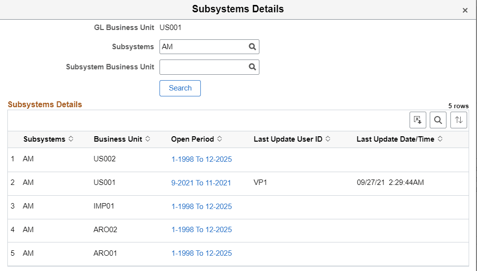

Use the Subsystem Details page (GL_APP_BU_DTL_SCF) to view the open period of all subsystems for a business unit.
Navigation:
From the Period Close Visualization page, level 3 - Full view, select a subsystem link.
This example illustrates the fields and controls on the Subsystem Details page using the Full View option.
Field or Control |
Description |
Open Period (column) |
Select the date range link in this column to access the Open Period Update Page where you can define or modify open periods for a subsystem business unit. |

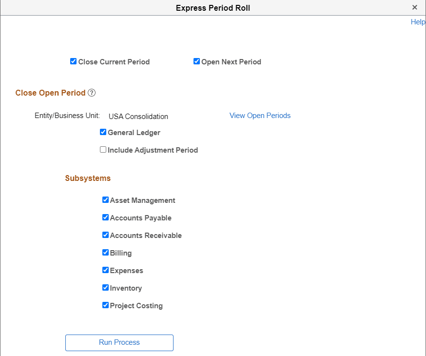

Use the Express Period Roll page (GL_PRD_UPD) to run the Express Close process (GL_OPEN_UPD).
Navigation:
From the Period Close Visualization page, select the Action button and then select Express Period Roll.
This example illustrates the fields and controls on the Express Period Roll page.
This process closes the current period, opens the next period, or both, for the selected entity or GL business unit. You can also select which subsystems to close and open, and whether to include adjustment periods.
This process increments the current open period by one period for the default Ledger Group of the selected business unit. In addition, it only rolls over the open periods for Monthly, Weekly, Period13 and Daily calendars.
When selecting the Express Close action for a particular node, the Express Close process is run for all child GL business units and the selected sub-ledger business units for the default ledger group.
Note: PeopleSoft recommends that you run this process with the Close Current Period and the Open Next Period check boxes selected.
Field or Control |
Description |
Close Current Period |
Select to run the process to close the current period of the entity or business unit. The system increments the from period by one. |
Open Next Period |
Select to run the process to open the next period of the entity or business unit. If the Close Current Period is selected, the system increments the To Period of the open period by one. |
View Open Periods |
Select to access the Open Period Details Page. This link displays the business units where period is currently open. When the period for all business units are closed, the system displays a blank page. |
General Ledger |
Select to open all check boxes for Include Adjustment Period and Subsystems. |
Include Adjustment Period |
Select to increment the adjustment period for the GL business unit. The system increments the Adjustment year to the next year. This check box is only available when the General Ledger check box is selected. |
Subsystems |
Select to include the subsystem business units in the close and open process. |

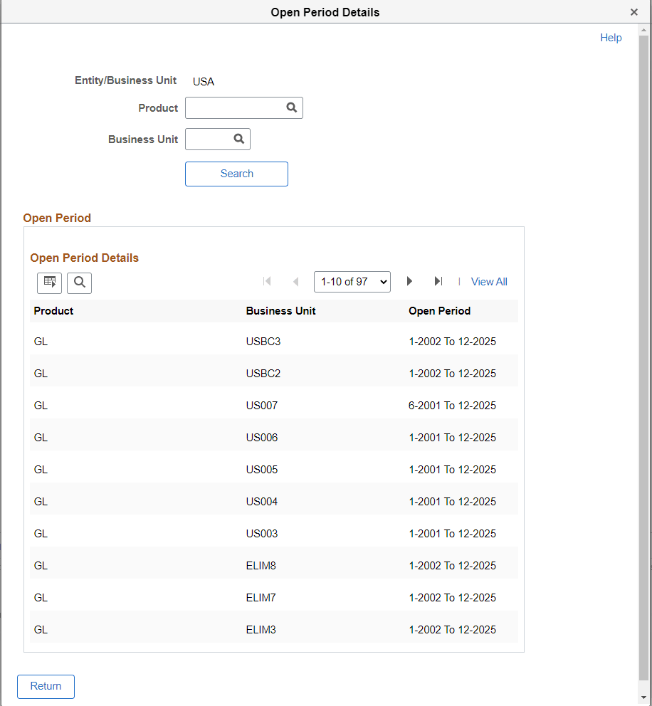

Use the Open Period Details page (GL_NODE_BU_DTL_SCF) to view open periods for a subsystem, GL business unit, or both.
Navigation:
From the Express Period Roll page, select the View Open Periods link.
This example illustrates the fields and controls on the Open Period Details page.
This page only displays open periods. Periods that are not open are not displayed on this page.
