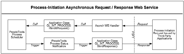

Process Initiation Asynchronous Web Service Process Flow
PeopleSoft delivers the following as part of the generic process initiation integration between third-party applications and PeopleSoft Financials (PeopleTools 8.51):
Generic process initiation Asynchronous Request/Response Web Service, PROCESS_INITIATION, which can be invoked to initiate any PeopleSoft process.
The PROCESS_INITIATION web service utilizes PeopleTools 8.51 Process Status Notification Service, PRCS_STATUS_NOTIFY, to retrieve the process status and deliver the response to the third-party application with notification of process completion. The response xml includes the URL link(s) to the location of any report files that are created by the process.
Note: PeopleSoft does not deliver routings for this Process Status Notification Service. A Local-to-Local Routing for its Service Operation, PRCS_STATUS_OPER, must be generated manually.

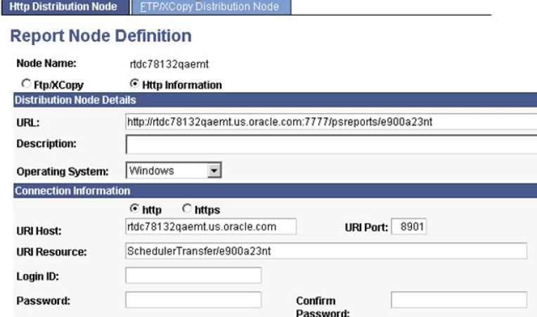

To set the Report Node Definition for a non-SSL implementation, access the Report Node Definition page (PeopleTools, Process Scheduler, Report Nodes):
This example illustrates the fields and controls on the Example of Report Node Definition page setup for a non-SSL implementation. You can find definitions for the fields and controls later on this page.

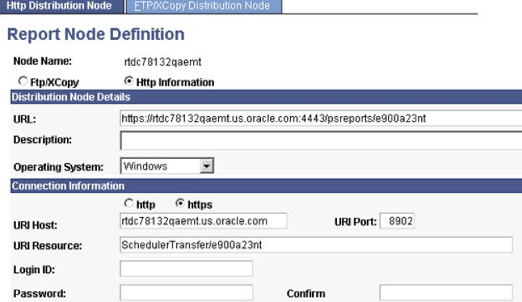

To set the Report Node Definition for an SSL implementation, access the Report Node Definition page (PeopleTools, Process Scheduler, Report Nodes):
This example illustrates the fields and controls on the Example of Report Node Definition page setup for an SSL implementation. You can find definitions for the fields and controls later on this page.

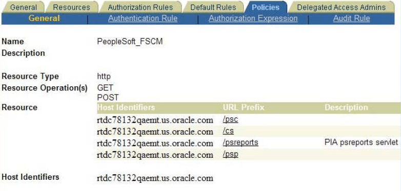

To make the SSO work, the "psreports" servlet needs to be added to the OAM server, just like the other servlets, "psp", "psc", and so on.
This example illustrates the fields and controls on the Policies: Example of psreports servlet added to the OAM server. You can find definitions for the fields and controls later on this page.

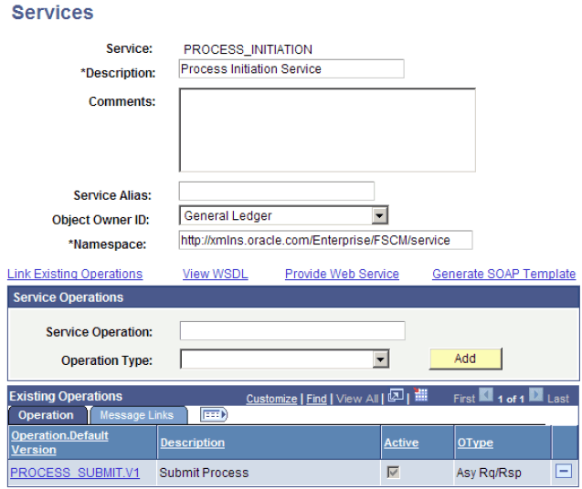

Generate the WSDL for the web service, PROCESS_INITIATION. (Access PeopleTools, Integration Broker, Integration Setup, Services):
This example illustrates the fields and controls on the Services page: PROCESS_INITIATION service. You can find definitions for the fields and controls later on this page.
Click the Provide Web Service link.
Select the Service Operation, PROCESS_SUBMIT.V1.

Click the Next button on Step 2 of 4.
Click the Next button on Step 3 of 4.
Click the Finish button on Step 4 of 4.
Make sure you can open the WSDL URL from any web browser.
Note: If you need to regenerate the WSDL, delete the old one first using the IB Service Administration Utility. (Access PeopleTools, Integration Broker, Service Utilities, Service Administration, WSDL.) Select the service and click the Delete button. Then repeat step 10 to regenerate the WSDL.
See PeopleTools Documentation, Integration Broker Service Operations Monitor.
See PeopleTools Documentation, Integration Broker, Providing Services.
