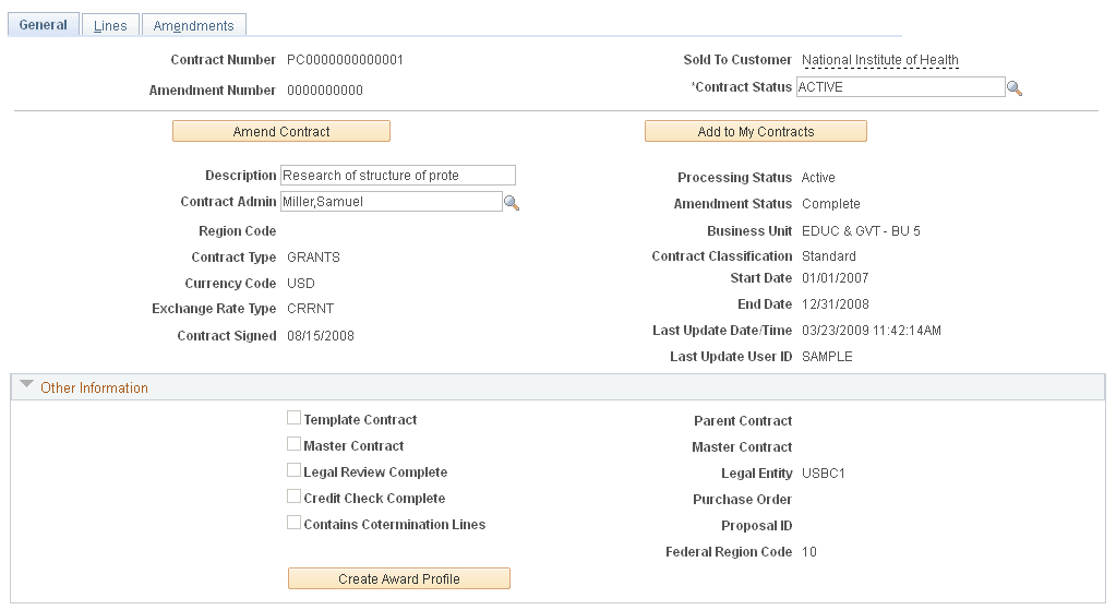

Use the Contract - General page (CA_HDR_PNL) to close out award lines.
Navigation:
This example illustrates the fields and controls on the Contract - General page. You can find definitions for the fields and controls later on this page.
Change the contract status to Closed to indicate that either the contract has been terminated midstream (the status went directly from Pending to Closed or was canceled after processing) or archived (all contractual obligations have been fulfilled and all entitlements received). Contracts that are set to Closed are removed from processing and views, but the historical contract data is still available by query.
Note: For as-incurred billing plans, you must manually change the status on the Billing Plan General page because the system doesn't know when the last transactions have been accumulated in PeopleSoft Project Costing and processed through to PeopleSoft Billing.
For as-incurred revenue recognition (award revenue), you must manually change the revenue recognition plan status to Done because the system does not know when the last transactions were accumulated in PeopleSoft Project Costing and processed through to revenue recognition. If your as-incurred revenue recognition plan has events associated with it, you must wait until all events are complete before you can change the revenue recognition plan status to Done.

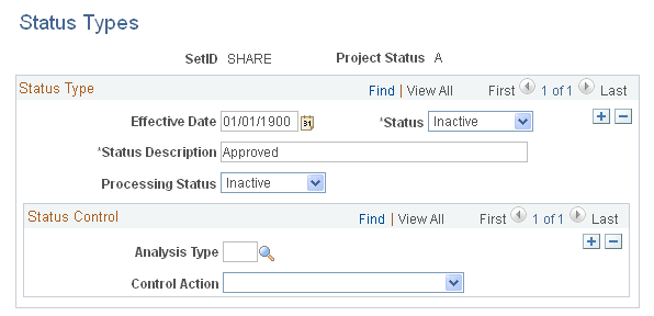

Use the Status Types page (PROJ_STATUS_DEFN) to create status types and set control actions to limit transactions coming into PeopleSoft Project Costing from cost-feeder applications.
Navigation:
This example illustrates the fields and controls on the Status Types page. You can find definitions for the fields and controls later on this page.
You can identify the project statuses that you want to use.
Field or Control |
Description |
Effective Date |
Select the date when the status change goes into effect. Status types are effective-dated, so multiple statuses can be defined and applied sequentially to a project or activity over time. |
Status |
Active appears by default. Select Inactive to deactivate the status control options that are associated with the effective date. |
Processing Status |
Select a system-delivered value of Active, Inactive, or Pending. Each project status also needs to be associated with a processing status in the system. |
Analysis Type |
Select an analysis type to specify the transactions used by a feeder application that you want to exert control over. The analysis type from each feeder application is defined on the Installation Options - Project Costing Integration page. |
Control Action |
Select a value to associate with the analysis type. Values include:
Warning! Status type flags (project control actions) do not prevent feeder system transactions from being posted to PeopleSoft General Ledger because the transactions are already part of the PeopleSoft Financials system. The Reject Project Control action prevents the transaction from being entered in PeopleSoft Project Costing only. |

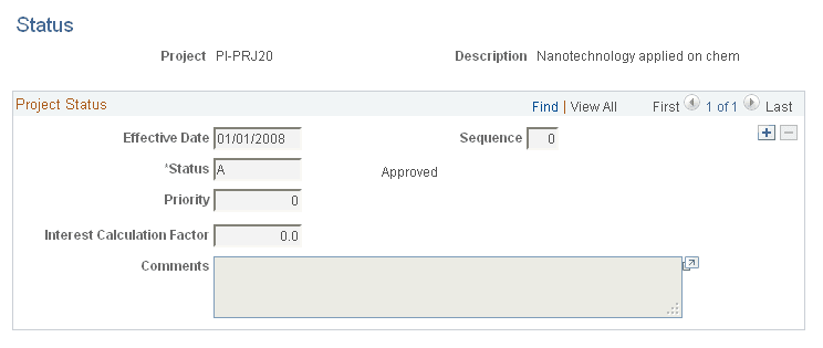

Use the Project - Status page (PROJECT_STATUS) to set the status for a project.
Navigation:
This example illustrates the fields and controls on the Project - Status page. You can find definitions for the fields and controls later on this page.
This page drives the processing status on the Project General page. To activate a project, you add a new row with the status that is listed on the Project Setup page as Active. This is how you activate the project during the Award Generation process with prespending.
To restrict incoming transactions, set the Status field to Closed. A closed project does not appear in prompt lists in PeopleSoft feeder systems.

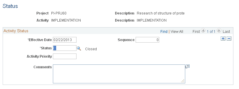

Use the Activity - Status page (PROJECT_ACT_STATUS) to set the status for an activity.
Navigation:
This example illustrates the fields and controls on the Activity - Status page. You can find definitions for the fields and controls later on this page.
To restrict incoming transactions, set the Status field to Closed. A closed activity does not appear in prompt lists in PeopleSoft feeder systems.

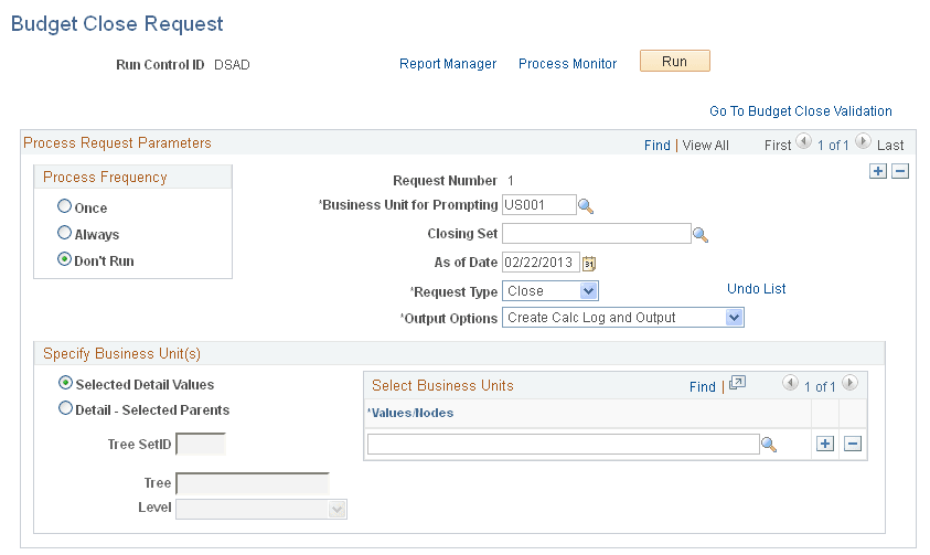

Use the Budget Close Request page (KK_CLOSE_REQUEST) to initiate the Budget Close process.
Navigation:
This example illustrates the fields and controls on the Budget Close Request page. You can find definitions for the fields and controls later on this page.
Instructions for using the Budget Close Request page appear in the PeopleSoft Commitment Control documentation.
