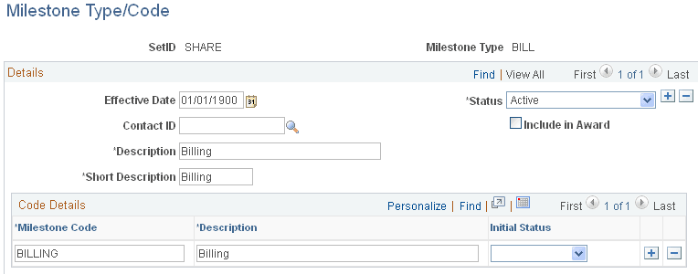

Use the Milestone Types/Code page (GM_MILE_TYPE_DEFN) to define milestone types and codes for a SetID.
Navigation:
This example illustrates the fields and controls on the Milestone Type/Code page. You can find definitions for the fields and controls later on this page.
The milestone type is a label for grouping milestones.
In the Details group box, enter a short and long description of the milestone. In the Code Details group box, enter the milestone code and description. You can define milestone types and codes for a SetID. Define the milestones in this control page so that you can use them within the award profile pages to administer the award. The values that you enter on this page appear on the Look Up page for the Milestone Type and Milestone Code fields on the Award Profile Milestone page.

Milestone Code |
Milestone codes enable you to name the individual milestones that correspond to a specific milestone type. For example, if you create a milestone type of FNREP (financial status reporting), the individual milestone codes could be FINAL or INTERIM. |

Initial Status |
Select the initial status to be assigned to the milestone type when an award is generated. |

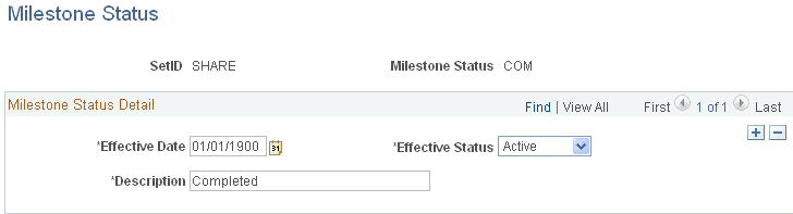

Use the Milestone Status page (GM_MILE_STATUS) to define milestone statuses for a SetID.
Navigation:
This example illustrates the fields and controls on the Milestone Status page. You can find definitions for the fields and controls later on this page.
Enter milestone status details. The milestone status is user configurable. One value, COM (Completed), is system-delivered. Leaving the milestone status blank is allowed.
