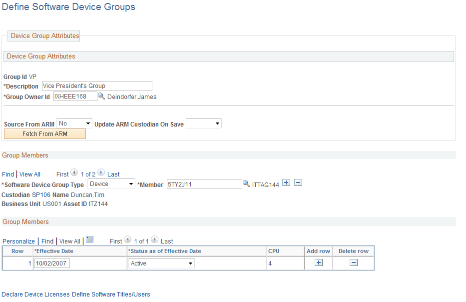

Use the Define Software Device Groups page (IT_SWGRP_DEFN) to define software device groups to associate devices (by Serial ID) to an administrator for the ultimate purpose of linking software licenses to assets rather than users.
Navigation:
This example illustrates the fields and controls on the Define Software Device Groups page. You can find definitions for the fields and controls later on this page.
| Field or Control | Description |
| Group Id | Assign a software device Group Id. |
| Group Owner Id | Select the Employee ID of the device group administrator or content manager. The content manager controls the software contents of the machines in the device group. |
| Source From ARM | Select from the following values:
 Note: If the Asset Custodian field value is changed in the ARM, then the asset will no longer be included in the Software Device Group. The page elements that are visible and active on this page depend upon your selection in this field. If you select Yes to populate the machines from the Asset Repository, the resulting grid is entitled Group Owner's Devices in ARM and the data appears as display-only. If you select No to add your own devices, the resulting grid is entitled Group Members. When accessing a software device group that has a Source From ARM value of Yes, the Group Members grid appears only in Include History or Correct History modes (if there is associated data in the device group). Note: If you change the Source From ARM field from No to Yes, a new effective-dated row for each active group member (groups included) is inserted with an effective date equal to the current date, a Status as of Effective Date equal to Inactive, and a row-level Source From ARM equal to Yes. Even though the row-level values are ignored due to the Device Group's Source From ARM value, the detail rows provide an audit trail showing the effective date that the group definition Source From ARM value was changed to Yes. If you change the Source From ARM field from Yes to No, a new effective-dated row is added in the Group Members grid for all assets of which the Group Owner is the custodian (all devices in the Group Owner's Devices in ARM grid). The Status as of Effective Date will be Inactive, and the Source from ARM will be equal to No. |
| Update ARM Custodian On Save | Select Yes to activate a Component Interface that, upon saving, changes the value of the Custodian field within the Asset Repository to this device group's owner for every Device line in the grid where the current effective dated row is Active. Select No to leave the Custodian field in the ARM unchanged. Note: This field is active only when you select No for the Source from ARM value and there are active devices in the Group Members grid. |
| Fetch From ARM | Click this button to retrieve the assets assigned to this content manager as custodian from the ARM. This is a one-time event and creates a static list. The difference between this and Source from ARM option is that the Source from ARM selection is dynamic and will continue to source from the ARM when the ARM changes. The Fetch from ARM is static and only retrieves the assets from the ARM at the instant it is invoked. You may also start with an empty list and build a Fetch from ARM group selecting asset by asset. The Fetch from ARM button inserts an effective-dated row for all assets of which the group owner is the custodian. . If you want to have assets sourced from the ARM and additional assets not associated with this custodian (content manager), select Fetch from ARM first, then manually add additional assets. Fetch from ARM has no impact on groups that have been added to the device group. Note: This field is active only when you select No for the Source from ARM value. |
| Display Effective Date | Enter an effective date and click the Display button to view the current effective-dated rows as of the date supplied. The default value is the current date. Note: This field appears only when selecting Include History or Correct History. |
|                     | Click this button to view all current effective-dated rows as of the date entered in the Display Effective Date field. Upon clicking the Displaybutton, all data on the page is presented as display-only, the Save button is no longer effective, and all values are consolidated in the same grid. Note: Although this field appears only when selecting Include History or Correct History, it is used for query purposes and not for modifying data. |
Group Members
This grid appears when selecting No as the Source From ARM value. If the Source from ARM check box is deselected within Installation Options in Asset Management/IT Asset Management, this mode will be the default.
| Software Device Group Type | Select the following options for inclusion in the device group:
 It is important to set the device group hierarchy carefully. A device can belong to many device groups; however, a device group can belong to only one parent device group and cannot be repeated in the hierarchy. Edits are in place to prevent a child group from being specified as a parent of its own parent; however, edits do not prevent the assignment of a device group as a parent of its own grandparent device group. This would be detected by the Software Device Monitor batch program and, as a result, processing is suspended until the group hierarchy is corrected. |
| Member and (member description) | Select from a list of existing device group names or Serial IDs (if the asset is from the appropriate IT Subtype in the ARM.) The description is automatically supplied from the appropriate record based on the Group Value selection. If it is a device, the description is the tag number from the Asset table. If it is a Group, then the description from the Software Device Group definition is supplied. |
| Effective Date | Displays the effective date of a given row. When adding a new row, the current date is the default. Note: When a future-dated row is inserted and saved in the Group Members group box, the CPU field is set to zero. Once the future-dated row becomes the current row, the Software Device Monitor batch process updates the CPU field with the value from the asset as of that effective date. |
| Status as of Effective Date | Displays the status of a given device or group member as of the effective date. The values are Active or Inactive. |
| CPU | Displays the value from the Asset Repository CPU field for a device. Click this link to access the Basic Add - Operation/Maintenance page within Asset Management where you may change the CPU value, which updates the value in the ARM CPU field. Note: If you change the CPU field on the Basic Add - Operation/Maintenance page, a new effective-dated row is added within the Software Device Group definition for every group to which the device belongs and is currently active. |
| Source From ARM | Visible only in Include History or Correct History modes, this field provides an audit trail of the group Source From ARM state at a given time. When you change the header level Source From ARM value, a detail row is added to the Group Members group box to reflect the Source From ARM change with the effective date of the change. For new rows, the default value of this field is No. |
| Empl ID and Name | Displays the Employee ID and corresponding name of the group owner if the selection is a group. If the selection is a device, this column displays the Employee ID and name of the custodian within the asset repository. Click this link to access the Employee Detail page for more information. |
This grid appears when selecting Yes as the Source From ARMvalue. If the Source Device Groups from ARM check box is deselected within Installation Options in Asset Management/IT Asset Management, this mode is not available. When the Source Device Groups from ARM check box is selected in the Installation Options, it sets the default value of the Source from ARM flag when adding a device group. The default can be overridden.
| Serial ID, Tag Number, CPU, Empl ID | These fields are display-only and are populated from the information found within the Asset Repository. Click the Empl ID link to access the Employee Detail page for more information. |
