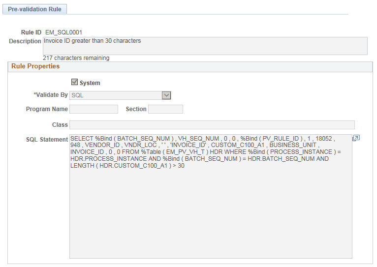

Use the Pre-validation Rule page (EM_PV_RULE) to review the system-delivered pre-validation rules and to create a new pre-validation rule.

This example illustrates the fields and controls on the Pre-validation Rule page. You can find definitions for the fields and controls later on this page.
Field or Control |
Description |
Rule ID |
Displays the rule ID. |
Description |
Displays a description of what the rule does. |
Rule Properties
Field or Control |
Description |
System |
If checked, indicates that the rule is system-defined and you cannot edit any field for the rule. If unchecked, the rule is user-defined and you can make changes to specific fields based on the Valid By field option selected. |
Validate By |
Displays the way in which the invoices are validated:

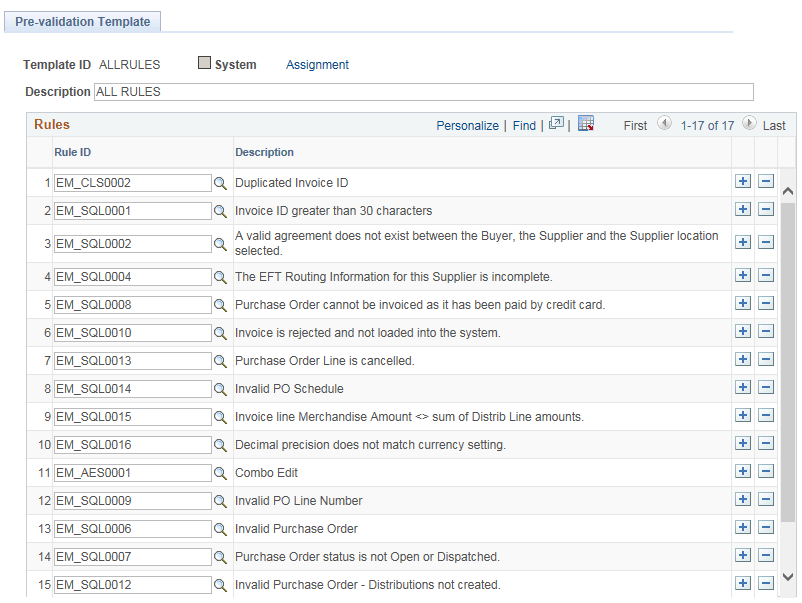

Use the Pre-validation Template page (EM_PV_TMPL) to view and update the pre-validation template with rules for Supplier assignment.
Navigation:
This example illustrates the fields and controls on the Pre-validation Template page. You can find definitions for the fields and controls later on this page.
When you are creating a pre-validation template, the system populates all the system-defined rules. You can choose to select and remove the rules not required and include new ones.
Note: The system automatically includes the system-defined rule EM_CLS0001 (ExecuteEdits) whenever a Pre-validation template is executed. This rule acts as a prerequisite to the rest of the rules being executed.

Rule ID |
Displays the rule ID associated with this template. You can select from a list of rules which include system-defined as well as user-defined ones. |
Template ID |
Displays the template ID. |
System |
If checked, means that all rules listed in the template are system-defined and you can only view and not edit them. If unchecked, you can edit the rule rows by selecting desired rule IDs. |

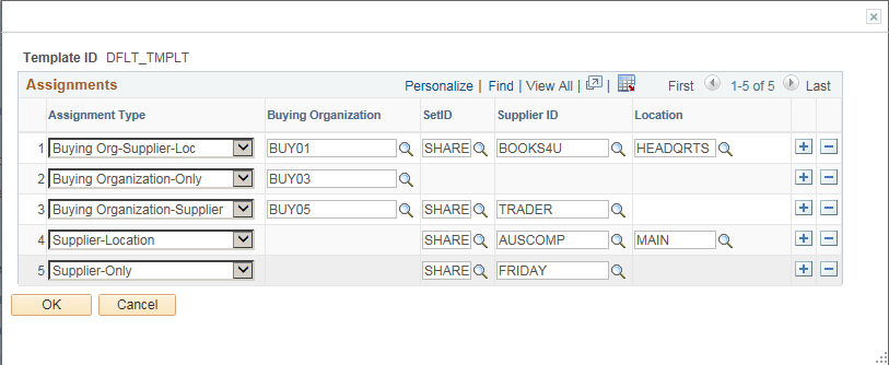

Use the Assignment page (EM_PV_TMPL_ASSIGN) to assign the pre-validation template and its associated rules to one or more Suppliers or Buying Organizations.
Navigation:
Click the Assignment link on the Pre-validation Template page.
This example illustrates the fields and controls on the Assignment page. You can find definitions for the fields and controls later on this page.
Pre-validation process applies the rules associated with the template that is assigned to a Buying Organization, a Supplier, or a combination of both. The fields on the Assignment page are available to enter values based on the Assignment Type you select while making assignments with the pre-validation template.
For the example shown in the above page, in the first row the Pre-validation template is assigned to the Buying Organization BUY01 for Supplier BOOKS4U at the Location HEADQRTS, and in the next row the template is assigned to only the Buying Organization BUY03 .

Assignment Type |
Select the type of assignment for the pre-validation template:
Note: Only one template can be assigned to a Buying Organization or a Supplier for a given combination of fields associated to the Assignment Type selected. |

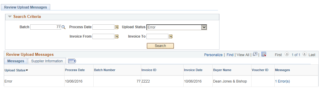

Use the Review Upload Message page (EM_PV_QUERY) to review the upload messages resulting from the Pre-validation process.
Navigation:
Click the Message link for a Supplier.
This example illustrates the fields and controls on the Review Upload Message page. You can find definitions for the fields and controls later on this page.
Search the upload messages by batch, process date, upload status, or by invoice dates. To view all messages leave all fields blank and click Search.

Upload Status |
Displays whether the status of the invoice upload is success or in error. |
Messages |
Displays the number of error messages with a link. Click the link to open the error message in a new page and review the details of the error – rule ID, line, distribution, field, value, and an error message about resolving the error. |
