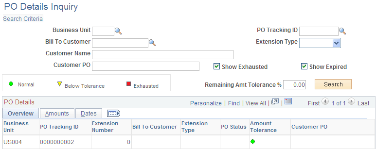

Use the PO (Purchase Order) Details Inquiry page (FO_PO_INQ_EXT) to view PO extension information.
You can filter information based on search criteria.
Navigation:
Click the PO Details button on the Purchase Order Inquiry page.
This example illustrates the fields and controls on the PO Details Inquiry page. You can find definitions for the fields and controls later on this page.
These fields apply to PO extensions instead of an entire PO.
Field or Control |
Description |
Extension Type |
Select a value to filter your PO extension search to PO numbers with a specific extension type. Values include: Customer or Internal. |
Overview
Field or Control |
Description |
PO Tracking ID |
Click to access the PO Entry page for a specific PO tracking number. |
Extension Type |
Displays the extension type. Values are: Customer or Internal. |
PO Status |
Displays the status of the PO tracking number associated with this extension. Values include: New, Active, Expired, or Exhausted. |
Amount Tolerance |
Displays a symbol alerting you to the amount tolerance status for this extension. Note: For an extension, you can view only amount tolerances. Date tolerances do not apply to extensions. |
Customer PO |
Displays the customer's PO reference number related to this extension. |
Amounts
Field or Control |
Description |
Entered |
Displays the total amount entered for this extension on the History page. |
Amount Tolerance |
Displays a symbol alerting you to the amount tolerance status for this extension. |
PO Applied Transactions |
Click to access the PO Applied Transactions page. |
Dates
Field or Control |
Description |
Exhaustion Date |
Displays the date on which you depleted the PO balance. |
