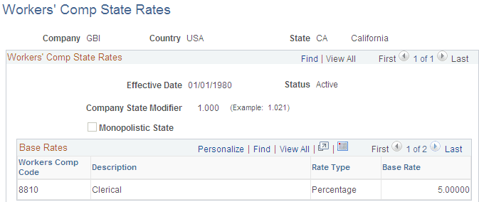

Use the Workers' Comp State Rates (workers' compensation state rates) page (FO_WC_CO_STATE) to set up the rates that you pay for each workers' compensation code.
Rates are entered for a specific company, country, and state. The system uses this rate during the Workers Compensation Premium Calculation program. It also uses this rate in the margin calculation to determine optimal pay and bill rates for an order and assignment. The system also uses these rates to create accounting journal entries.
Navigation:
HCM database
This example illustrates the fields and controls on the Workers' Comp State Rates page. You can find definitions for the fields and controls later on this page.
Field or Control |
Description |
Status |
Select Active or Inactive. |
Company State Modifier |
If you have a company factor to be applied to premiums in this state, enter the value here. This value overrides the company modifier. |
Monopolistic State |
Select to override the modifier with a value of 1. This results in the modifier having no effect on the workers' compensation calculation. |
Expense Account |
Select the general ledger account for the system to use in journal entries for workers' compensation premium expenses. Note: This field applies only when PeopleSoft Pay/Bill Management is installed. |
Liability Account |
Select the general ledger account for the system to use in journal entries for workers' compensation premium liabilities. Note: This field applies only when PeopleSoft Pay/Bill Management is installed. |
Base Rates
Field or Control |
Description |
Workers' Comp Code |
Select a workers' compensation code for this state. The system displays the associated description for the code. |
Rate Type |
Select a rate type: Per Hour or Percentage. |
Base Rate |
Enter a base workers' compensation rate. For percentage rate types, enter the rate as a number (not percent). For example, for a rate of 3.5 percent, enter 3.5 in the rate field. For per hour rate types, enter the amount to be applied per hour in decimal format. For example, for a rate of 3.5 percent per hour, enter 0.035 in the rate field. |
