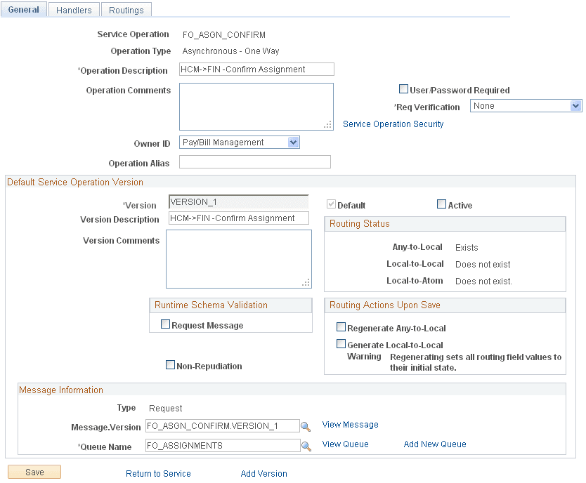

Select , Integration Broker, Integration Setup, Service Operations.
Select the General tab.
This example illustrates the fields and controls on the Service Operations page — General tab. You can find definitions for the fields and controls later on this page.
Select the Activecheck box to Activate the Service Operation flag.
Select Save.

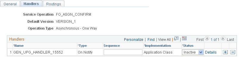

Select the Handlers tab.
This example illustrates the fields and controls on the Service Operations page — Handlers tab. You can find definitions for the fields and controls later on this page.
Set the Status of the desired Handler to Active.
Select Save.
Note: Activating Handlers are only necessary on the subscribing environment. E.g. Service Operation PERSON_BASIC_SYNC is published from HCM and subscribed in FSCM. So, in FSCM, there's the need to activate the Handler for this Service Operation. Not needed in HCM though, which is the publishing node.

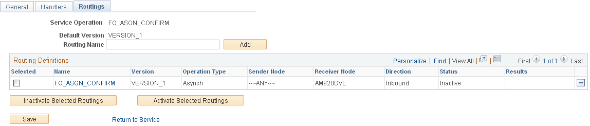

For the Service Operations marked with (*) in the list of Available Service Operations for Staffing, you will need to define which is the publishing node and which is the subscribing node. Handlers need to be activated on the subscribing node only.
Select the Routings tab.
This example illustrates the fields and controls on the Service Operations page — Routings tab. You can find definitions for the fields and controls later on this page.
Set the Status of the desired Routing to Active.
Click Save.

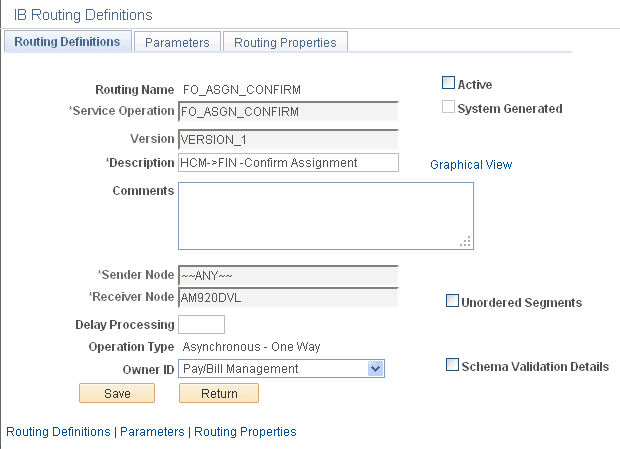

To setup the Service Operation Routing click on the link of the desired routing and enter the routing data.
Note: Setting up routings is only required if the routing requires transformation or it is a new routing.
To setup a new Service Operation Routing enter a new Routing Name and click Add. Then enter the routing data.
This example illustrates the fields and controls on the Service Operations - IB Routing Definitions page. You can find definitions for the fields and controls later on this page.

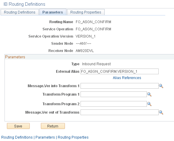

To enter Service Operation Routing Parameters, such as transformation information, select the Parameters tab.
This example illustrates the fields and controls on the Service Operations - IB Routing Definitions - Page. You can find definitions for the fields and controls later on this page.
Click Save.
