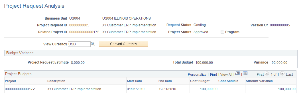

Use the Project Request Analysis page (PGM_PRJRQ_ANALYSIS) to compare the project request estimate to the associated program or project budget.
Navigation:
This example illustrates the fields and controls on the Project Request Analysis page. You can find definitions for the fields and controls later on this page.
Field or Control |
Description |
Project Request ID |
Displays the project request ID of the project whose business case estimate is compared to the program or project budget. |
Request Status |
Displays the current status of the project request. |
Version Of |
Displays the version of the project request. |
Related Project ID |
Displays the project identifier for the corresponding project request. |
Program |
Indicates whether the project is a program. If the box is selected, the project is a program. |
View Currency |
Enter the currency in which to view the budget variance, cost budget, and cost actuals. You must click the Convert Currency button to change the amounts. The default value is the project business unit currency. |
Convert Currency |
Click to restate all of the budget amounts in the currency that you specified in the View Currency field. |
Budget Variance
Field or Control |
Description |
Project Request Estimate |
Displays the total estimated cost from the Project Request page |
Total Budget |
Displays the total active program or project budget. If a program has an active budget and the child projects under it have active budgets, then the program budget is the total budget. If the program does not have an active budget, and the child projects under it have active budgets, then the total budget is the roll up of the active child project budgets under the program. |
Variance |
Displays the difference between the project request estimate and total budget. |
Program Budgets
Field or Control |
Description |
Project Name |
Displays the child program or project descriptions. |
Cost Budget |
Displays the active program or project budget. |
Cost Actuals |
Displays the actual costs for the projects under the program. |
Amount Variance |
Displays the difference between the cost budget and cost actuals amounts. |
