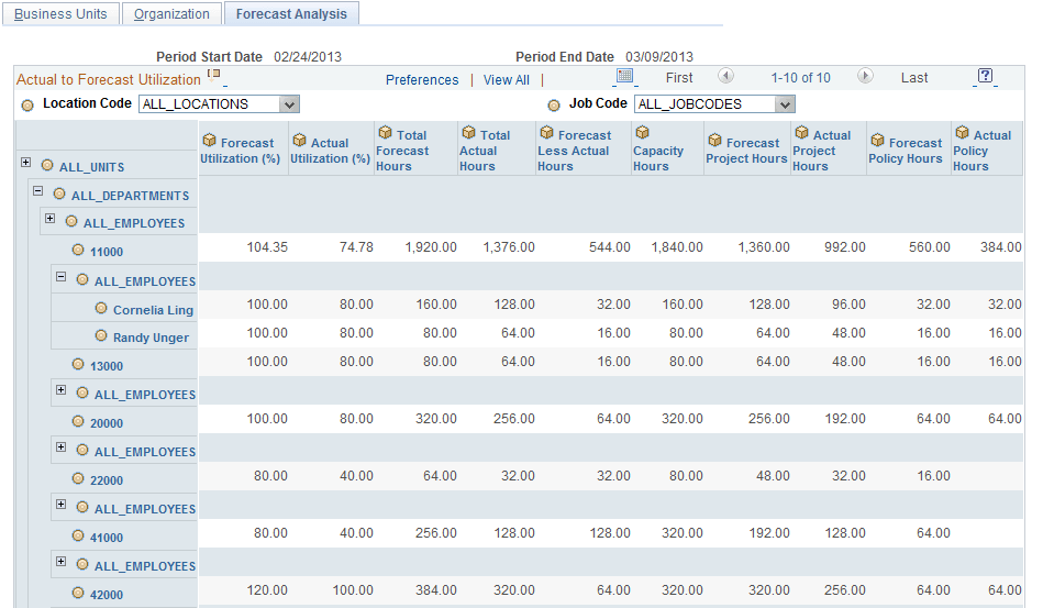

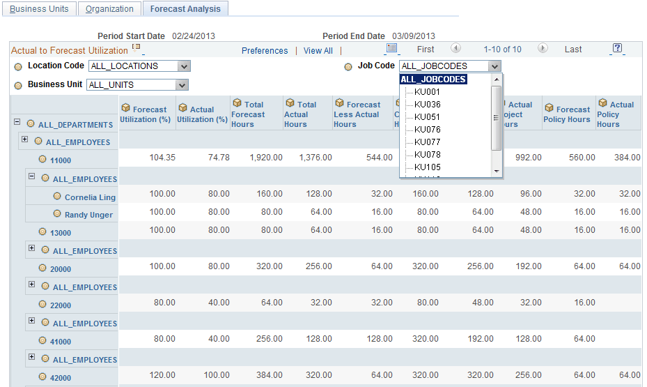

These are two examples of report views:
This example illustrates the fields and controls on the Example of Actual to Forecast Utilization interactive report by business unit, department, and employee. You can find definitions for the fields and controls later on this page.
This example illustrates the fields and controls on the Example of Actual to Forecast Utilization interactive report by department and job code showing list of job code options. You can find definitions for the fields and controls later on this page.

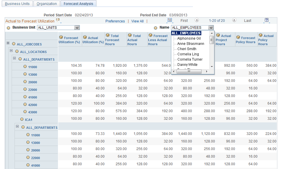

Use the Forecast Analysis page to analyze actual to forecast utilization
Navigation:
Select the Organization Units tab on the Utilization Parameters - Business Units page.
Select Actual to Forecast Utilization on the Utilization Parameters - Organization Units page.

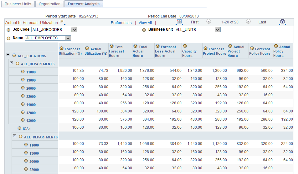

This example illustrates the fields and controls on the Example of Forecast Utilization interactive report by location and department. You can find definitions for the fields and controls later on this page.
This example illustrates the fields and controls on the Example of Forecast Utilization interactive report by location and job code, showing list of employees. You can find definitions for the fields and controls later on this page.
