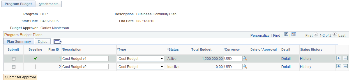

Use the Program Budget page (PGM_BUD_PLAN) to enter or view cost and revenue budget versions at the program level.
Navigation:
This example illustrates the fields and controls on the Program Budget page. You can find definitions for the fields and controls later on this page.

Program Budget Plans - Plan Summary
This tab displays summary budget plan information
Field or Control |
Description |
Submit |
Select to indicate which row to submit for program budget plan approval. This column appears only when program budgeting workflow is enabled. |
Baseline |
Indicates which plan is currently marked as the baseline. Click the Baseline button on the Date tab to select this option. One cost budget plan and one revenue budget plan may be designated as the baseline. |
Plan ID |
Displays a unique version of the program budget. The system automatically numbers this display-only field. |
Type |
Select Cost or Revenue to identify whether the budget plan is for cost or revenue amounts. |
Status |
Displays the status of the budget. Only one cost budget plan and one revenue budget plan can be active at one time. If program budget workflow is enabled, this field is display-only. If program budget workflow is not enabled, you can select Active or Inactive. |
Total Budget |
Displays the total budget entered for the budget plan. The system derives this value from the budget details associated with the plan, and this field is display-only. |
Date of Approval |
Display the date that the budget plan was approved. This field is display-only and appears only if program budget workflow is enabled. |
Detail |
Click to access the budget details for the associated budget plan. This link does not appear until you enter a description on the plan line and save. |
History |
Click to access the status history page for the associated budget plan. This link appears only if program budget workflow is enabled. |
