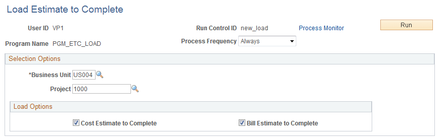

Use the Load Estimate to Complete page ( RUN_PGM_ETC_LOAD) to run the Load Estimate to Complete application engine to load the estimate to complete transactions into the Project Transactions table.
Navigation:
This example illustrates the fields and controls on the Load Estimate to Complete page. You can find definitions for the fields and controls later on this page.
Field or Control |
Description |
Business Unit |
Enter the business unit for which to calculate the estimated remaining cost or billing amounts. |
Project |
Enter the project ID to run this process for only one project. You can only choose from active projects. |
Cost Estimate to Complete |
Select to enable the process to reload the rows with the analysis type of ETC in the Project Transaction table. |
Bill Estimate to Complete |
Select to enable the process to reload the rows with the analysis type of ETB in the Project Transaction table. |
