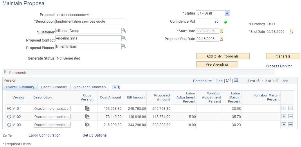

Use the Maintain Proposal page (GM_OPPTY_HDR) to enter general proposal information.
Navigation:
Proposal Management, Proposal Management Center, Proposal Management, Maintain Proposal
This example illustrates the fields and controls on the Maintain Proposal page. You can find definitions for the fields and controls later on this page.
Note: For proposals that you initiated from PeopleSoft Customer Relationship Management (CRM), the Status field on this page is view-only. The system displays the Ready button when the proposal is in Draft status. Click this button to change the proposal status to Ready and launch an enterprise integration point (EIP) that updates the status in PeopleSoft CRM. All other status changes are prompted by an EIP.
Field or Control |
Description |
Proposal |
This is a display-only field. When you add a new proposal, the system displays NEXT. This automatically generates a system-assigned ID when you save the proposal. The system-assigned ID is derived from the Contracts table and remains the same throughout the Contract Generation process so that both the proposal and the contract in PeopleSoft Contracts have the same ID. After you run the Generate process, the system turns this field into a link that enables you to access the contract on the Contract - General page in PeopleSoft Contracts. |
Status |
Select a value to specify the state of the proposal. Options are:
Confidence Pct (confidence percentage) |
Enter a number between 1 and 100 to reflect your level of confidence that the proposal will be approved. The proposal planner usually enters or provides this number. The system translates the number that you enter here into a color-coded icon that represents the confidence level as either high, medium, or low. You determine confidence levels on the Contracts Business Unit - Confidence Level Setup page. The colored icon next to this field indicates the confidence level of this proposal. |
Indicates a low confidence level. |
Indicates a medium confidence level. |
Indicates a high confidence level. |
Currency |
Select the currency to use in financial transactions if the proposal results in a contract. This code defaults from the Currency Code field that you selected on the Contracts BU Definition page during implementation. |
Customer |
Select the customer for whom you are creating the proposal. |
Start Date and End Date |
Select the estimated start and end dates of the project that you are proposing. |
Proposal Contact |
Select the person who is the contact for the proposal. |
Proposal Due |
Select the date on which the proposal is due for completion by the proposal planner. This date must be less than the proposal target date. |
Proposal Planner |
Select the name of the person who is drafting or planning the proposal. |
Generate Status |
Displays a status based on the processes that you have run, either Pre-Spending or Contract Generation. Values are:
Add to My Proposals |
Click to add the proposal to the My Proposal page. |
Pre-Spending |
Click to initiate the Pre-Spending process. The Pre-Spending process creates the selected projects in PeopleSoft Project Costing with a project status of Approved and a processing status of Active. The system also creates the corresponding activities. The system also displays a green check mark next to the version that you selected for pre-spending. The Pre-Spending process does not create a contract or generate any budget lines. When you run the Generate process, the system creates the contract and adds new activities with the appropriate dollar amounts. Note: The Pre-Spending process creates Project IDs and activities; it does not generate any budget lines or any contract entities. |
Generate |
Click to generate a contract from the information that is entered on the proposal for the selected version. The system creates projects in PeopleSoft Project Costing based on the information that you enter on the Resource Estimate and Maintain Version Estimate Detail pages. The system also displays a green check mark next to the version that you selected for pre-spending. |
Comments
Field or Control |
Description |
Type |
Select the type of comment that you want to enter. Options are: Assumptions, Deliverables, Dependencies, Goals, Notes, Objectives, Purpose, or Risks. You can add each comment type only once. |
Description |
Enter the text of your comment. To add another comment, add a new row. |
Version: Overall Summary Tab
Field or Control |
Description |
Version |
Displays the versions associated with the proposal. You can select only one version for approval and eventually generate it into a contract. Click the version link to access the Resource Estimate page to view, add, or modify project information. |
Click the Copy Version Information to New Version button to access the Copy Version page and copy the information to a new proposal version within the same proposal. |
Cost Amount, Bill Amount, and Proposed Amount |
Displays the total cost, total billing amount, and total amount that you propose to charge for both labor and non-labor for the proposal version, after adjustments. |
Labor Adjustment Percent |
Displays the percent amount that you entered in the Adjustment Percent field on the Labor Summary tab for overall time adjustments. This number applies to all activities that are included in the proposal version for labor detail lines only. It can be either a positive or a negative percentage. |
Nonlabor Adjustment Percent |
Displays the percent amount that you entered in the Adjustment Percent field on the Non-labor Summary tab for overall expense adjustments. This number applies to all activities that are included in the proposal version for non-labor detail lines only. It can be either a positive or a negative percentage. |
Labor Margin Percent |
Displays as a percentage the difference between the proposed amount and the cost amount for labor (Proposed Amount − Cost Amount) ÷ Proposed Amount. |
Nonlabor Margin Percent |
Displays as a percentage the difference between the proposed amount and the cost amount for non-labor expenses (Proposed Amount − Cost Amount) ÷ Proposed Amount. |
