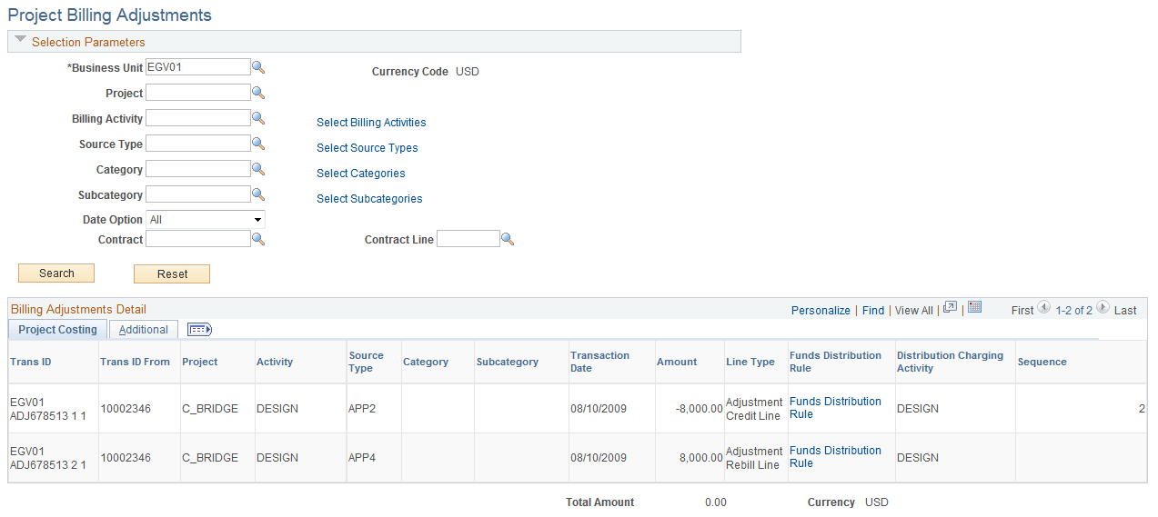

Use the Project Billing Adjustments page (PC_FND_UNAPPL_BAJ) to view Billing adjustments.
Navigation:
This example illustrates the fields and controls on the Project Billing Adjustments page. You can find definitions for the fields and controls later on this page.
Use this page to view credits, credit and rebills, net adjustments, and ChartField changes that are made from the PeopleSoft Billing - Invoice Maintenance component.
In the Selection Parameters section, you can enter up to 20 selections for the Billing Activity,Source Type,Category, and Subcategory fields.

If an adjustment is made to project-related invoices in PeopleSoft Billing, then the adjustment is not automatically reflected in the Threshold Amount and Distributed Amount fields for the corresponding funds distribution rule.
To ensure that the funded (threshold) and distributed amounts reflect these adjustments on the Funds Distribution Report, you must create an adjustment sequence on the Funds Distribution - Target page. The adjustment sequence allows you to enter a distributed and threshold amount that reflects the net effect of adjustments displayed on the Project Billing Adjustments page. To do this, follow these steps:
Create a new sequence on the Funds Distribution - Target page and select the Adjustment check box.
Enter the same ChartFields as the billing adjustments for which you are entering the adjustment sequence on the Funds Distribution - Target page.
When the Funds Distribution Report calculates funded and distributed amounts for a project, it includes the adjustment sequences that have matching ChartFields. In this way, report totals reflect any adjustments that are made in Billing.
For example, an invoice that has five lines of 20 USD each (5 × 20 = 100) is finalized with incorrect source type (appropriation) values. You use the Billing - Invoice Maintenance page to issue a credit and rebill the invoice. The system sends these adjustments to Project Costing, and they appear on the Project Billing Adjustments page. Create an adjustment sequence for the appropriate funds distribution rule containing two rows:
The first row, for –100 USD, is the adjustment for the credit.
This row references the incorrect source type as shown on the credit adjustment lines on the Project Billing Adjustments page.
The second row, for 100 USD, is the adjustment for the rebill.
This row references the correct source type as shown on the rebill adjustment lines on the Project Billing Adjustments page.
Note: Rows that are entered as an adjustment sequence are not stored on the Project Transaction table (PROJ_RESOURCE). Their only purpose is to adjust funded (threshold) and distributed amounts for adjustments that are entered in Billing.
