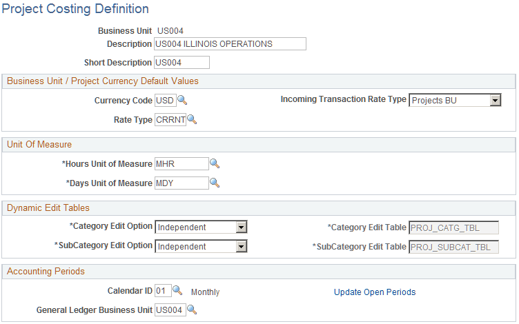

Use the Project Costing Definition page (BUS_UNIT_TBL_PC) to create, define, and modify project business units.
Navigation:
This example illustrates the fields and controls on the Project Costing Definition page.
Note: Create business unit IDs that are exactly five characters long. Depending on the operating system, performance degradation can occur if business unit IDs have fewer than five characters.

Business Unit / Project Currency Default Values

Currency Code |
Enter the base currency for this business unit. This field serves two purposes. First, for all new projects created for this business unit, this currency code becomes the default currency code for the newly created project. You can override this default value during project creation. Second, this value is the base currency for the business unit. For all transactions that are stored in the Project Transaction table (PROJ_RESOURCE), the system stores two amounts. The Project Transaction table stores the source transaction amount (the foreign amount) and then converts this amount to the base currency identified at the project business unit level. A project's currency code can differ from the project business unit's base currency. Currency codes are defined on the Currency Code page. See Maintaining Currency Tables. |

Unit of Measure
Use this group box to define default values that are used for analysis and PeopleSoft Program Management scheduling. The system uses these fields to convert all units of measure into hours or days.

Hours Unit of Measure |
Enter the unit of measure that represents hours for the organization. Units of measure are defined on the Units of Measure page. The default value is MHR (Work Hour). |
Days Unit of Measure |
Enter the unit of measure that represents days for the organization. The default value is MDY (Person Day). |
Dynamic Edit Tables

Category Edit Option |
Specify whether category prompt lists display all values that are in the system, or a subset based on dependencies that are established among source types, categories, and subcategories. Available options are: Independnt (independent): All categories that are in the system are available for selection. Project Costing uses the Project Resource Category record (PROJ_CATG_TBL) to populate prompt lists. Override: Categories that are available for selection are restricted by established criteria. Project Costing uses the selected category edit table to populate prompt lists. Related: Categories that are available for selection are restricted by predefined relationships with source types. Project Costing uses the Project Type Category record (PROJ_TYPE_CATVW) to populate prompt lists. You can select the Related option only if the Source Type ChartField is selected on the Standard ChartField Configuration page. If you select Related and Source Type ChartField is inactive, an error message appears when you save the page, indicating that you cannot specify a Category Edit Option of Related because the Source Type ChartField is inactive. Available category edit options are based on the translate values in the Category Edit Options field (CAT_EDIT_OPTION) properties. The default value is Independnt. |
SubCategory Edit Options |
Specify whether subcategory prompt lists display all values that are in the system, or a subset based on dependencies that are established among source types, categories, and subcategories. Values are: Independnt (independent): All subcategories that are in the system are available for selection. Project Costing uses the Project Resource SubCategory record (PROJ_SUBCAT_TBL) to populate prompt lists. Override: Subcategories that are available for selection are restricted by established criteria. Project Costing uses the selected subcategory edit table to populate prompt lists. Related: Subcategories that are available for selection are restricted by predefined relationships with resource category types. Project Costing uses the Project Category SubCategory record (PROJ_CAT_SUB_VW) to populate prompt lists. You can select the Related option only if the Category ChartField is selected on the Standard ChartField Configuration page. If you select Related and the Category ChartField is inactive, an error message appears when you save the page, indicating that you cannot specify a SubCategory Edit Option of Related because the Category ChartField is inactive. Available values are based on the translate values in the SubCategory Edit Options field (SUB_EDIT_OPTION) properties. The default value is Independnt. |
Accounting Periods

Calendar ID |
After you create the business unit, select the calendar that is used for such things as open period accounting and allocations from the Project Transaction table. |
Update Open Periods |
Click to access the Open Period Update page in a new browser window in PeopleSoft General Ledger to modify project source transaction settings for open period validation. You must create the business unit before you can access the Open Period Update page. Close the new browser window to return to the Project Costing Definition page. |
General Ledger Business Unit |
If open period control is enabled on the Installation Options - Project Costing page, enter the GL business unit for the selected calendar ID that the system uses to validate accounting dates. You must select a calendar ID before you select a general ledger business unit. If open period is enabled and the open period source is Projects, when you select the calendar ID and associated GL business unit, the system creates a row in the Open Periods by Products table (FIN_OPEN_PERIOD) and Business Unit Mapping table (FIN_BU_MAPPING). This enables you to update the project calendar for open period control. See Defining and Updating Open Periods and Adjustment Periods. |
