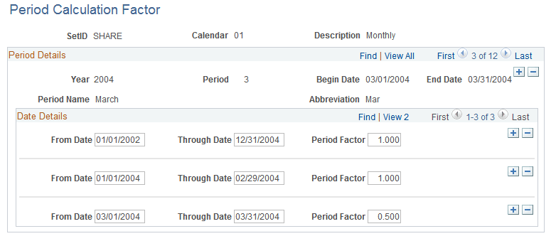

Using the Straight Average method, the project cost accumulation calculations for March, 2004 are:
(1,027,500 + 1,040,900) ÷ 2 = 1,034,200
The following page illustrates period calculation factors that are set up for the Straight Average example just discussed. The last period, March, is assigned a value of 0.5 (50 percent) to reflect the assumption that half of the costs were incurred in the first half of the month, and the other half were incurred in the last half of the month.
This example illustrates the fields and controls on the Example of the Period Calculation Factor page with Straight Average method. You can find definitions for the fields and controls later on this page.

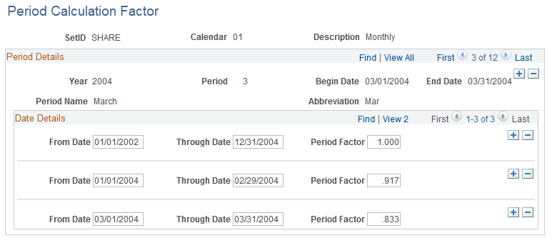

Using the FASB 34 method, the project cost accumulation calculations for March 2005 (using the example above) are:
((1,000,000 + 12,000 × 12 ÷ 12) + (15,500 × 11 ÷ 12) + (13,400 × 10 ÷ 12)) = 1,037,375
The following page illustrates period calculation factors that are set up for the FASB 34 example just discussed:
This example illustrates the fields and controls on the Example of the Period Calculation Factor page with FASB 34 method. You can find definitions for the fields and controls later on this page.
