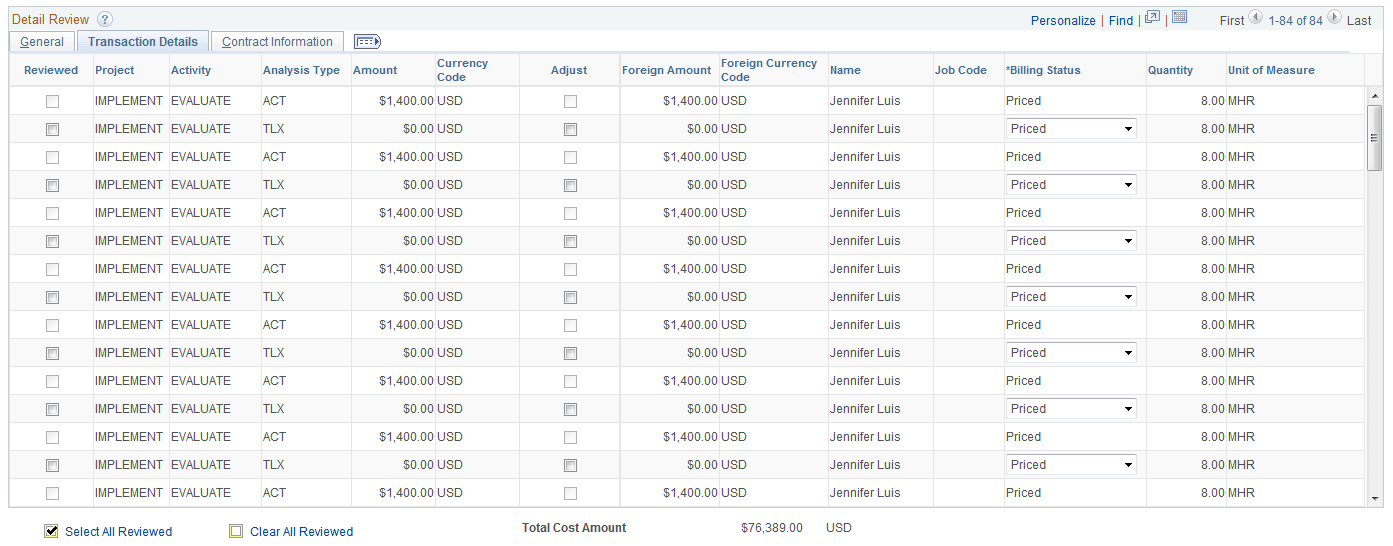

Manager Transaction Review - Cost Review: Transaction Details tab
Select the Transaction Details tab.
This example illustrates the fields and controls on the Cost Review page: Transaction Detail tab. You can find definitions for the fields and controls later on this page.
Field or Control |
Description |
Currency Code, Foreign Amount, and Foreign Currency Code |
If you use PeopleSoft Project Costing in a multicurrency environment, each line reflects the original currency amount in the Foreign Amount field (FOREIGN_AMOUNT), and the converted currency in the Amount field (RESOURCE_AMOUNT). The converted currency is based on the currency code defined at the project business unit level. |
Billing Status |
Select a billing distribution status of Billable or Nonbillable. This field is not available for selection if any of the following situations exist:

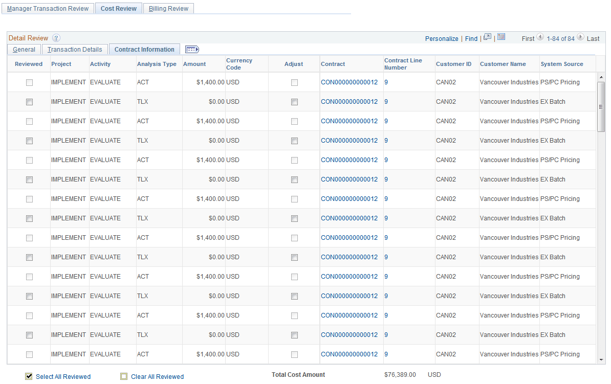

Manager Transaction Review - Cost Review: Contract Information tab
Select the Contract Information tab.
This example illustrates the fields and controls on the Manager Transaction Review - Cost Review: Contract Information tab.
Field or Control |
Description |
Contract and Contract Line Number |
View contract and contract line number for a particular project. Click on individual contract number or line to view or edit the respective contract details. |
This page displays the analysis type, amount, and source for each activity. Contract information that is associated with each transaction appears on the page if you use the PeopleSoft Contracts application.

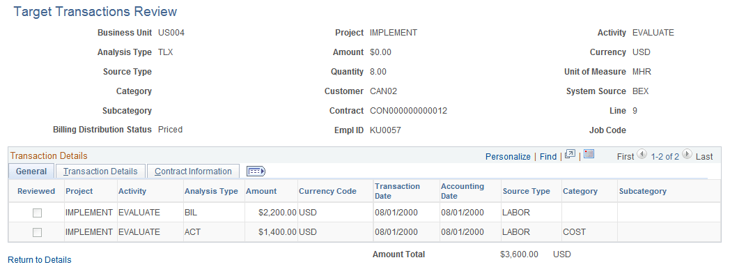

Use the Target Transactions Review page (PC_PM_TARGET) to review detailed project cost transaction information in a consolidated format.
Navigation:
Click the Target link on the Cost Review page General grid if you selected a View Type of Detail on the Manager Transaction Review page.
Click the Target link on the Summary Details Review page.
This example illustrates the fields and controls on the Target Transactions Review page. You can find definitions for the fields and controls later on this page.
Review detailed project cost transaction information in a consolidated format. This page is available only for detail transaction rows, and contains all transaction fields from the target transaction in a read-only format.

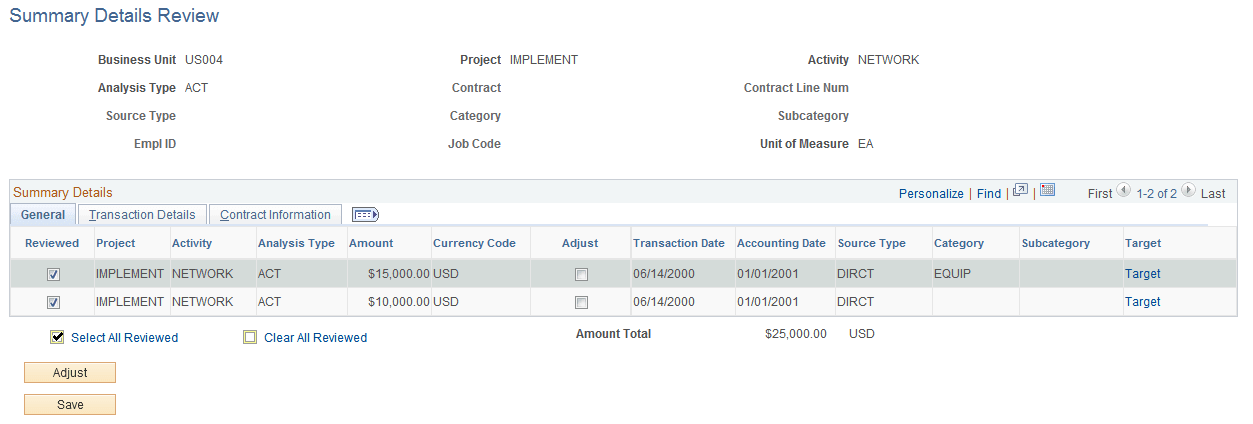

Use the Summary Details Review page (PC_PM_SUMDTL) to review summarized project cost transactions.
Navigation:
Click the Details link in the Summary Review grid on the Cost Review page if you selected a View Type of Summary on the Manager Transaction Review page.
This example illustrates the fields and controls on the Summary Details Review page. You can find definitions for the fields and controls later on this page.
This page is available only for summary transaction rows. Project managers that search for transactions by using the Summary view type on the Manager Transaction Review page use this page to adjust individual transactions or mark them as reviewed.
Project managers that search for transactions by using the Detail view type on the Manager Transaction Review page use the Cost Review page to adjust individual transactions or mark them as reviewed.
You can select Deferred check box to process required transactions at a later date by updating the billing date. This check box is available only for billing and period of performance data.
In this page the Source and Target columns are displayed based on the navigation followed to access this page. If you access the Summary page from Cost Review then only the Target column is displayed. If you access it from Billing Review then only the Source column is displayed. If you access the page from Period of Performance Review then both the Source and Target columns are displayed.

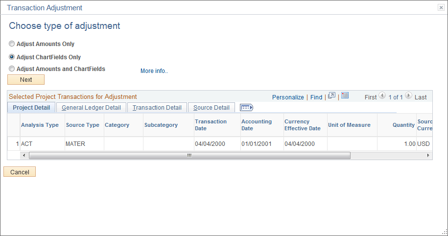

Use the Choose type of adjustment page (PROJ_RES_ADJ_TYPE) to adjust the cost of a transaction during the review process.
Navigation:
Select a transaction row in the Adjust column on the Cost Review page and click the Adjust button.
Select a transaction row in the Adjust column on the Summary Details Review page and click the Adjust button.
. Select a transaction row on the Transaction Adjustment page and click the Next button.
This example illustrates the fields and controls on the Choose type of adjustment page (from the Manager Transaction Review page). You can find definitions for the fields and controls later on this page.
Transactions that you select for adjustment appear on this page. You can adjust only detail transactions with analysis types that belong to the Transaction Adjustment analysis group (ADJST). You cannot adjust summary transactions.

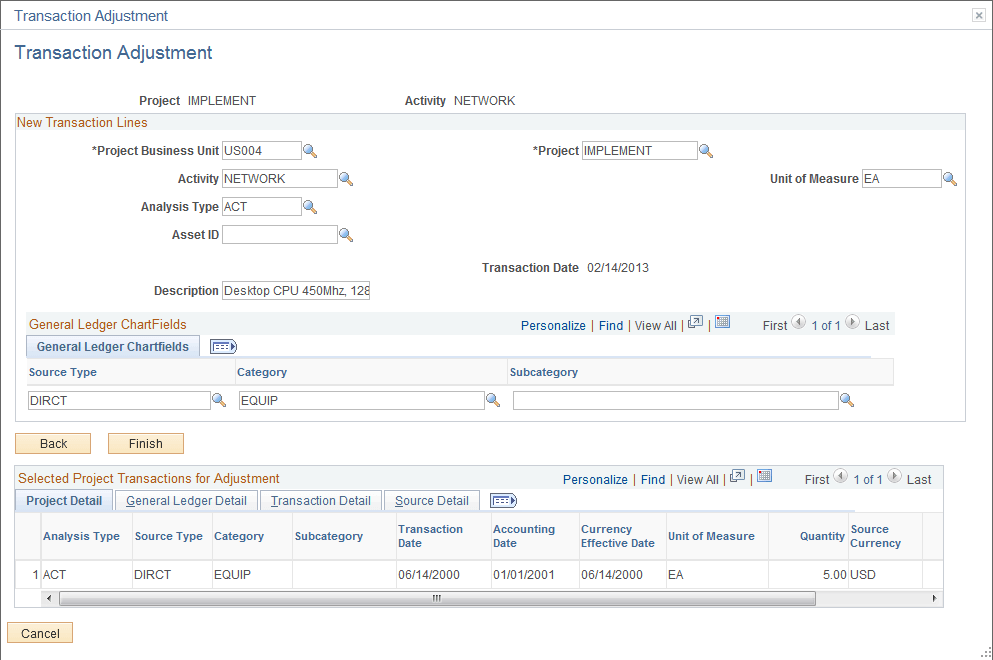

Use the Transaction Adjustment page (PROJ_RES_ADJ_NEWCF) to select ChartFields for the new transaction row that is created during the adjustment process.
Navigation:
Click the Next button on the Choose type of adjustment page if you are adjusting project-related ChartFields.
This example illustrates the fields and controls on the Transaction Adjustment page: Entering adjustments. You can find definitions for the fields and controls later on this page.
Project managers use this page to enter project-related ChartField values for the new transaction lines that are created when the transaction is adjusted.
If you are adjusting a single transaction, this page appears showing the ChartField values in the New Transaction Lines scroll area from the original transaction. Enter new values as required in the New Transaction Lines scroll area. Remove values to leave fields empty in the new transaction.
If you are adjusting multiple transactions, this page appears showing only the project business unit, project, activity, and other default values in the New Transaction Lines scroll area. Values that you enter in the New Transaction Lines scroll area apply to all transactions that appear in the Selected Project Transactions for Adjustment grid. Fields that you do not change on this page (fields that you leave blank) retain their original values in the adjusted transactions.
Note: To delete a ChartField value and leave the field empty on transaction rows, you must use the Transaction Adjustment page for a single transaction. For example, assume that the original transaction has a department value of 123 and product value of 789, and you want to change the department to A64 with no product value. You must select only this transaction to adjust, which enables you to delete the product value in the New Transaction Lines scroll area.

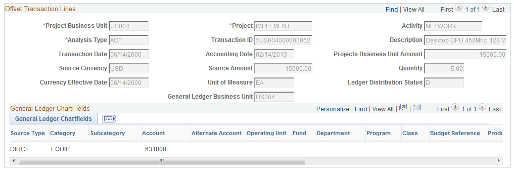

This example illustrates the fields and controls on the Transaction Adjustment page: Original Transaction Lines group box. You can find definitions for the fields and controls later on this page.
This example illustrates the fields and controls on the Transaction Adjustment page: Offset Transaction Lines group box. You can find definitions for the fields and controls later on this page.
This example illustrates the fields and controls on the Transaction Adjustment page: New Transaction Lines group box. You can find definitions for the fields and controls later on this page.
Review the ChartField values for the original, offset, and new transaction lines that result when the adjustment occurs.
