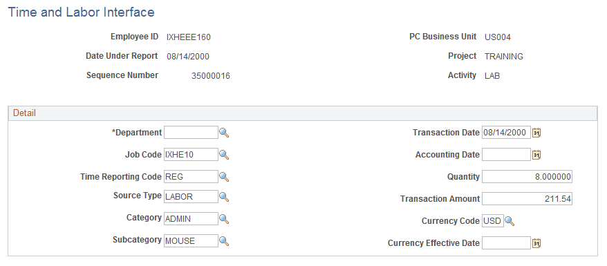

Use the Time and Labor Interface page (INTFC_PROJ_TL_01) to review data that is moved from the HCM database to the Project Time and Labor Interface staging tables in the Financials database before it is loaded into the Project Transaction table.
Navigation:
This example illustrates the fields and controls on the Time and Labor Interface page. You can find definitions for the fields and controls later on this page.
Make any necessary adjustments to transactions brought over from PeopleSoft Time and Labor before moving them to the Project Transaction table.
Field or Control |
Description |
Department |
Department ID from PeopleSoft Time and Labor. |
Transaction Date |
Date for which work was reported in PeopleSoft Time and Labor. |
Accounting Date |
Pay period ending date. |
Time Reporting Code |
Element of compensation or group of several elements in which the system collects labor data, hours, amounts, or units worked. |
Quantity |
Number of hours worked. This field is blank if it is not applicable based on your PeopleSoft Time and Labor setup. |
Transaction Currency |
Currency in which the labor transaction is reported. This value is maintained in the Foreign Currency field. |
Transaction Amount |
Transaction amount that reflects estimated or actual labor cost. When actual cost processing occurs, the multicurrency engine converts this amount to the project business unit amount based on the project business unit's base currency. |

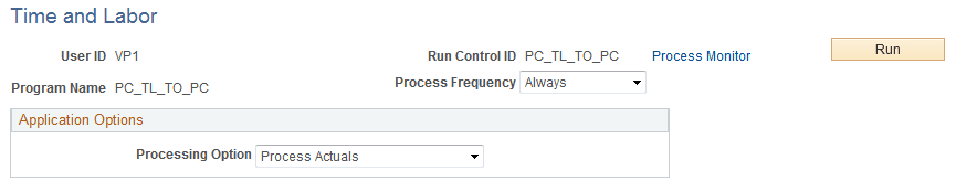

Use the Time and Labor page (PC_TL_TO_PC) to run the Time and Labor to Project Costing Application Engine process (PC_TL_TO_PC) that moves time and labor data from the Project Time and Labor Interface staging tables into the Project Transaction table.
Navigation:
This example illustrates the fields and controls on the Time and Labor page. You can find definitions for the fields and controls later on this page.
Use this page to select the processing option, and click Run to initiate the Time and Labor to Project Costing process.
Field or Control |
Description |
Load time from flat file |
Select to import time data from a flat file. If selected, the Flat File group box appears. Select Estimates to load data from the flat file into the Project Time and Labor Interface estimates staging table (INTFC_PROJ_EST). Select Actuals to load data from the flat file into the Project Time and Labor Interface actuals staging table (INTFC_PROJ_ACT). Enter the flat file name and its directory path in the File Name field. |
Process Actuals |
Select to process all actuals. This option moves PeopleSoft Time and Labor data from the Project Time and Labor Interface actuals staging table into the Project Transaction table. |
Request Estimates |
Select to request all estimates data to be sent from the Project Time and Labor Interface estimates staging table into the Project Transaction table. |
Note: Labor amounts that differ from the business unit currency are converted during the integration process if the appropriate exchange rates are set up.
