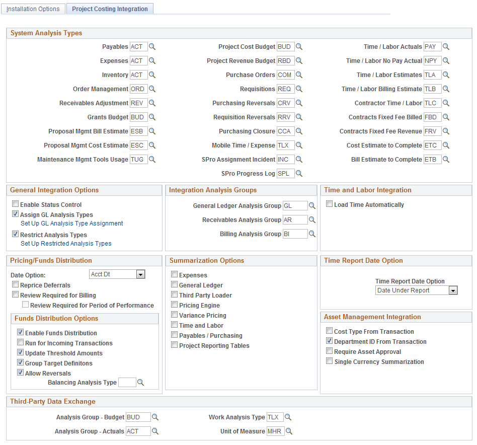

Use the Installation Options - Project Costing Integration page (INSTALLATION_PCINT) to select analysis types for transactions from PeopleSoft Time and Labor.
Navigation:
This example illustrates the fields and controls on the Project Costing Integration page. You can find definitions for the fields and controls later on this page.
Default analysis types for each inbound integration point are delivered with the PeopleSoft Project Costing system and specified on this page. You can override the default analysis types.
These are the default analysis types that are delivered for integration with PeopleSoft Time and Labor:

General Integration Options
Field or Control |
Description |
Enable Status Control |
Select to enable status control functionality, which enables you to control transactions based on analysis types and effective dates. By using status control options, you can stop transactions from a feeder application if a project or activity status changes on the project Status page or activity Status page. The default value is deselected. |
Assign GL Analysis Types |
Select check box to auto-assign General Ledger Analysis Types on the Journal Entry page. |
Set Up GL Analysis Type Assignment |
Click to access the Assign General Ledger Analysis Types page where you can define the assignment rules. |
Restrict Analysis Types |
Select check box to restrict particular analysis types to allowable account types. |
Set Up Restricted Analysis Types |
Click to access the Restrict Analysis Types page where you can define permissible account types for the restricted analysis types. |

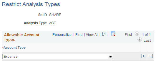

Use this page to define the allowable Account Types that can be used when entering transactions from systems that feed into Project Costing for a restricted Analysis Type.
This example illustrates the fields and controls on the Restrict Analysis Types page. You can find definitions for the fields and controls later on this page.
Field or Control |
Description |
SetID |
Displays the SetID of the restricted analysis type, which is controlled by PC Business Unit field. |
Analysis Type |
Displays the analysis type that is restricted. |
Account Type |
Select the account type(s) that is(are) allowable for the restricted analysis type. The account type values are dependent on the definition of Account Types when accounts are set up. |
Note: The Assign GL Analysis Types and Restrict Analysis Types functionalities are applicable only for online transactions and not for batch transactions entered through Project Costing or third party applications.
