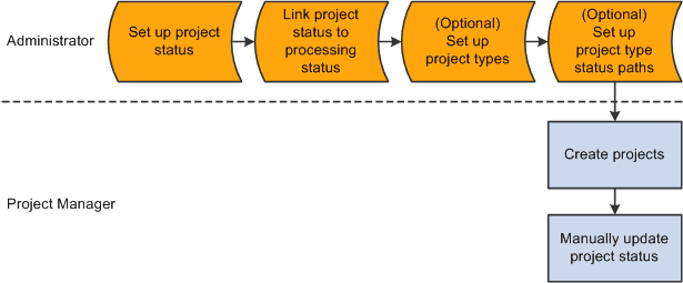

Process Flow
This diagram shows the process flow to set up project and processing statuses and to update a project status:
The diagram illustrates that an administrator sets up project statuses, links the project status to a processing status, optionally sets up project types, and optionally sets up project type status paths. Then a project manager creates projects and manually updates the project status.
After you update the project status, the system:
Determines if the corresponding processing status is a valid change based on the previous processing status.
The processing status:
Can change from Active to Active.
Can change from Active to Inactive.
Can change from Inactive to Inactive.
Can change from Inactive to Active.
Can change from Pending to Pending.
Can change from Pending to Active.
Can change from Pending to Inactive.
Can not change from Active to Pending.
Can not change from Inactive to Pending.
Determines if the project status effective date is current or future-dated.
An Application Engine process monitors project status effective dates and updates the processing status as necessary.
Determines if a processing status change is valid.
If the change is not valid, an error message appears.
Determines if a project type status map exists for the project type.
If a project type status map exists, the system determines if the project status change is valid based on the project type status path for that project type.
Determines if a project event is defined for this project status change.
If a project event is defined, the system triggers approval workflow.
Updates project status and processing status.
