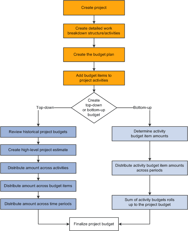

Project Costing supports top-down project budgeting, bottom-up project budgeting, and the ability to adjust existing project budgets.
This diagram shows the bottom-up and top-down project budgeting process flow in Project Costing:
You can simplify the process of creating budgets by using project templates. For example, you can create a project template that contains the detailed work breakdown structure, budget plan, and budget items that are associated with the project activities. Use the template to populate new projects with the preset budget information. You can modify the project template, or create multiple templates to meet your business needs.
The main steps to create budgets from the top down are:
Enter a high-level estimate for the project on the Budget Plan page.
Use this page to enter budget scenarios for the project. Budget plans provides a high level definition of the total budget for each project budget under consideration.
(Optional) Distribute the estimate down to summary activities on the Budget Detail page.
Distribute the estimate down the WBS to costing activities on the Budget Detail page.
Use this page to define a specified project budget at a greater level of detail by using budget items.
Adjust budget amounts for budget items on the Project Budget Items - Adjust Budget Items page.
Use this page to spread the budget amounts to budget items on costing activities.
Distribute the estimate across periods on the Project Budget Periods - Adjust Budget Periods page.
Return to this page to distribute the budget item budget adjustment across budget periods.
Choose one cost and one revenue budget plan and finalize the plans.
Finalizing a budget plan sends the budget data to the Project Transaction Interface staging table (INTFC_PROJ_RES) and initiates a process to determine if the budget transactions go directly to the Project Transaction table (PROJ_RESOURCE). If Commitment Control is active for Project Costing and the GL business unit and ledger group combination, the rows must first go through Commitment Control.
You can finalize only active plans.
