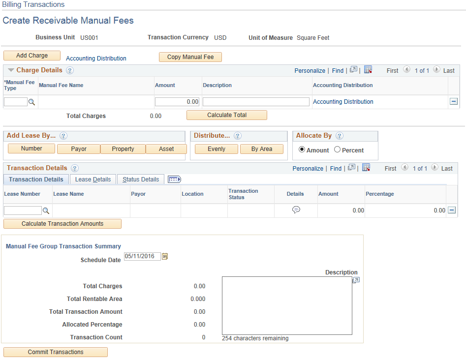

Use the Billing Transactions - Create Receivable Manual Fees page (RE_MFT_MAIN) to add manual fees, distribute them amongst leases, and create multiple transactions from a single invoice.
Navigation:
Lease Administration, Receivables Leases, Create Manual Receivables, Billing Transactions - Create Receivable Manual Fees
Lease Administration, Receivables Leases, Processing Invoices, Billing Transactions
Click the Create Receivable Manual Fees button.
This example illustrates the fields and controls on the Billing Transactions - Create Receivable Manual Transaction page. You can find definitions for the fields and controls later on this page.
When you first create manual fee transactions, the page name is Create Receivable Manual Fees page. After you save an exit the page, to access the information again, you access the Maintain Receivable Manual Transaction page. The pages function similarly. The status of the transactions control what you can edit on the page:
If all of the transactions on this page are in Draft status, you can edit the entire page.
If one or more of the transactions on this page are in Draft status, you can edit or delete the individual transactions or add new transactions.
If all of the transactions on this page are in Pending, Processed, or Error, the page is display-only.
Field or Control |
Description |
Add Charge |
Click to add a new manual fee. The system adds a row to the Charge Details grid. |
Accounting Distribution |
Click this link to access the Accounting Distribution page and to override business unit defaults for the accounting distributions. |
Manual Fee Name |
Enter the manual fee name. The available manual fees are based on the active manual fee types. |
Amount |
Enter the amount of the manual fee that you want to distribute between leases. You can enter positive or negative amounts, but the amounts that you enter must either be all positive or all negative. If you want to issue a charge and a credit for the same group of transactions, you must enter them on two different worksheets. |
Description |
Enter the description of the manual fee. This field is only for informational purposes. |
Calculate Total |
Click to calculate the total amount of manual fees. The system adds the values in the Amount field and populates the Total Charges field with the total amount. |
Add Lease By
Field or Control |
Description |
Number |
Click to insert a new empty row into the Transaction Details grid. You can click the Look up Lease Key icon in the Lease Number column to search for a lease. |
Payor |
Click to transfer to the Maintain Receivable Manual Transaction - Lease Search by Payor page on which you can search for leases by payors and select the leases to add to the Transaction Details grid. |
Property |
Click to transfer to the Manual Fees - Leased Property Search page on which you can search for leases by properties and select the leases to add to the Transaction Details grid. |
Asset |
Click to transfer to the Manual Fees - Leased Asset Search page on which you can search for assets and select the assets to add to the Transaction Details grid. |
Distribute
Field or Control |
Description |
Evenly |
Click to distribute the total charges evenly between the leases in the Transaction Details grid. |
By Area |
Click to distribute the total charges based on the proportional amount of rentable area by each lease in relation to the total area of all leases in the Transaction Details grid. |
Allocate By
Field or Control |
Description |
Amount |
Select to use the Amount field to calculate the charges allocated to the lease transactions. |
Percent |
Select to use the Percent field to calculate the charges allocated to lease transactions. |
Transaction Details
Field or Control |
Description |
Lease Number |
Enter the lease to which the transaction will be allocated. You can select from leases that are in Active, Holdover, or Expired status. |
Click the Details icon for a lease to access the Receivable Manual Fee - Transaction Details on which you can view a summary of the transaction details for that lease. |
Payor |
Enter the entity whom is responsible to pay the charges. The system uses the tenant as the default. You can override this value. |
Transaction Status |
Displays the transaction status. The system initially creates each transaction with a status of Draft. After you commit the transactions, the system sets the status to Pending. |
Amount |
Enter the total amount of charges to allocate to this transaction. The sum of all the amounts that you enter must equal the total charges from the Charge Details amounts. You can enter positive or negative amounts, but the amounts that you enter must either be all positive or all negative. If you want to issue a charge and a credit for the same group of transactions, you must enter them on two different worksheets. |
Percentage |
Enter the percentage of the charges to allocate to this transaction. The sum of all of the percentages that you enter must equal 100. |
Rentable Area |
Displays the total rentable area of the lease associated with the transaction. |
Revision History |
Click to access the Receivable Manual Fee Transaction - Action History - Historic Details page to review the transaction history for a specific lease. |
Calculate Transaction Amounts |
Click to update the values in the Manual Fee Group Transaction Summary group box. |
Field or Control |
Description |
Schedule Date |
Enter the date on which you want to schedule the transactions for invoicing. |
Total Charges |
Displays the total amount to be allocated. This field is the same as the Total Charges field near the top of the page. |
Total Rentable Area |
Displays the total rentable area for the leases associated with these transactions. The systems sums all of the values from the Rentable Area column in the Transaction Details grid. |
Total Transaction Amount |
Displays the total amount of charges that you have allocated. The systems sums all of the values from the Amount column in the Transaction Details grid. This value must equal the value in the Total Charges field before you can commit the transactions. |
Allocated Percentage |
Displays the total percentage of charges that you have allocated. The systems sums all of the values from the Percentage column in the Transaction Details grid. This value must equal 100.00 before you can commit the transactions. |
Transaction Count |
Displays the number of transactions from the Transaction Details grid. |
Commit Transactions |
Click to process the transactions. The system validates the transactions, sets the transactions statuses to Pending and sends them to the transaction queue. The page becomes display-only. |

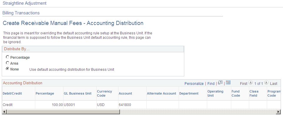

Use the Accounting Distributions page (RE_MFTCHG_DST_SEC) to override the accounting distributions defined at the business unit level.
Navigation:
Click the Accounting Distributions link on the Refund Security Deposit - Create Receivable Manual Transaction page.
This example illustrates the fields and controls on the Create Receivable Manual Fees - Accounting Distributions page. You can find definitions for the fields and controls later on this page.
The fields on this page differ depending upon the distribution selected. When you select a value other than None, the ChartField values become available for edit.
Field or Control |
Description |
Distribute By |
Select either:
Add Distribution |
This button appears if you select Percentage or Area for the distribute by value. Click this button to insert a new distribution row. |
Delete Distribution |
This button appears if you select Percentage or Area for the distribute by value. Select a row and click this button to delete it from this page. |
Select |
This option appears if you select Percentageor Area for the distribute by value. This option is used to delete the distribution rows. Users can select all the distribution rows that they want to delete and click the Delete Distribution button to delete them. |
Percentage |
This field appears if you select Percentagefor the distribute by value. Enter a percentage amount for this distribution line. Percentage amounts must equal 100% to be valid. |
Area |
This field appears if you select Areafor the distribute by value. Enter the area for this distribution line. All lines must add up to the total rentable area for the lease to be valid. |
Valid |
Used to indicate a valid combination of chartfields. When activating the lease, edit checking will be provided and the option will be selected for each row representing a valid combination of chartfields. A lease cannot be activated until every accounting distribution is marked as valid. |
