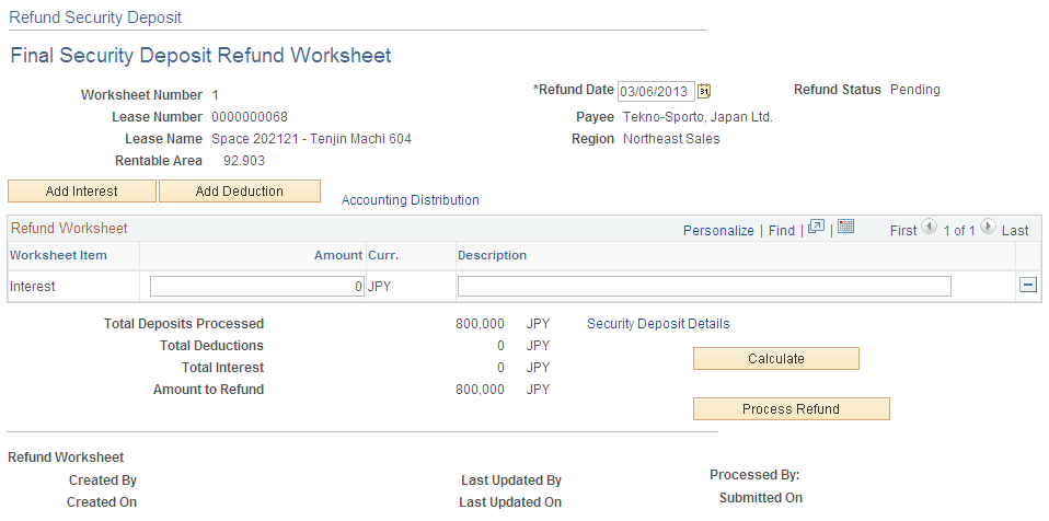

Use the Refund Security Deposit - Final Security Deposit Refund Worksheet page (RE_REFUND) to process a security deposit refund.
Navigation:
This example illustrates the fields and controls on the Refund Security Deposit - Final Security Deposit Refund Worksheet page. You can find definitions for the fields and controls later on this page.

Refund Worksheet
When you click the Add Interest or Add Deduction button, the system inserts a new row in the refund worksheet.
Field or Control |
Description |
Worksheet Item |
Displays Interest or Deductions, depending on whether you select the Add Interest or Add Deduction option. |
Total Deposits Processed |
Displays the total deposits that were processed from the Security Deposits page. The system totals all of the processed deposit amounts to calculate this value. When the refund worksheet is in a processed state, the system retains the value in the worksheet and does not recalculate it. |
Total Deductions |
Displays the total deductions that were added to the refund worksheet. |
Total Interest |
Displays the total interest that was added to the refund worksheet. |
Amount to Refund |
Displays the amount to refund or collect. The system calculates the final refund on a worksheet that is processed back to the payee. The refund can be negative or positive, which means that the tenant might owe the landlord additional funds or the landlord might refund the deposit back to the tenant. If the refund amount is positive, then the system sends the transaction to PeopleSoft Payables. If the refund amount is negative, the system creates a billing transaction to bill additional funds to the tenant. |
Security Deposit Details |
Click the link to view the security deposit log on the Security Deposits page. |
Calculate |
Click to calculate the amount of security deposit refund. Because the security deposit refund page uses a worksheet model for processing, you can click the Calculate button as many times as needed to create what-if scenarios. The system calculates the amount to be refunded as (Total Deposits Processed + Total Interest − Total Deductions). Note: Calculation is automatically performed when the worksheet is saved. |
Process Refund |
Click to send the refund request to the transaction queue for PeopleSoft Payables processing. If the deductions are greater than the security deposit amount, the system sends a request to the transaction queue for PeopleSoft Billing to send an invoice to the tenant for additional fees. The details are sent to PeopleSoft Billing even if the refund amount is zero. After a refund worksheet is processed, the refund status is changed to Processed and the worksheet becomes read-only. When there is a pending refund transaction in the transaction queue, another refund cannot be processed. |
