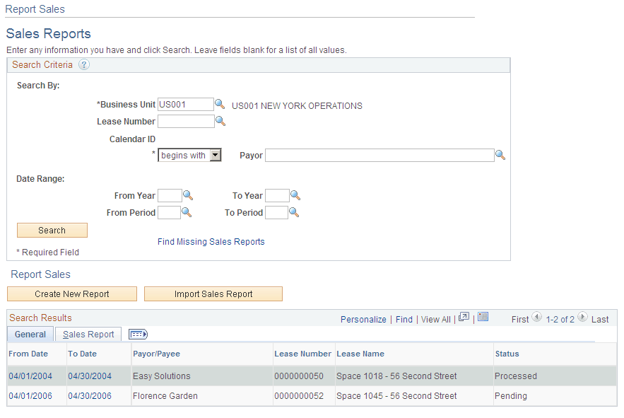

Use the Report Sales - Sales Reports page (RE_SLSRPT_SRCH) to search for all available sales reports.
Create a new sales report and import sales data.
Navigation:
This example illustrates the fields and controls on the Report Sales - Sales Reports page. You can find definitions for the fields and controls later on this page.
Filter search results by entering specific values in the fields in the Search Criteria group box. You must enter the business unit. If you enter only a business unit, the search returns all sales reports for all leases within that business unit.
Field or Control |
Description |
Calendar ID |
Displays the percent rent calendar ID from the lease that you enter in the Lease Number field. The calendar provides a set structure to the periods and facilitates the system's ability to search for missing sales reports. The calendar provides the start and end dates of each period so that the system can keep track of sales reports and assist with locating missing sales. |
From Year |
Select the year to define the start of the date range for the search criteria. |
To Year |
Select the year to define the end of the date range for the search criteria. |
From Period |
Enter the starting period to be included in the search criteria. The periods match the dates created for this detail calendar. |
To Period |
Select the last period to be included the search criteria. The periods match the dates created for this detail calendar. |
Find Missing Sales Reports |
Click to access the Report Sales - Find Missing Sales Reports page on which you can enter criteria to search for missing sales reports. |
Create New Report |
Click to create a new sales report. |
Import Sales Report |
Click to import reported sales data reported from a CSV file. |

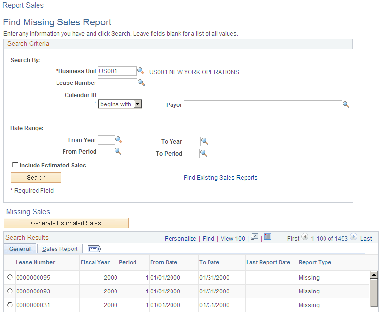

Use the Report Sales - Find Missing Sales Reports page (RE_MISSING_SLS) to find missing sales reports.
Navigation:
Click the Find Missing Sales Reports link on the Sales Reports page.
This example illustrates the fields and controls on the Report Sales - Find Missing Sales Reports page. You can find definitions for the fields and controls later on this page.
The system displays all of the missing sales reports based on the search criteria that you enter, regardless of lease status.
Field or Control |
Description |
Include Estimated Sales |
Select to include estimated sales reports in the search results for missing sales reports. Normally, searching for missing sales reports only searches for periods that have no data; selecting this box handles any estimated sales reports as missing sales because the tenant did not provide the data. |
Find Existing Sales Reports |
Select to return to the Report Sales - Sales Reports page to search for existing sales reports. |
Generate Estimated Sales |
Click to generate a new estimated sales report for the selected lease. Estimates are based on the calculation method defined at the business unit level, such as Past 6 Period Average. |
Last Report Date |
Displays the last date entered for a sales report for this lease. |
Report Type |
Displays the report type, either Missing or Estimated. |

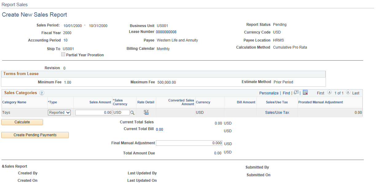

Use the Report Sales - Create New Sales Reports page (RE_SLSRPT_INV ) to create new sales reports.
Navigation:
Click the Create New Sales Reports button on the Report Sales - Sales Reports page.
This example illustrates the fields and controls on the Report Sales – Create New Sales Report page. You can find definitions for the fields and controls later on this page.
Field or Control |
Description |
Sales Period |
Displays the date range for this sales report. |
Fiscal Year |
Displays the year to which this accounting period refers. |
Accounting Period |
Displays the accounting period for this sales report. |
Billing Calendar |
Displays the billing calendar for this sales report. |
Lease Number |
Click to access the Financial Terms - Percent Rent Details page on which you can view the breakpoints for this lease. |
Payee |
Displays the entity to whom you make payments. This field appears only for payables leases. |
Payor |
Displays the entity that is responsible for making payments. This field appears only for receivables leases. |
Calculation Method |
Displays the calculation method selected on the Financial Terms – Percent Rent page. |
Partial Year Proration |
This option is selected if you selected partial year proration on the Financial Terms – Percent Rent page. |
Revision |
Displays the latest revision number. Shows the number of adjustments for this period. |
Type |
Select the type of sales reporting figures being entered. You can change the type with an amendment if more accurate numbers are determined. The type enables you to classify the sales report by the values defined. The system delivers four values that you can use interchangeably. You can use any combination of these values: Estimated: The estimated figure is either generated by the system or entered on behalf of tenant estimates. When the system generates a sales estimate, this value is automatically defaulted on the estimated row. Reported: The figure is reported by tenant, but with possibly no documentation. Actual: The tenant provides documentation of the actual figures. Audited: The tenant provided an audited report or the landlord sent an auditor in to audit the figures. Note: If you change the type from Estimated to any of the other values, you cannot change it back to Estimated. |
Sales Amount |
Enter the sales amount based on the type that you select for the Type field. |
Click the Exchange Rate Detail icon to access the View Exchange Rate Detail page on which you can view the details of the exchange rate that the system used to calculate the converted sales amount. |
Converted Sales Amount |
Displays the sales amount converted back to the base currency of the lease. |
Sales/Use Tax |
Click this link to access the Sales/Use Tax Information page. For additional information on Sales/Use Tax Information page, refer Defining Lease Financial Terms |
VAT |
Click this link to access the VAT Information page. This field appears only for VAT enabled business units. For additional information on VAT Information page, refer Defining Lease Financial Terms |
Prorated Manual Adjustment |
Displays the final manual adjustment value prorated for each sales category lines. |
Calculate |
Click to calculate the bill amount based on the converted sales amount and the breakpoint using percent, amount, or both. You can enter different sales amounts to calculate and recalculate the billing amount until the calculated bill amounts are acceptable to you. |
Current Total Sales |
Displays the amount to be billed or the amount to be paid depending on the type of lease that you are using. The system calculates the amount from the percent rent terms. |
Current Total Bill |
Click this link to access the Sales Calculation Log page. Note: This value appears as display only for the category based method and the lease prorata method. |
Final Manual Adjustment |
Enter the amount for the final manual adjustments. You can edit the amount when the report status is in pending state and negative values are accepted. |
Create Pending Invoice or Create Pending Payment |
Click to calculate the rent and submit the bill amount to the transaction queue for approval. The system changes the status from Pending to Processed. If the transaction is rejected in the billing transaction queue, the status of the sales report changes from Processed back to Pending. This is available only when the reporting and billing calendars are same. When they are different, the invoice or payment is created using the Process Sales Reports process. |

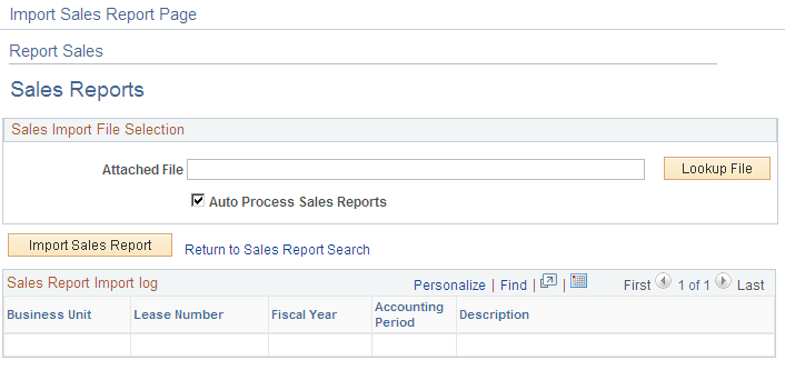

Use the Sales Reports - Sales Report (import) page (RE_IMPORT_SLS) to create sales reports by importing data from a CSV file.
Navigation:
Click the Import Sales Report button on the Report Sales - Sales Reports page.
This example illustrates the fields and controls on the Report Sales - Sales Report (import) page. You can find definitions for the fields and controls later on this page.
Field or Control |
Description |
Attached File |
Displays the name of the file that you uploaded. |
Lookup File |
Browse through your files to locate the percent sales report and upload it to the FTP server. |
Auto Process Sales Reports |
Select this check box to enable the system to automatically calculate percent rent amounts and create transactions for the imported rows. |
Click to import the values of the uploaded file into a sales report. |
